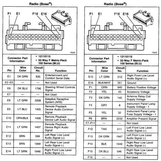

Do you know if there is an antenna plug or is it in the harness built in?
Oct 14, 2019 at 6:40 AM
PCULQUI
  • 354 POSTS
The first file shows the relay in the factory harness. Would this be the antenna connection? My aftermarket radio harness has a built-in wire in the harness. The second picture is the entire factory harness with wiring description.
Oct 14, 2019 at 6:46 AM
DANNY L
  • 5,648 POSTS
Hello again.
Yes, you would use your factory harness dark green wire to be connected to the antenna power wire on your new/aftermarket radio. Hope this helps and thanks again for using 2CarPros.
