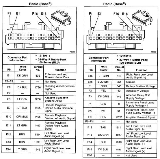

Do you know if there is an antenna plug or is it in the harness built in?
Monday, October 14th, 2019 AT 1:40 PM
PCULQUI
  • 354 POSTS
The first file shows the relay in the factory harness. Would this be the antenna connection? My aftermarket radio harness has a built-in wire in the harness. The second picture is the entire factory harness with wiring description.
Monday, October 14th, 2019 AT 1:46 PM
DANNY L
  • 5,648 POSTS
Hello again.
Yes, you would use your factory harness dark green wire to be connected to the antenna power wire on your new/aftermarket radio. Hope this helps and thanks again for using 2CarPros.

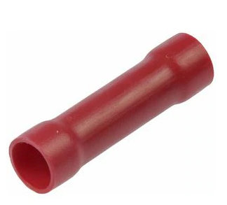

How about the butt connectors? They come in different gauges. How do I know the gauge in my factory harness wires and aftermarket radio?
Monday, October 14th, 2019 AT 7:31 PM
DANNY L
  • 5,648 POSTS
Hello again.
It would be best to use the red 8 gauge butt connectors. See picture below. Hope this helps and thanks again for using 2CarPros.
Danny-
Monday, October 14th, 2019 AT 10:09 PM

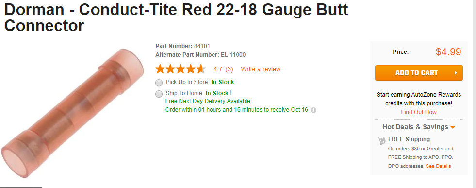

How about the 16 AWG connectors, are they too thin?
Tuesday, October 15th, 2019 AT 7:16 AM
DANNY L
  • 5,648 POSTS
Hello again.
Sorry, I forgot a numeral on your post. 18 gauge is the correct number. The higher number gauge for thickness in wiring is a smaller size wire. I've attached an updated picture for you. With your aftermarket stereo to be incorporated with your factory wiring harness it is recommended to use the red 18-22 gauge connectors. Hope this helps and thanks again for using 2CarPros.
