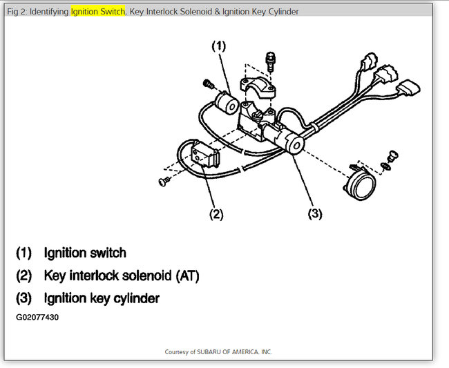

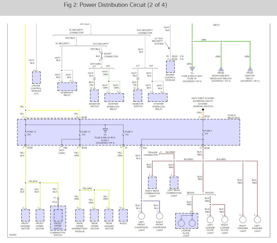

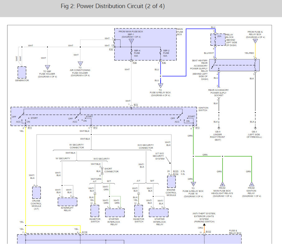

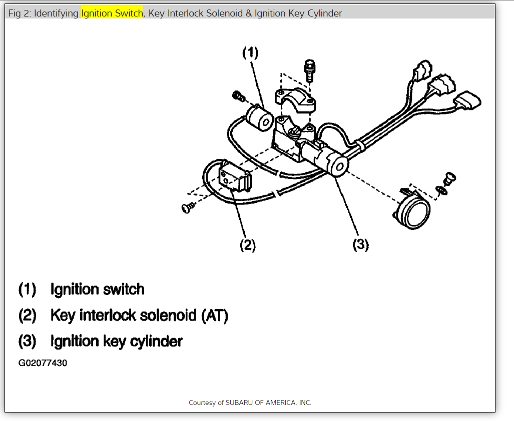

When I start the car it may take a while for the radio and wipers to work, sometimes a long while. What could be the problem?
Nov 29, 2018 at 8:11 AM
  • 54,832 POSTS
It sounds like the ignition switch is going bad. To be sure here is a guide and the wiring diagrams to help us confirm the fault:
Check the yellow wire for power with the key on. Check out the diagrams (below). Please let us know what you find. We are interested to see what it is.
