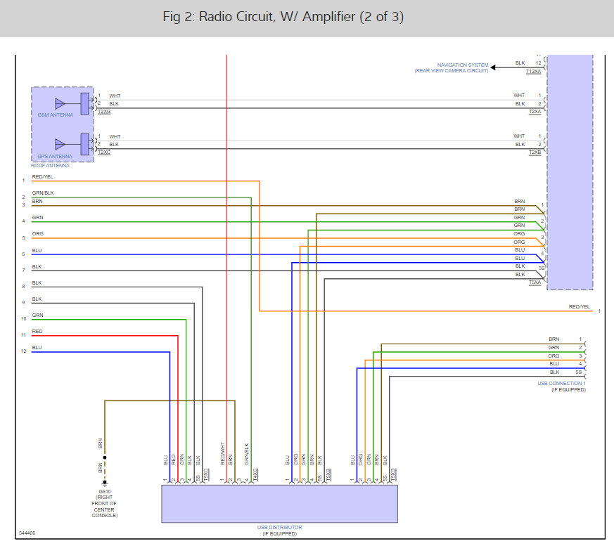

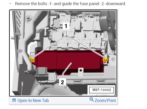

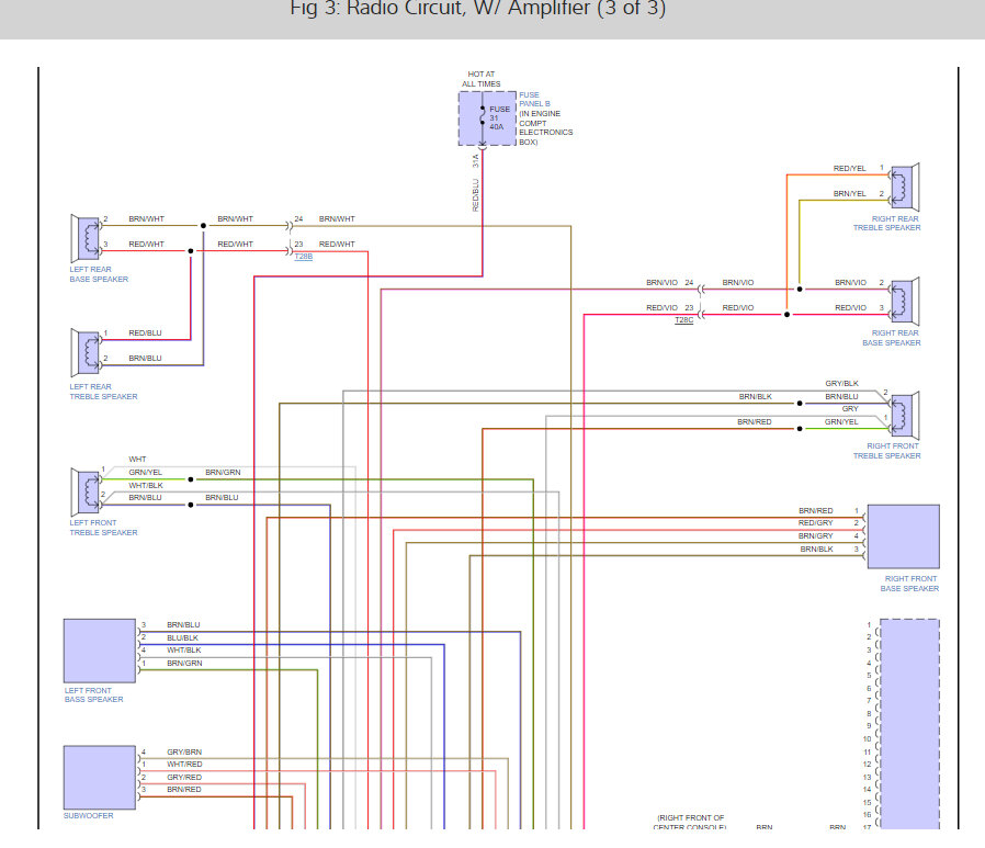

My radio doesn’t work, I can’t hear music, just a black screen, it turns on and off to the welcome screen but that’s it. Do you think it could be a blown fuse and if it is which fuse is it? Thanks
Jun 12, 2023 at 7:23 AM
  • 55,433 POSTS

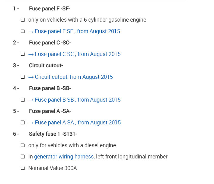

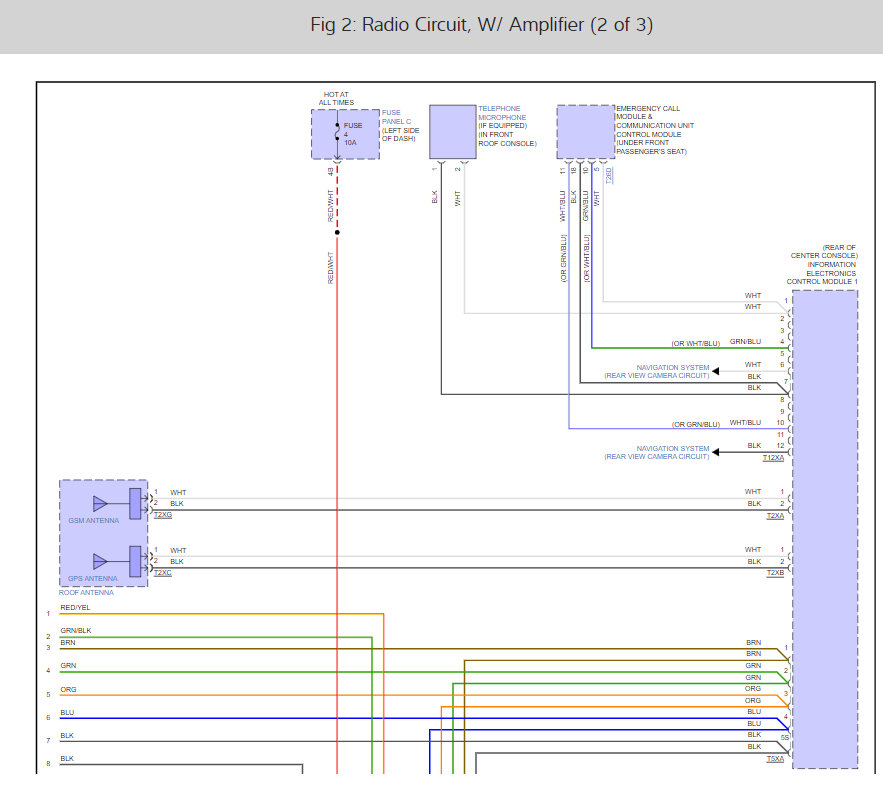

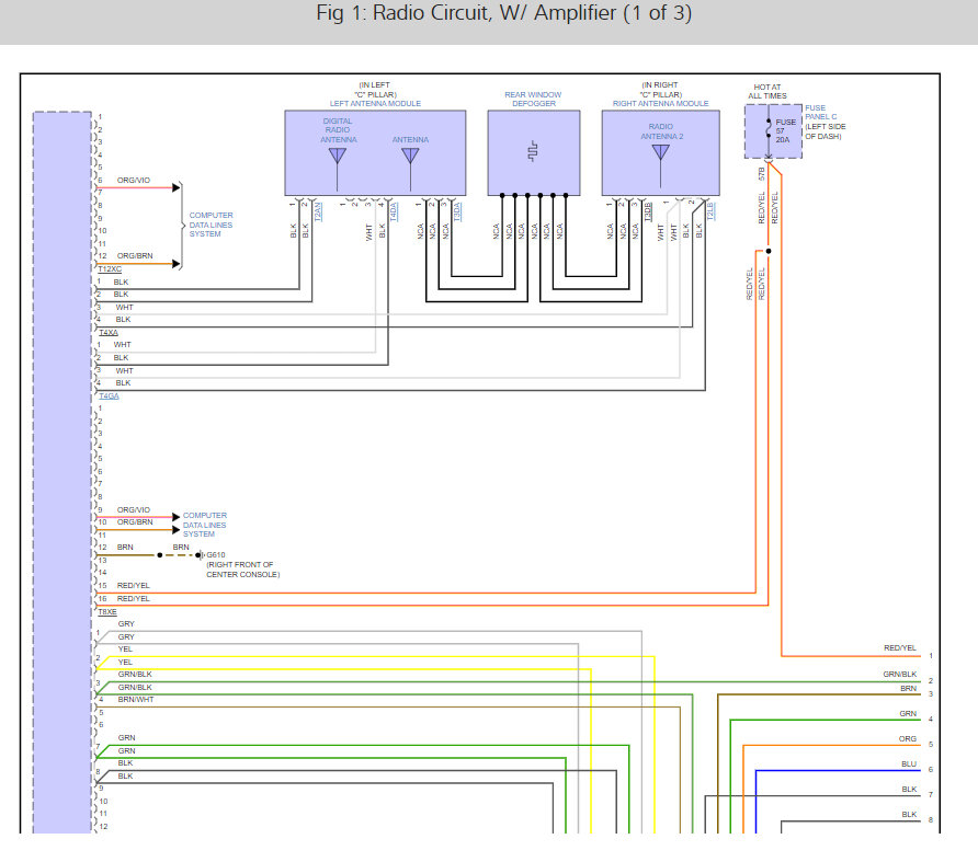

Yes, I would check the fuses #4 and #57 in the fuse panel C which is on the left side of the dash and fuse #31 in the fuse panel B which is under the hood.
Here is a guide to help:

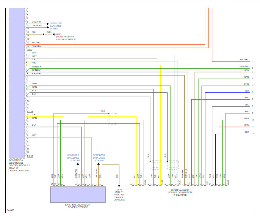

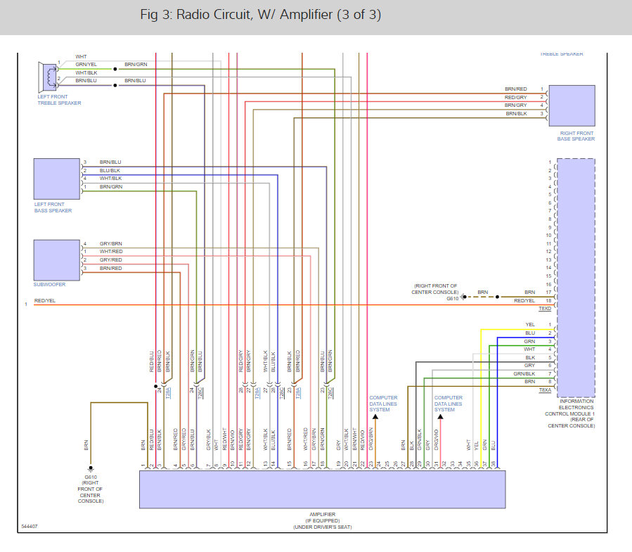

Check out the images (below). Please let us know what happens. Here are the radio wiring diagrams so you can see how the system works.
