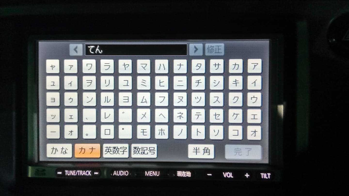

I have a problem. After changing car battery, it is appear Anti theft lock.

My problem is radio and navigation system anti theft lock.
Only car radio and TV was not work.
There is no alarm and no other problem.
I can drive anywhere.
Everything is okay expect TV, DVD and navigation.

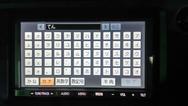

Japanese words appear, and it can touch characters (eng/jap) and numbers for typing anti theft code.

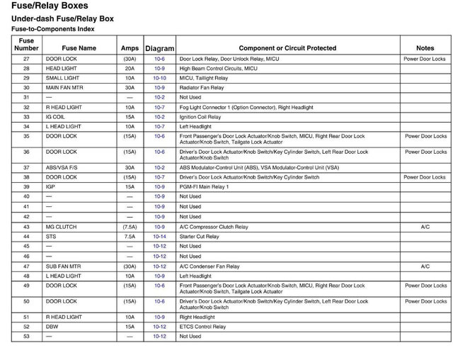

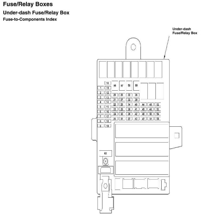

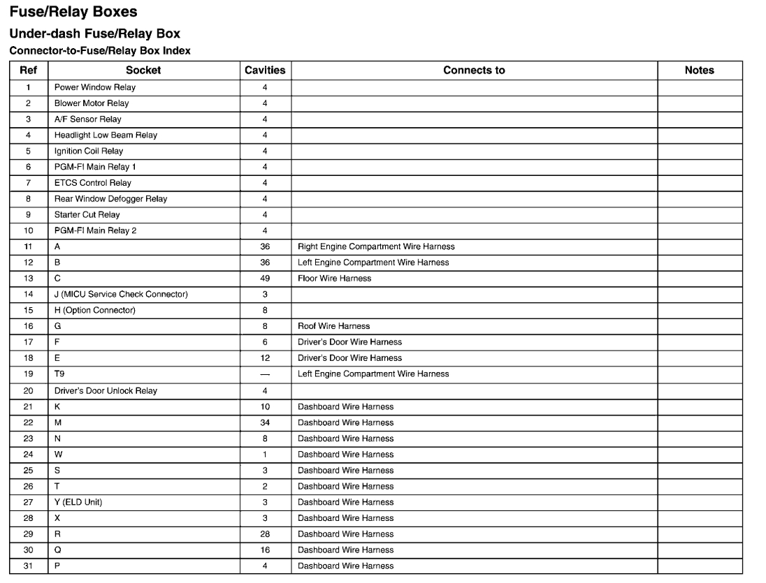

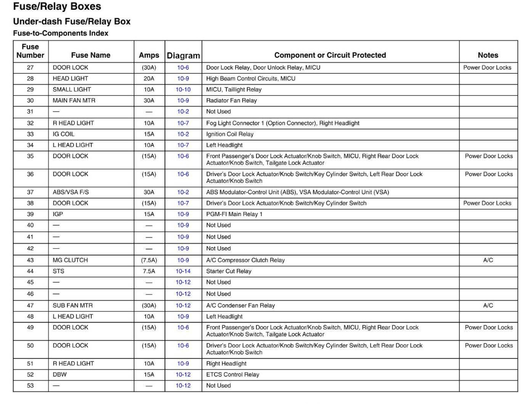

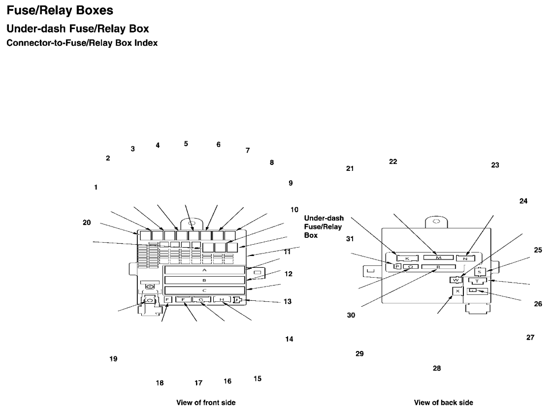

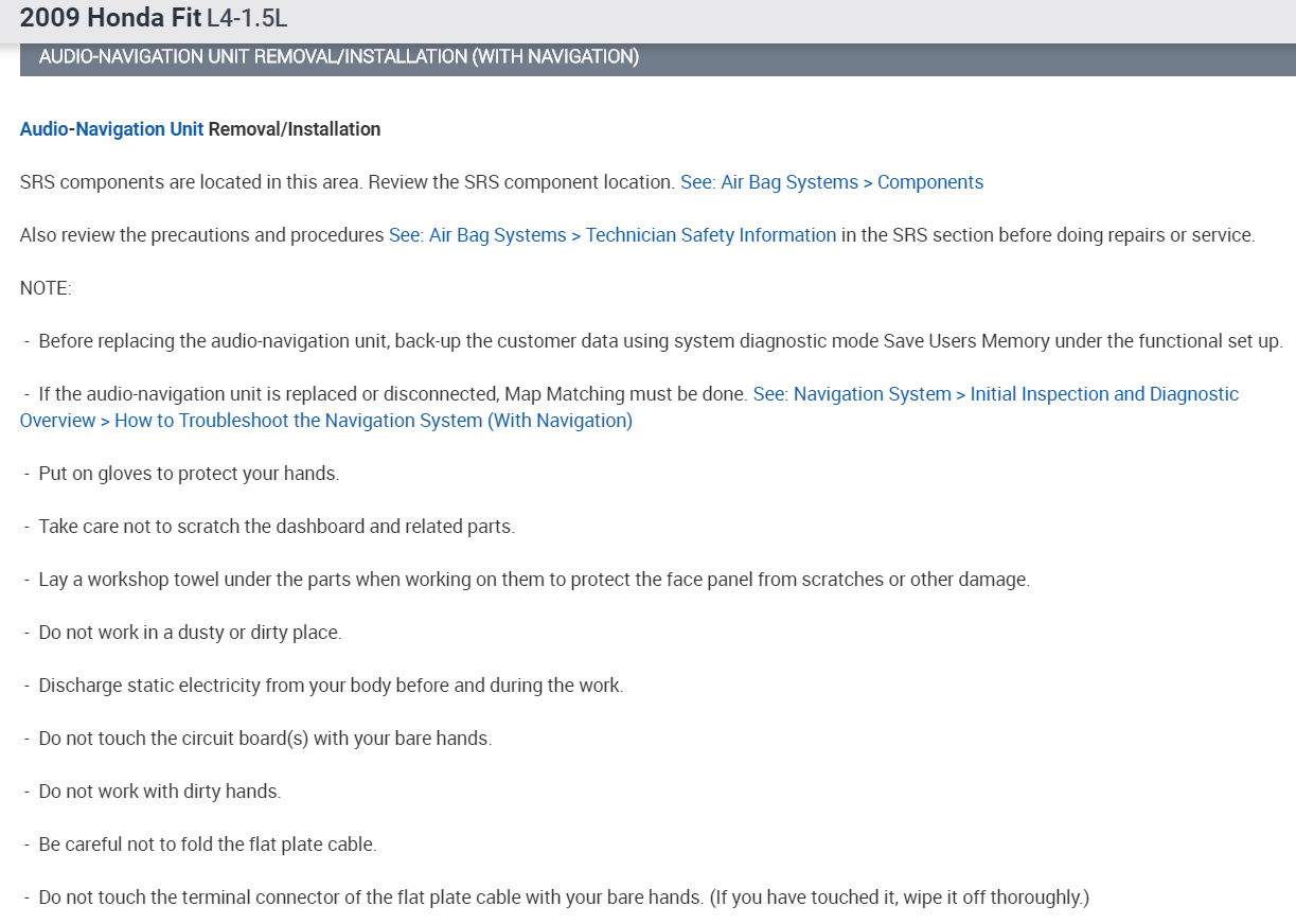

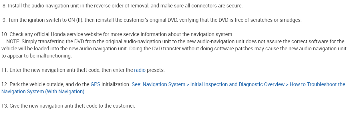

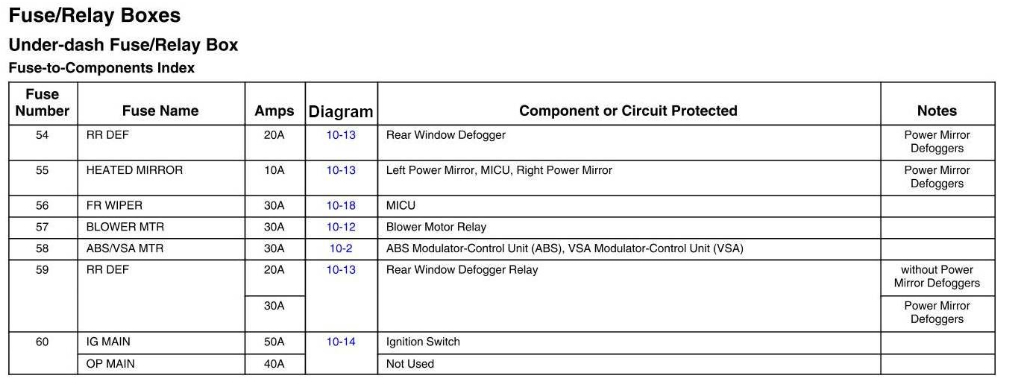

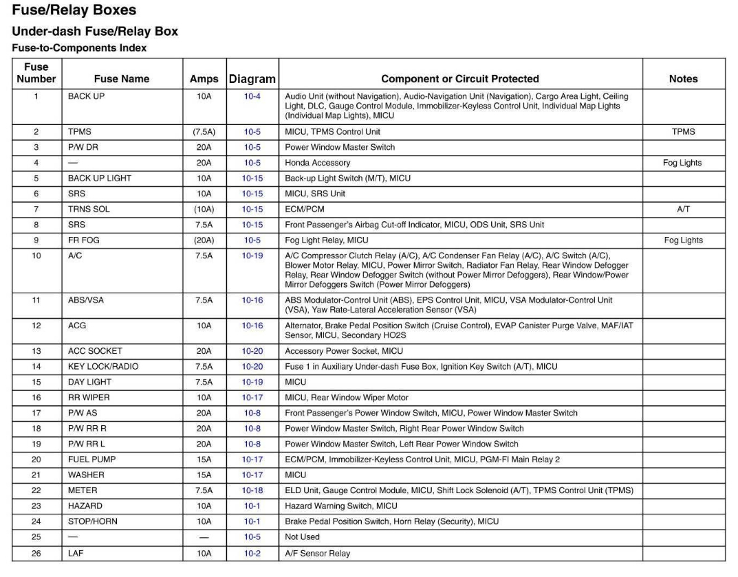

It looks like the unit shorted out after charging the battery I am wondering if the voltage was too high causing the issue. Did you try installing the code? Let check the fuses to make sure we are all good there. here is a guide and the fuse locations:

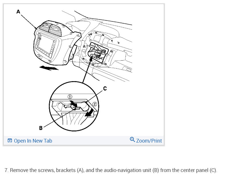

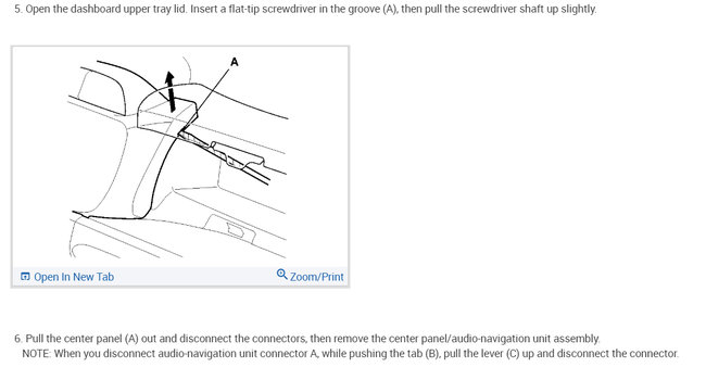

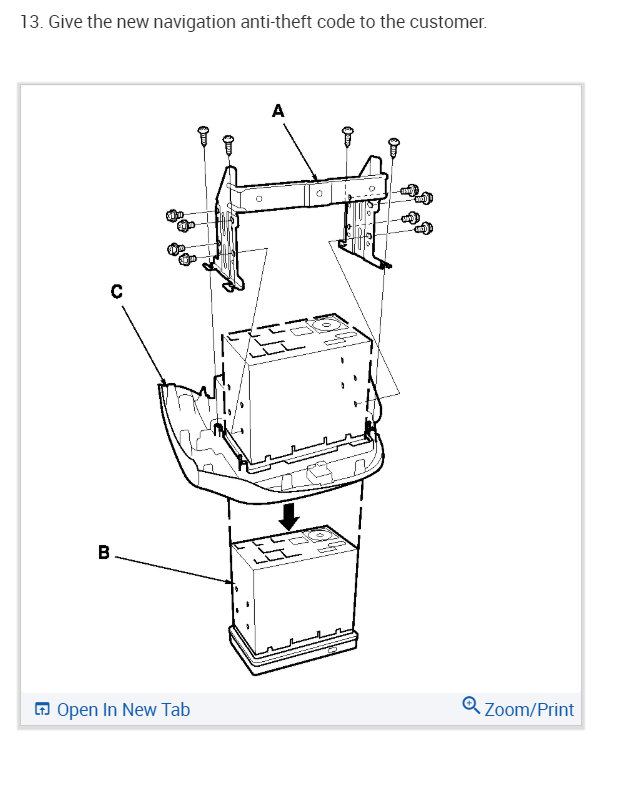

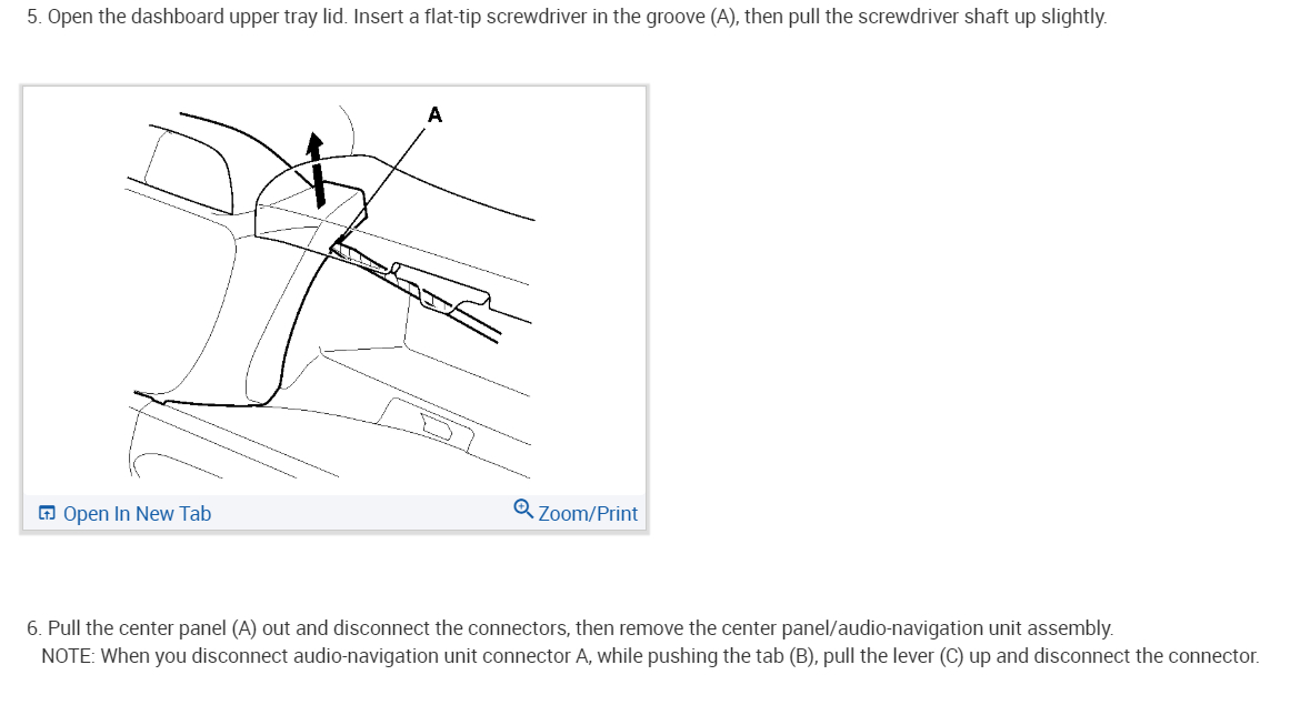

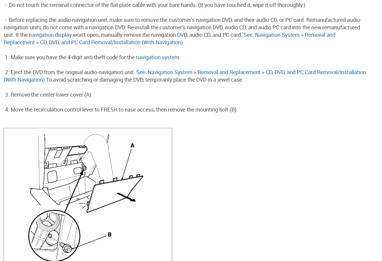

If the fuses are okay here is how you can remove the radio/navigation for repair. Check out the diagrams (below). Please let us know what happens.
