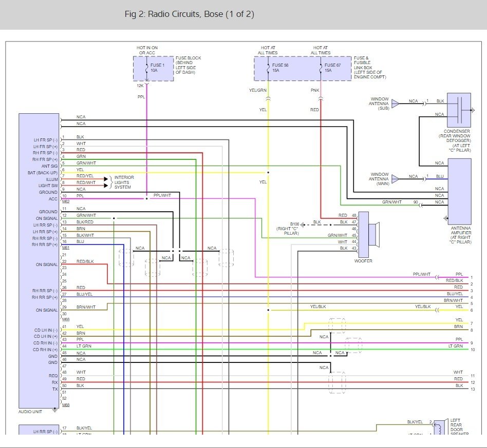

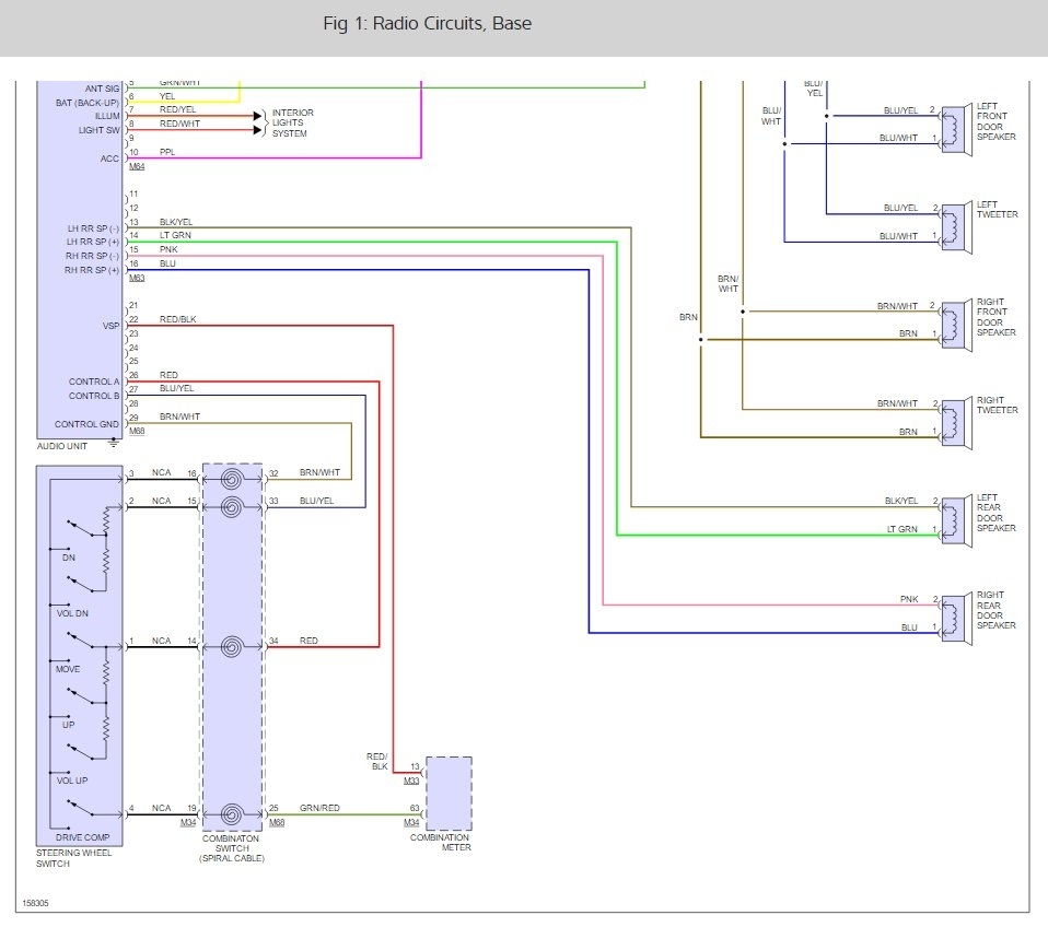

No sound comes out.
May 16, 2017 at 7:33 PM
  • 54,832 POSTS

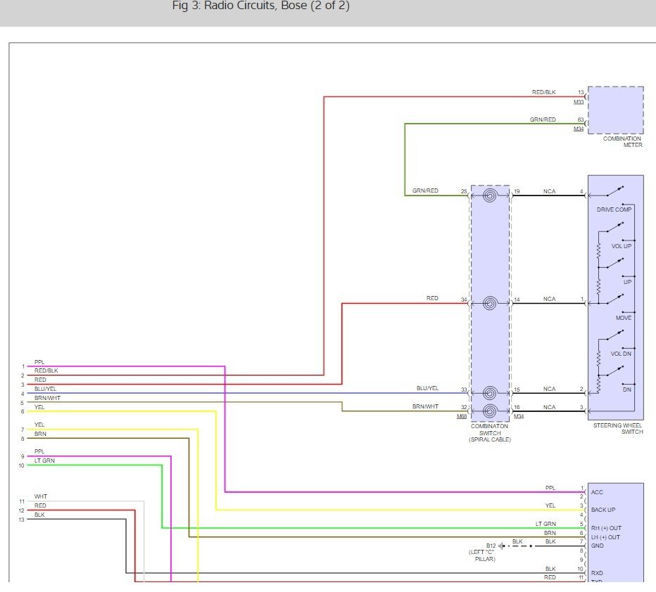

there are two radio systems in this car one has an amp. I have found the wiring diagrams for you and a guide to help you find the problem. Check the fuses first.
If the fuses are good then the amp or the head unit has gone bad.
Please run this test and get back to us so we can continue helping you.
