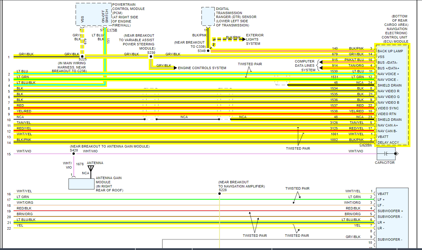

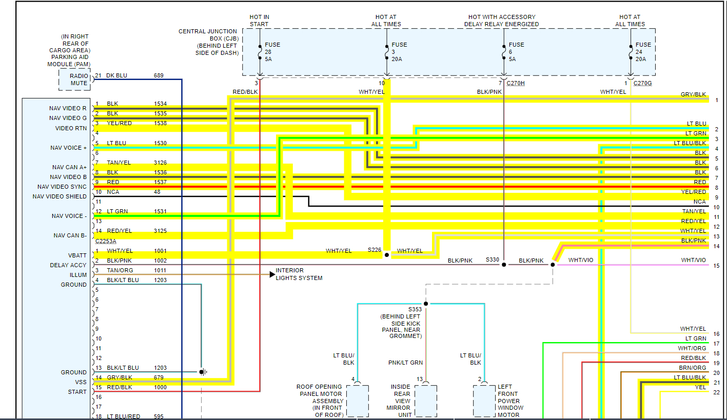

The CD player in my car went out and the DVD player comes on, but has lines through screen. replaced the fuse for radio but it still does not turn on.
Jan 26, 2017 at 1:19 AM
Good afternoon,
This sounds like the screen is the issue with the lines.

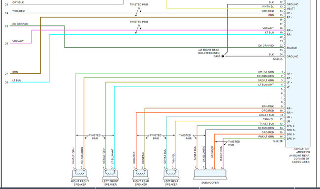

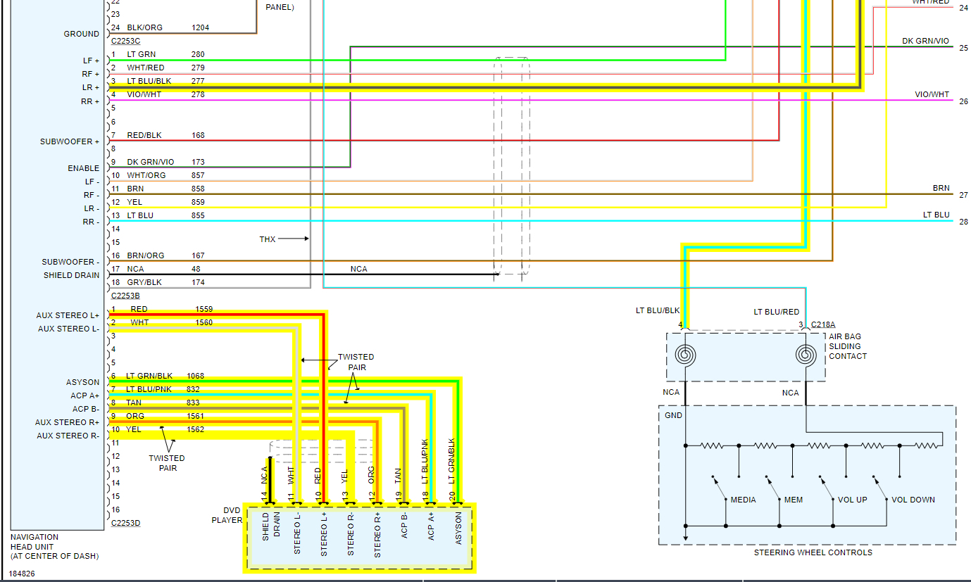

I attached a description and a wiring diagram for you to view.
You will need to have this confirmed by someone with a scan tool to verify the failure.
