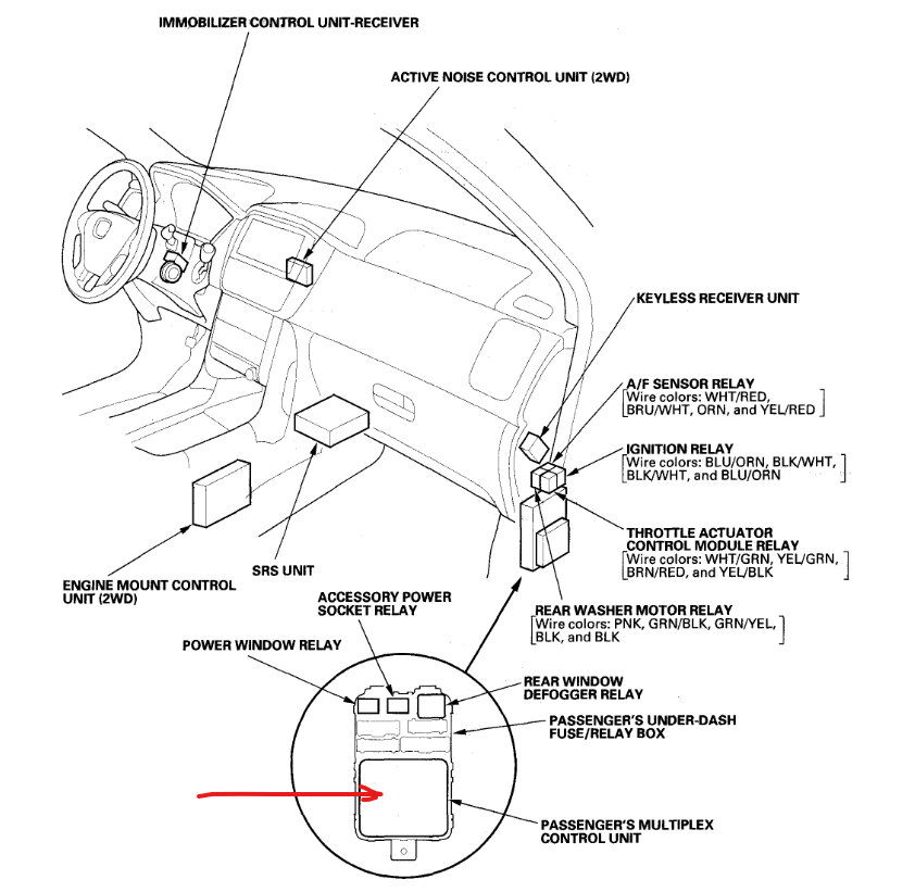

The radio, cigarette lighter and auto locks and windows keep going out. Replaced fuses, will work for a while then goes out again. What else could it be?

It sounds like the passenger's side multiplex unit is going out, but to be sure we need to perform a CAN scan, you can get a CAN scanner (Controller Area Network) from Amazon.

Here is how to change out the multiplex unit in the images below. Please let us know what happens.
