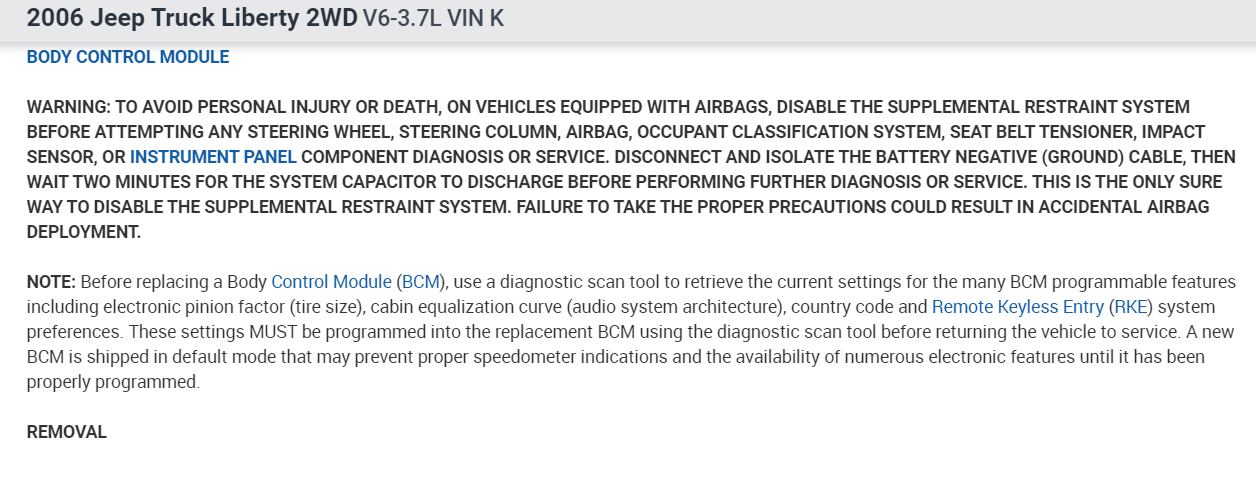

Ignition on center locking works radio doesn't. Key off center locking doesn't work.

Let's run the codes to confirm the BCM failure. You can get a CAN scanner (Controller Area Network) which will work on most cars from Amazon here is a video to show you how.
https://youtu.be/u-4syLc-ifQ
and
Here is one for about $99.00 if you need it:
https://amzn.to/3ZixY4v
I would check all fuses, this guide can help:

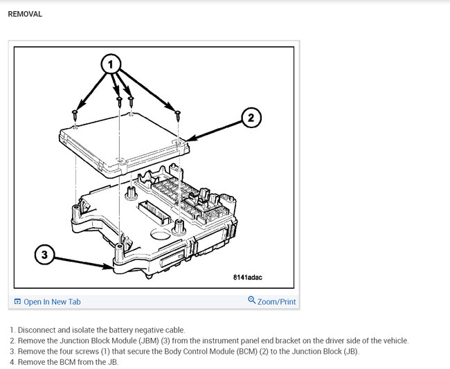

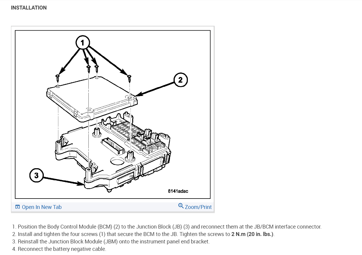

Here is how to change the BCM out in case you need it. Check out the images (below). Please let us know what happens. You can get a preprogrammed unit by searching Google or Ebay.
