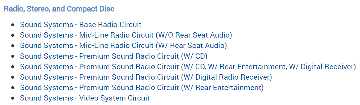

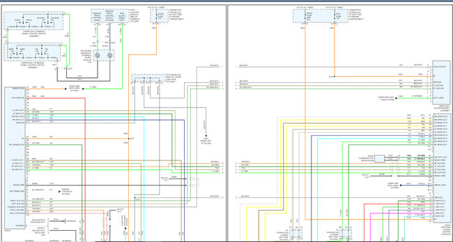

Hi, I have the vehicle listed above that has a parasitic draw. When I pull my stereo/amp fuse the draw goes away. I am wanting to know what all is involved in the wiring in this system. I had changed my amp already and it didn't make a difference.
Nov 5, 2020 at 6:52 AM
  • 110,251 POSTS
At that point, I would leave the fuse in and then disconnect the radio to see if that stops the draw.

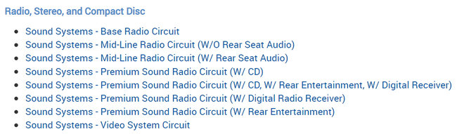

I will be happy to provide wiring schematics to help, but I need to narrow things down. If you look at the attached pic, you'll see all the optional sound systems for this vehicle. Can you identify which yours is?

I am not sure but I think it is the premium sound with rear entertainment. I took out the radio and it didn't make a difference. The radio works and I get sound from it. Only I am getting this draw. When I pull the radio/amp fuse 30 amp. The draw goes away.
Nov 5, 2020 at 8:43 AM
BROKENTOE
  • 33 POSTS
There is a video system circuit as well. It has a DVD player.

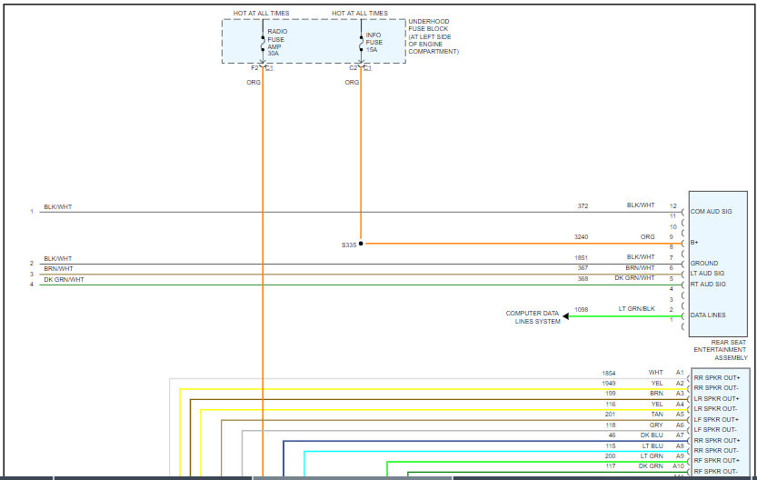

I attached the wiring schematic for this system. I had to overlap them to make it readable.
The first thing I would do is disconnect the rear seat audio controller to see if that stops the draw. The radio fuse sends direct power to the radio and that controller. If the radio is off, it shouldn't be drawing, so that's why I suggested the controller. See what happens.

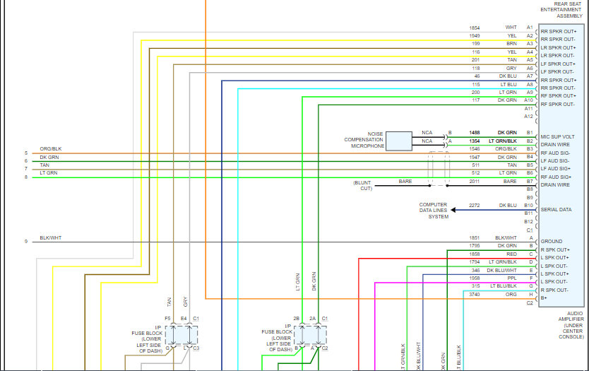

While I had the rear cover off I thought I would disconnect the amp on one side. That made the difference. Only now where to go from there? It was the left side I disconnected.

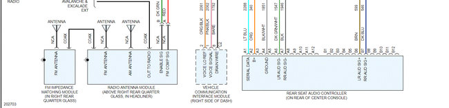

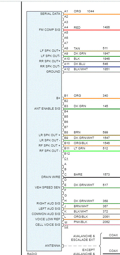

Would it be possible to get the pin layout for the harness I described? I have 20 pins being used on this harness.
Nov 5, 2020 at 2:00 PM
  • 110,251 POSTS
Take a look at the attached pics and let me know if they help. It doesn't show a connector, but does show what each wire is for.
Nov 6, 2020 at 6:05 AM

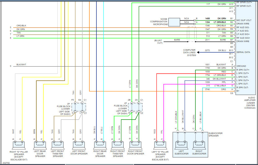

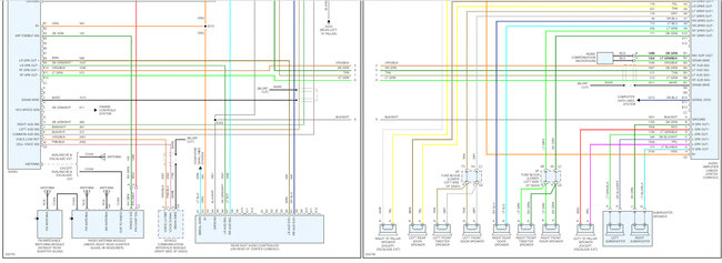

You are focusing on the radio. I am focusing on the amplifier which has a separate power supply.
Nov 12, 2020 at 3:18 AM
DANNY L
  • 5,648 POSTS
Hello, I'm Danny.
Here is the 2nd page of the radio-amplifier wiring diagram you requested. This is the amplifier wiring page for your truck. I've cut it into 3 pieces so you can view larger. Hope this helps and thanks again for using 2CarPros.
