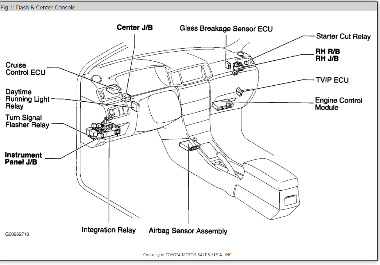

I have a right hand drive and the radio stopped working. I do not know where to locate the fuse panel inside the car to see if that is the problem.
I have found the fuse panel and none are marked radio, all the fuses are good but i do not have a radio or clock working. Any advice would be great thanks.

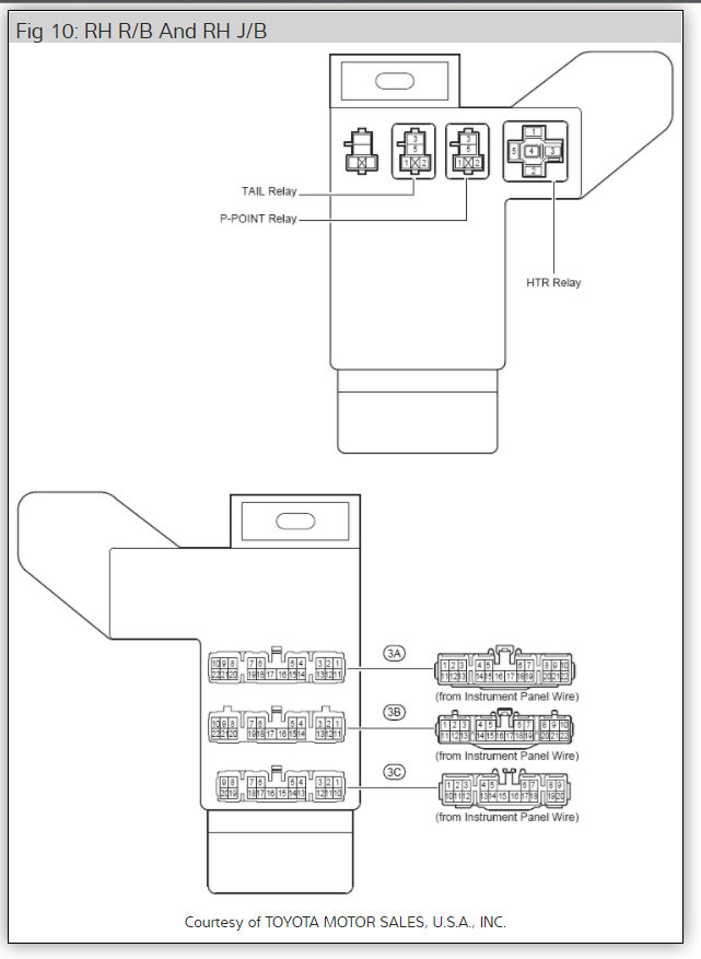

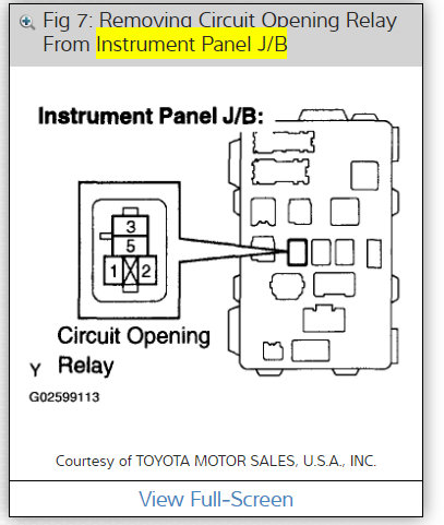

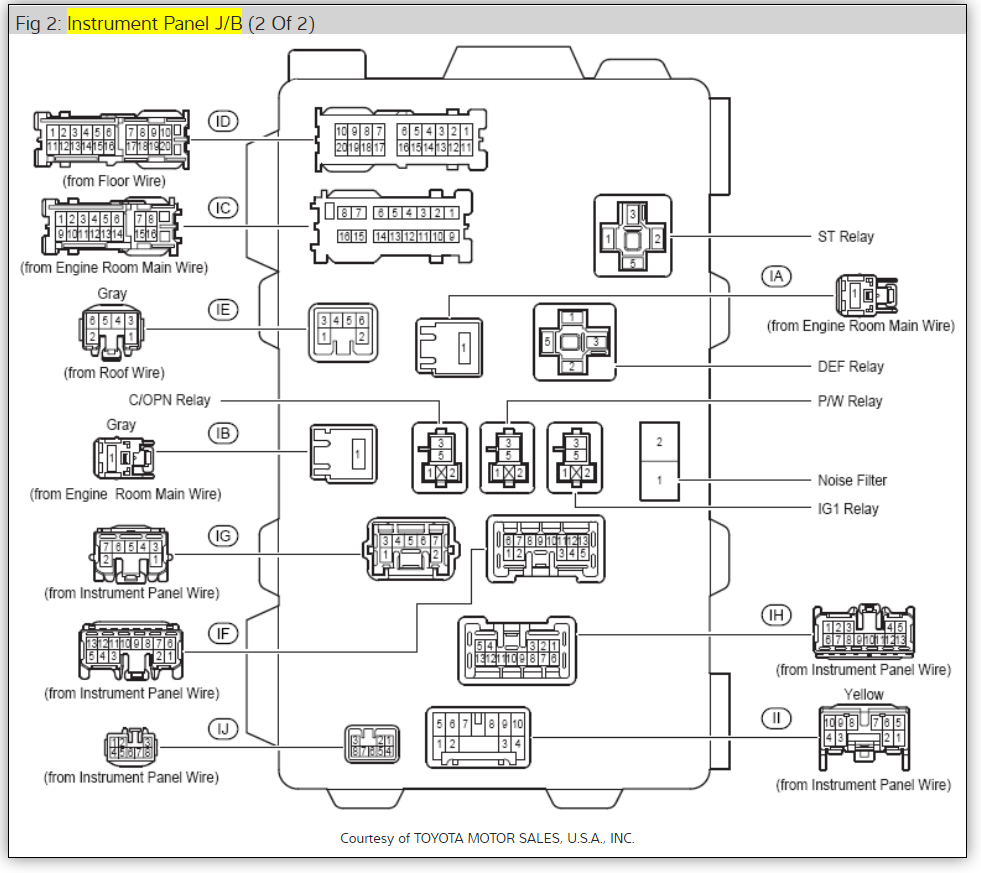

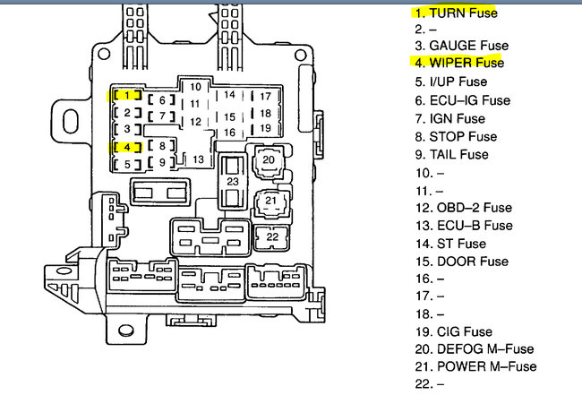

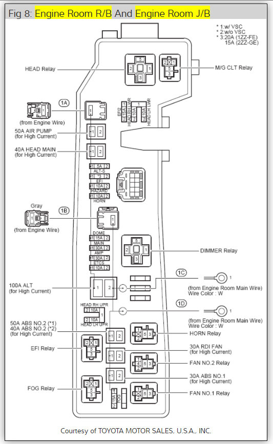

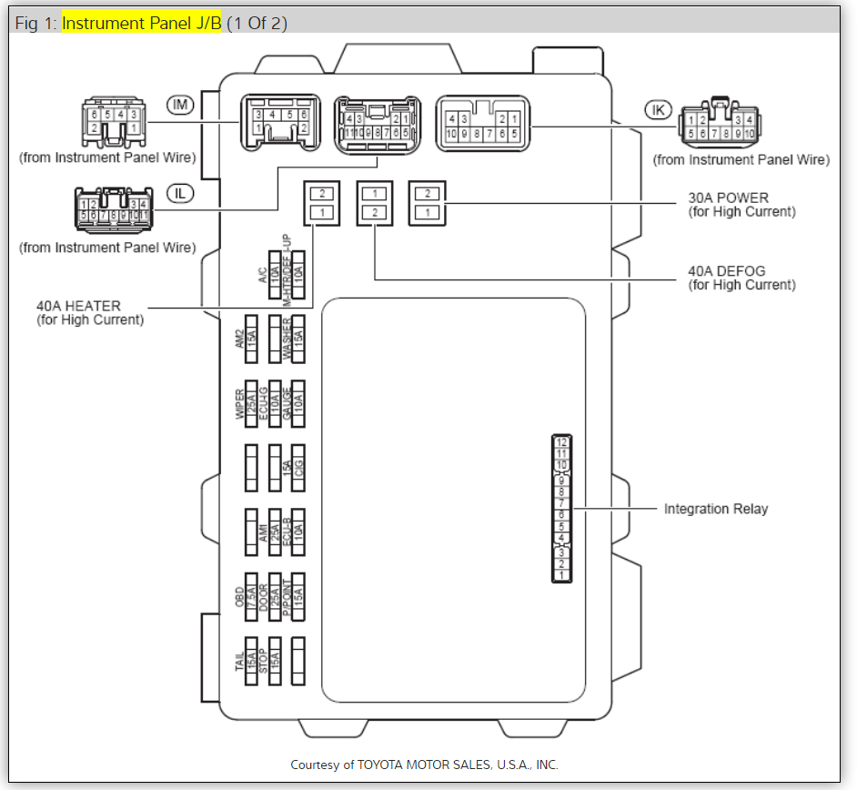

Check the "cigarette" fuse in the I/P fuse block and the "dome" fuse, under the hood. Here is a guide to help you check for power and the fuse location with the diagrams below .
Check out the diagrams (Below). Please run this test and get back to us.
Dec 26, 2017 at 10:45 PM

I cut a zip tie off some wires and nicked one it blow the dome fuse and would not crank. I replaced the fuse then the car cranked. Makes no sense. Then checked all others fuses and they are good. And still getting no where what could be the problem?
Oct 14, 2020 at 5:46 AM (Merged)

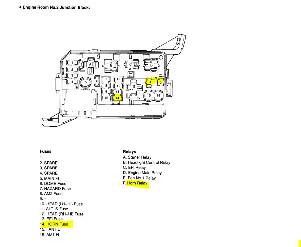

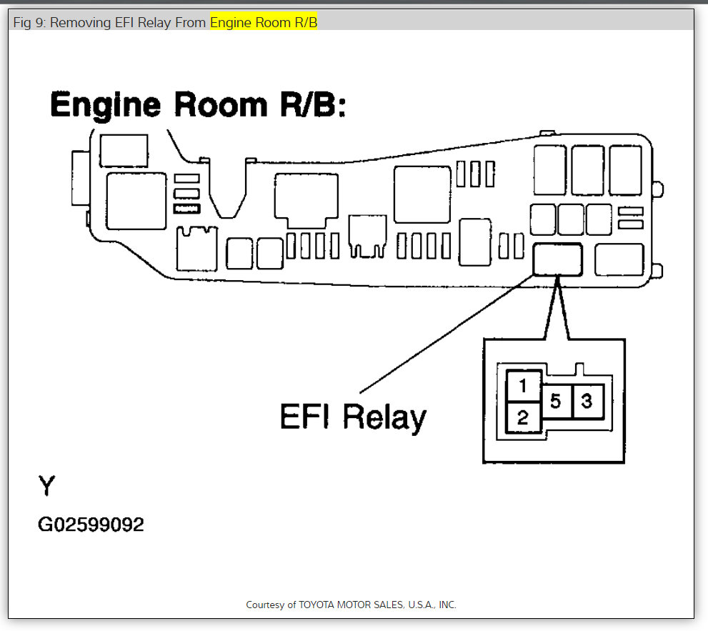

  • 110,244 POSTS
Where was the wiring harness located that was damaged? Also, have you checked fuses both in the vehicle as well as under the hood? I attached two pics below showing the fuses for the components related as well as the horn relay.
Even if you checked the fuses and they are good, I need you to check to see if there is power to the fuse. Additionally, check the horn relay if power is good at the horn fuse.
