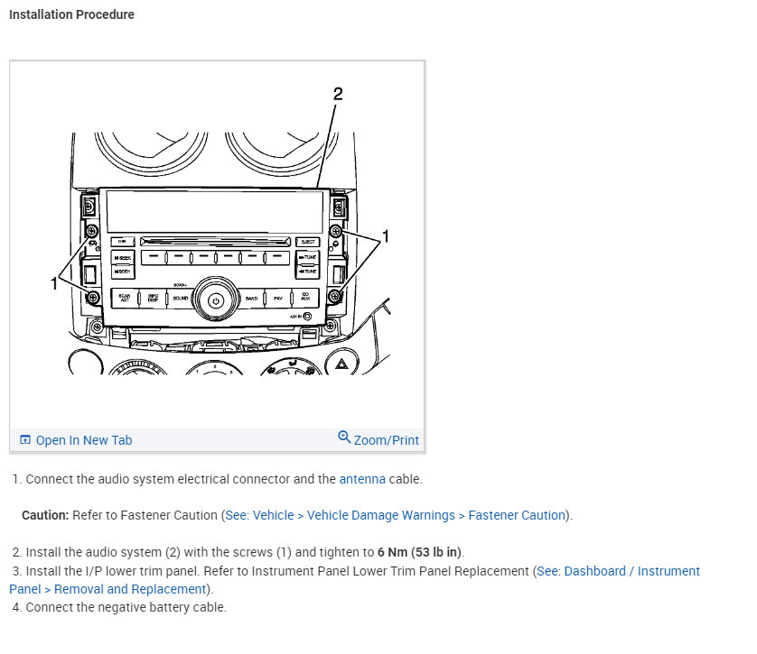

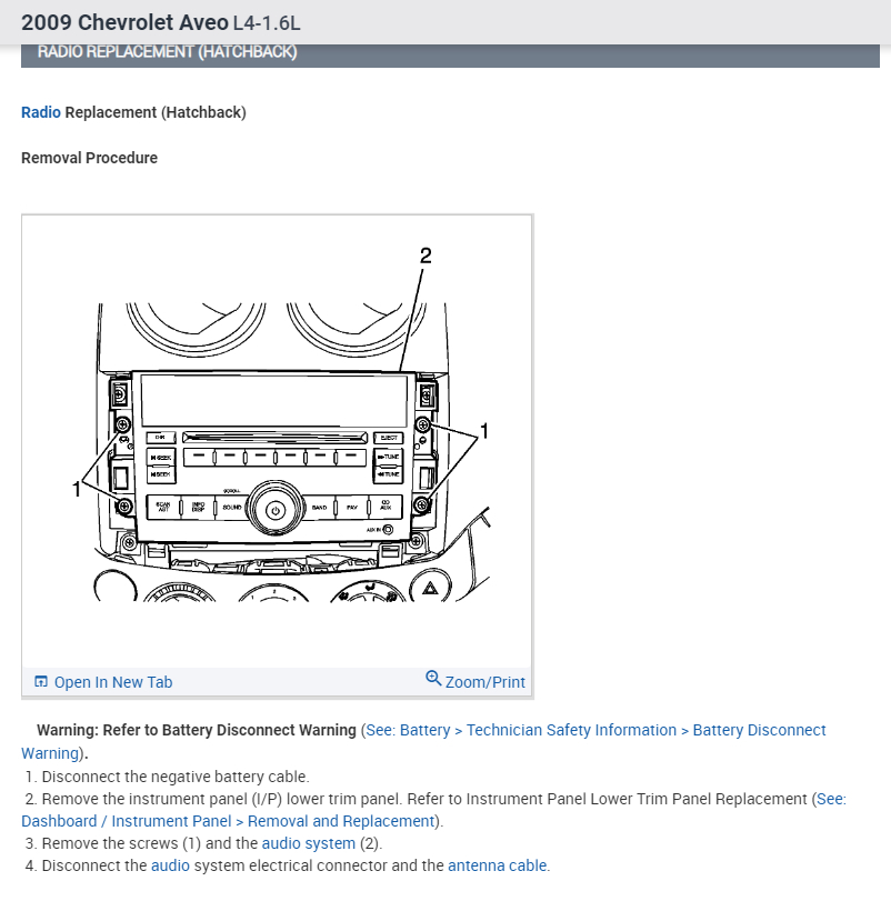

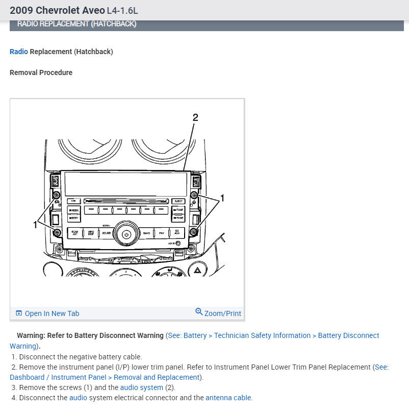

What stereo could i replace with the stock one?
Jun 7, 2022 at 5:49 PM
SQM
  • 6,383 POSTS
If you are looking to get an aftermarket unit, there are many different options that will work in your vehicle. Most aftermarket units will require a vehicle specific adapter to mount the unit and wire harness to connect to the factory wiring.
If you are looking to find a compatible factory stereo unit then the best option would be to call your local dealer and provide them with the VIN. They will be able to let you know which years that exact stereo was used.
I have attached a couple of diagrams below for your reference.
Let me know of any questions.
