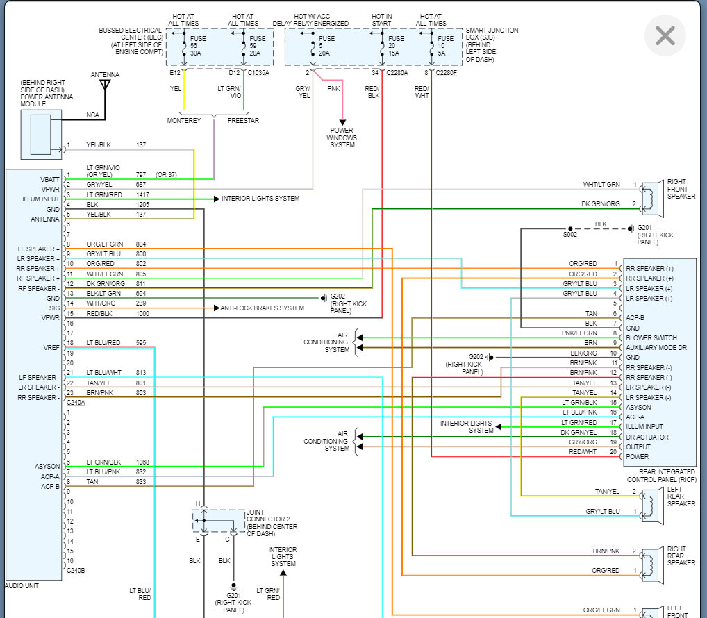

I cannot find a link or picture of the normal color diagram for the radio wire color van. I have found something different each time I have looked. I would like a picture of the normal color diagram for the radio.

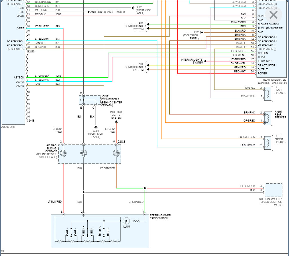

I am attaching the info required but here are a couple guides that will help with this type of testing if needed:
Below you will find the wiring diagrams for this vehicle as requested.
Please run through this and let us know what other info is needed.
Thanks for using 2CarPros.
