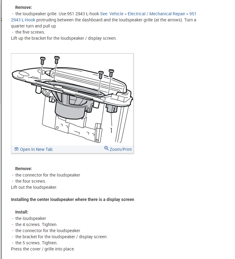

This problem just started after i drove through a bad rain storm. it pops when I turn the radio on
Nov 7, 2019 at 7:13 AM
Does this happen from one speaker? If so, then this is a speaker issue.
If not, then more than likely you have connection issue with the radio.
Here is a video that will help with replacing a radio. I know this is a different vehicle, but this guide will help with some useful info.
https://youtu.be/p_13d9FzsF0

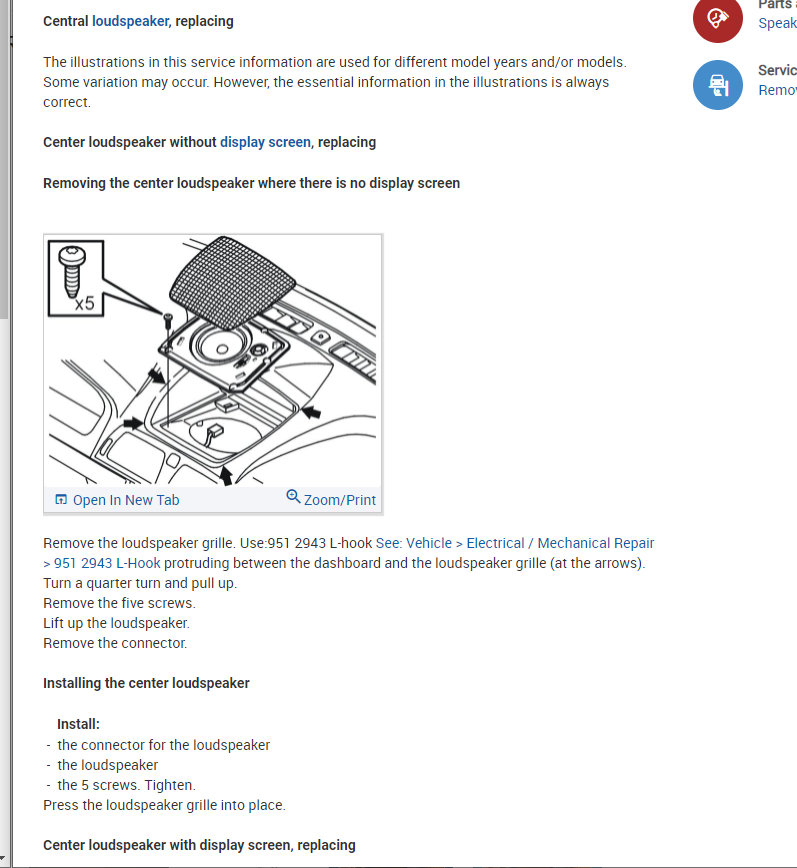

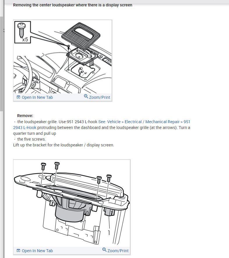

More than likely this is an issue with the center speaker as I have seen a few issues with this speaker.
I attached the info below on how to replace this. Please let us know what you find. Thanks
