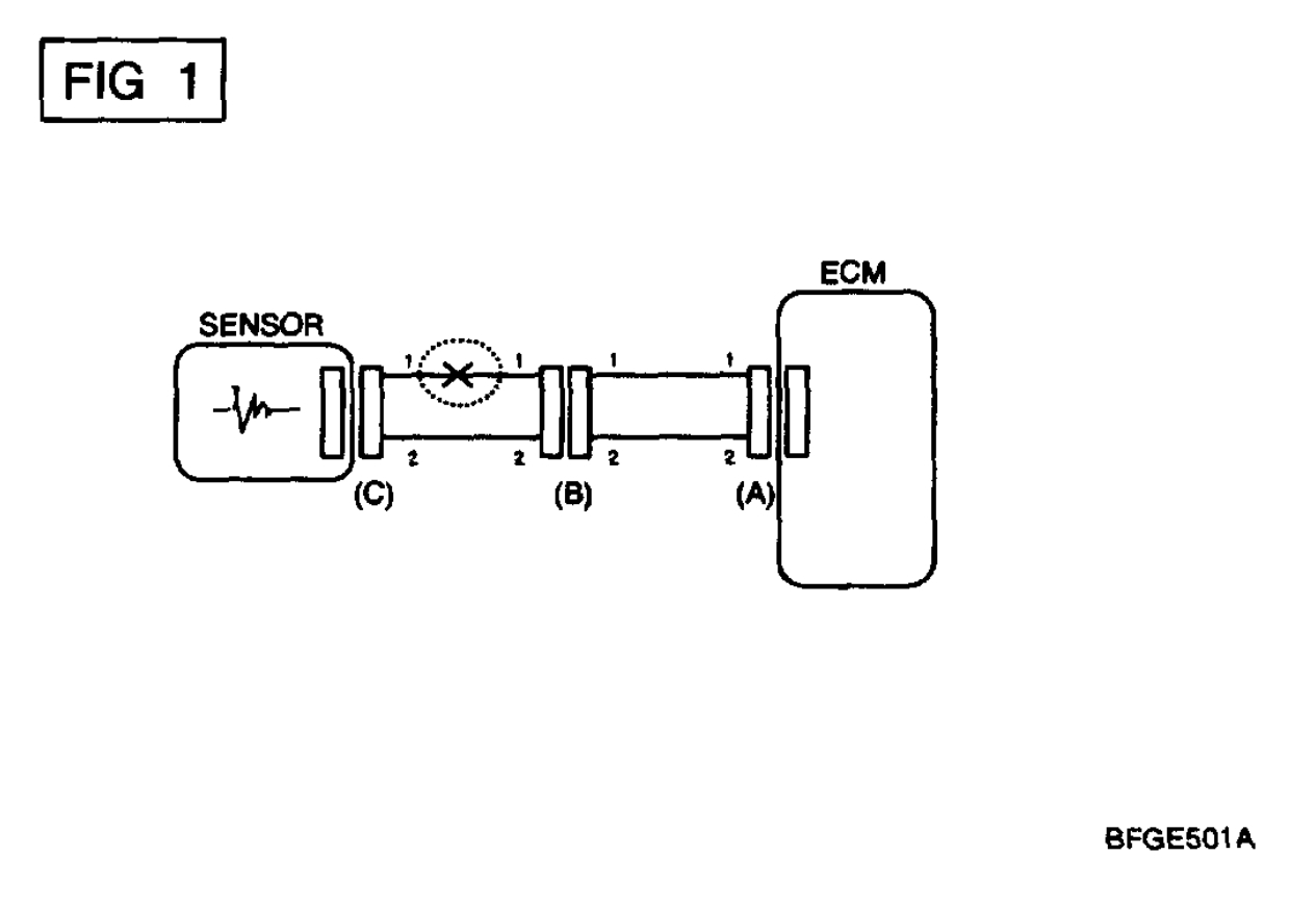

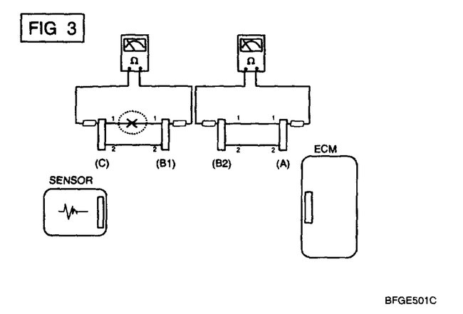

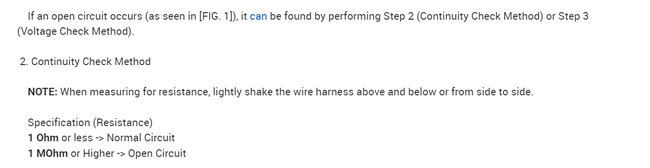

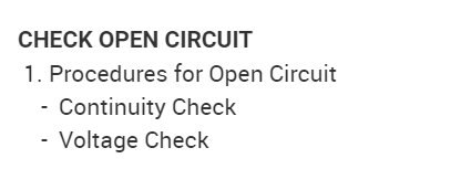

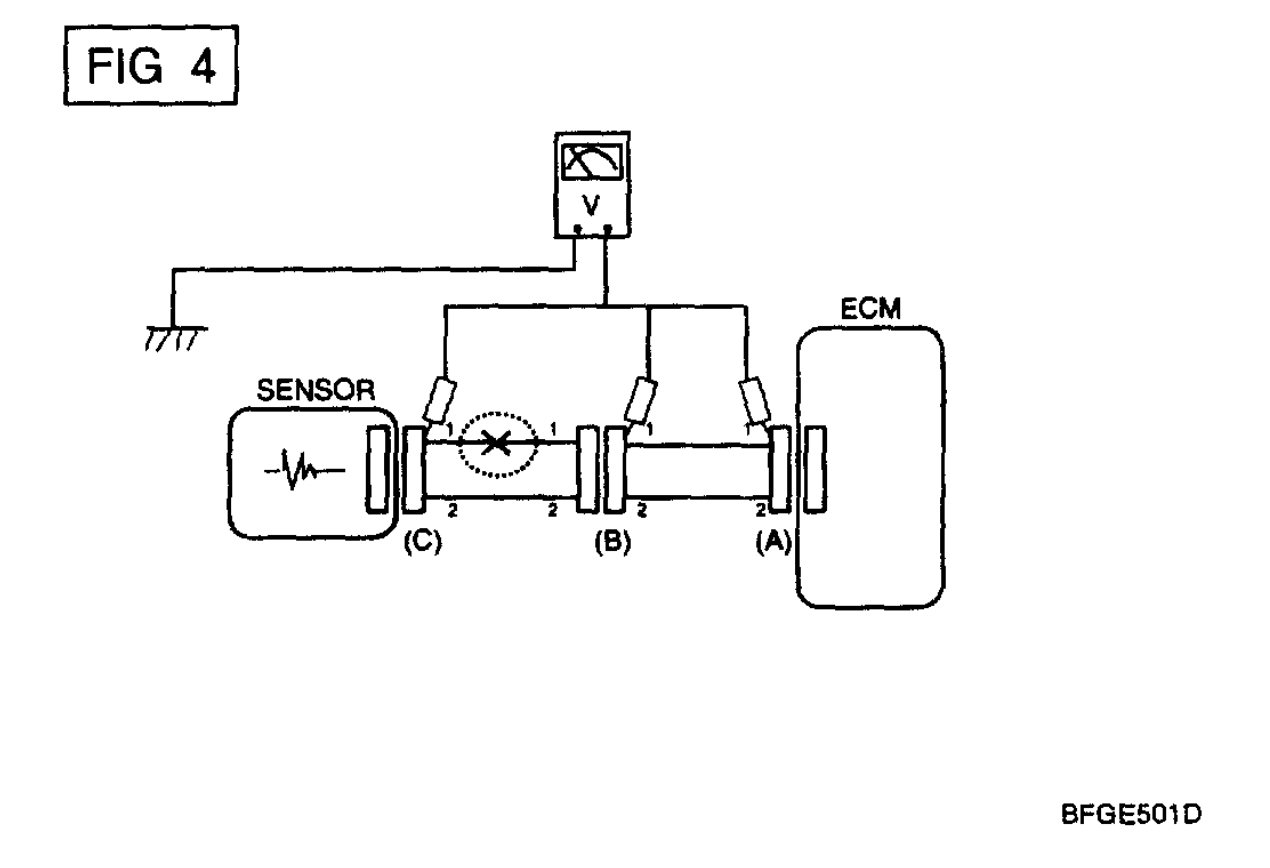

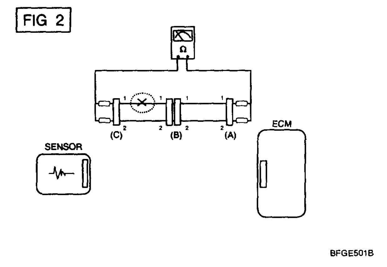

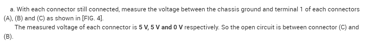

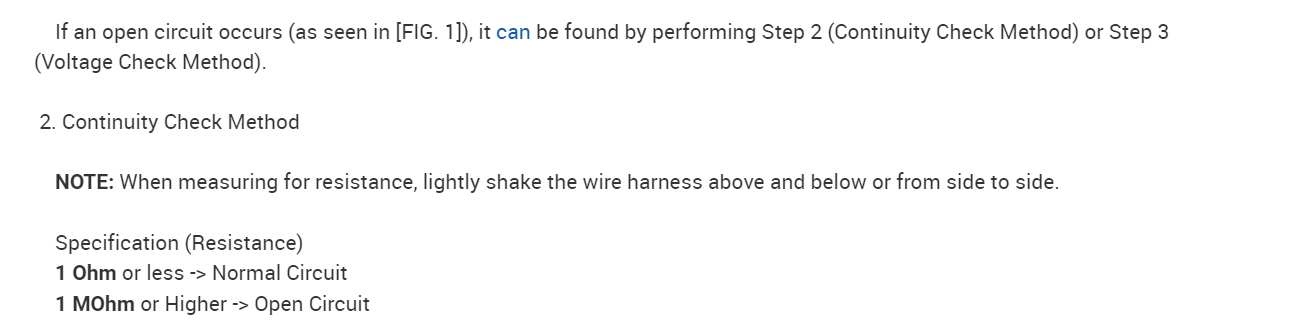

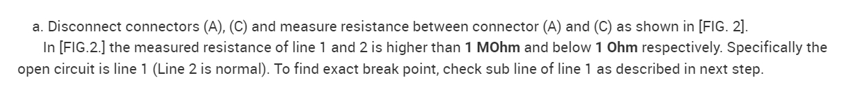

You are going to have trace the wire back to the battery and find out where the open is in it. I have included directions on how to find an open in a circuit in the diagrams down below. Please get back to us with what you are able to find out.
Thanks,
Alex
