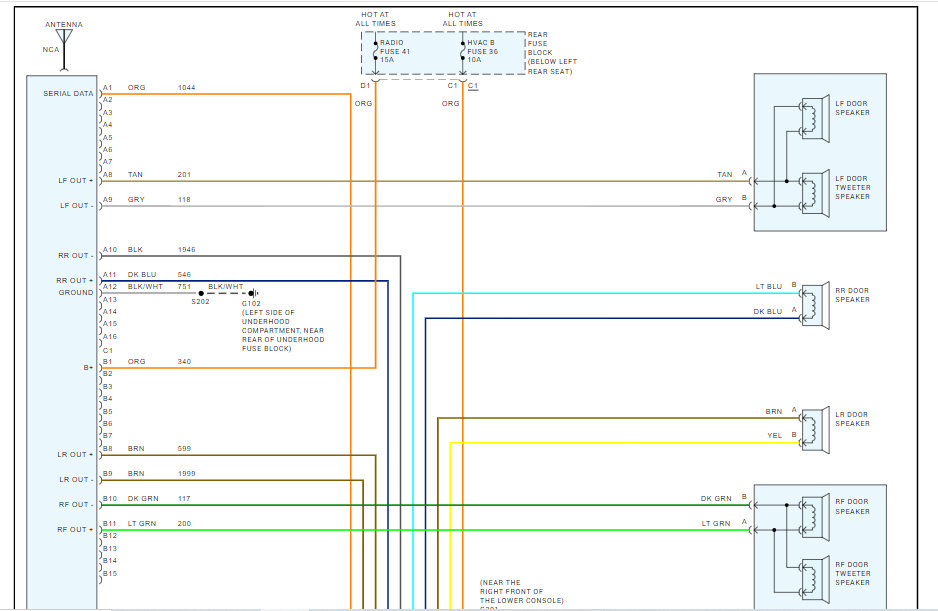

I am trying to put in a new head unit, but it has a Boss radio that has an amp i found out. i need a wiring diagram for that so that i can figure out how to wire it up.

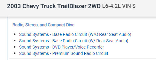

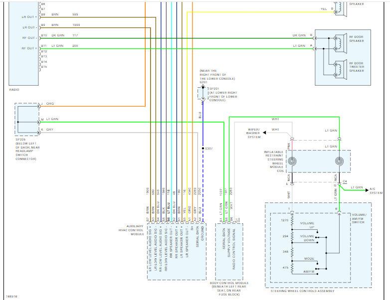

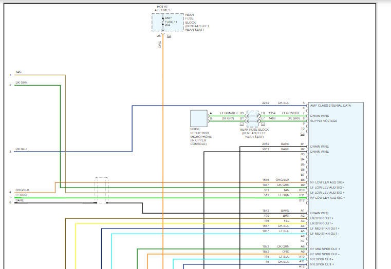

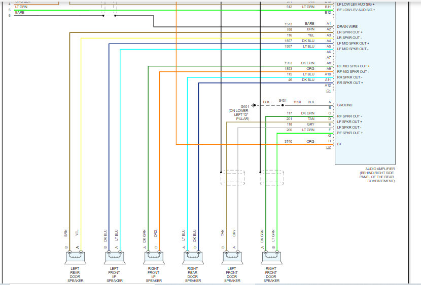

This schematic is for the premium sound system. There is nothing identified as a Boss. See the last pic of my options.
Let me know if this helps.
joe

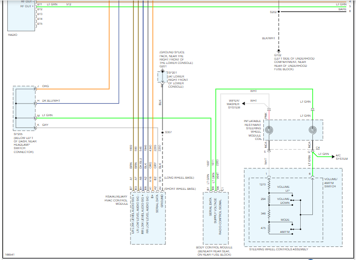

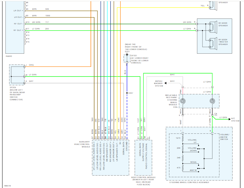

See pics below. Note: I had to cut each schematic page in half to make them readable. I did overlap them so you can follow from one to the next.
Feb 11, 2024 at 9:22 AM
CARMIE909
Thanks, but not the right one because my stereo connector has A1-A12 and B1-B12 plus and a second smaller connector.
i have pins in A1,A8,A9,A12,B1,B4,B5,B10,B11

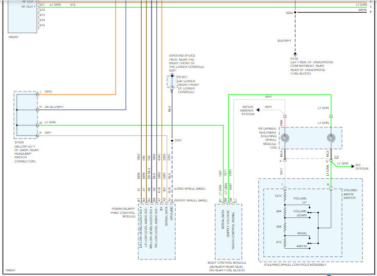

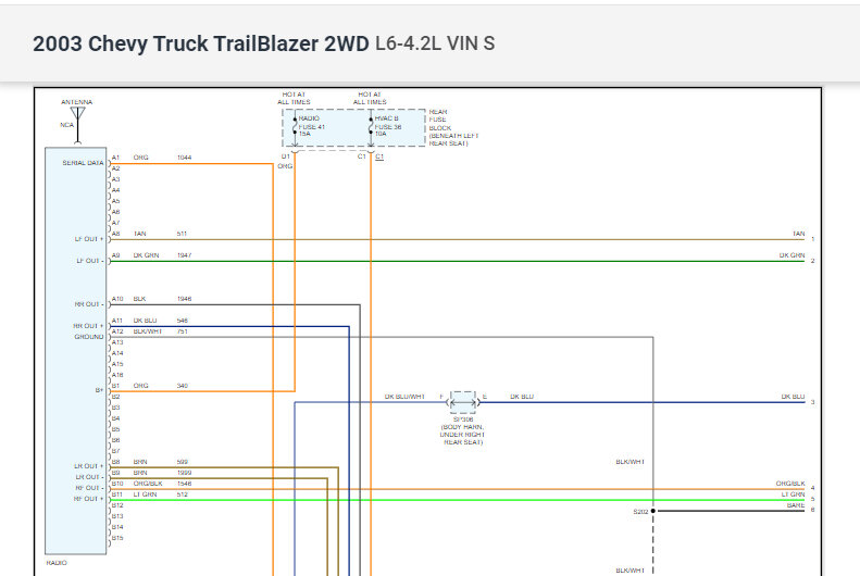

Do you recognize anything as far as type in the last pic I attached? Is the OEM radio still in the vehicle?
Feb 12, 2024 at 6:50 AM
CARMIE909
I still have the radio my guess is maybe the one with rear seat audio.
Feb 12, 2024 at 6:54 AM
  • 110,244 POSTS
I attached that one below. Many of the pins align but when I got to the B connector, they appear different.
