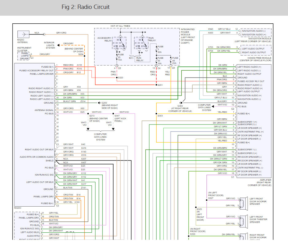

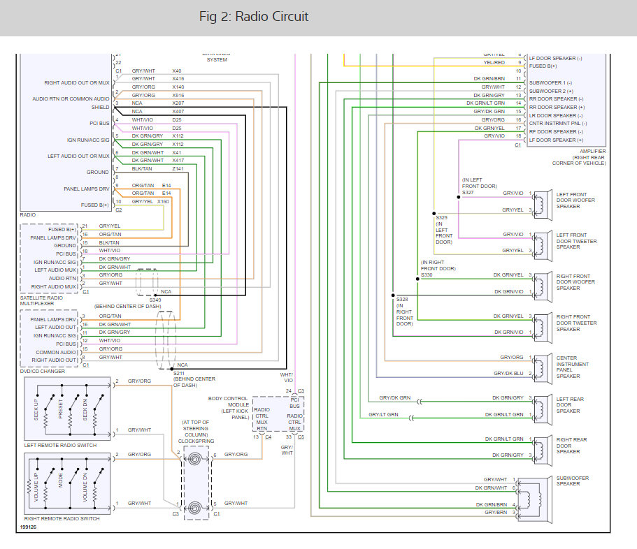

Car speakers have no sound after installing aftermarket radio.
Friday, November 3rd, 2017 AT 9:46 AM
2 Replies
STEVE W.
  • 15,358 POSTS
Hello
It sounds like you got some wiring mixed up here are the radio wiring diagrams so you can double check your work and see how the radio system works. This guide will help.
Check out the diagrams (Below). Please let us know what you find.

GIUGGIOLA
Thank you for this post I had this problem and had to replace the radio fuse cost me $4.00 all fixed I love this site.
