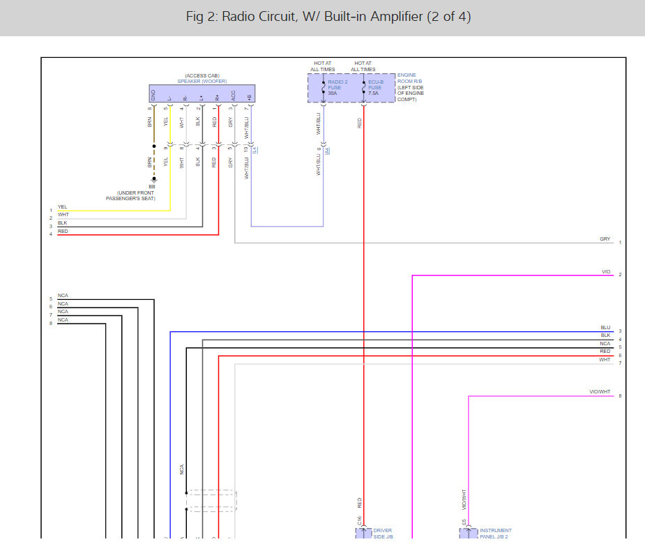

Radio comes on and looks as to be working but no sound?
106,000 MILES
RLREEDY
No sound coming from the radio?
Dec 23, 2022 at 12:27 AM
  • 55,676 POSTS

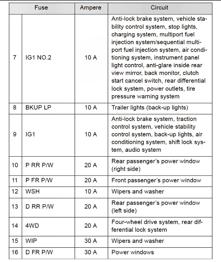

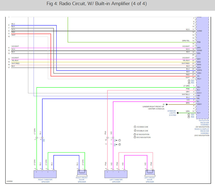

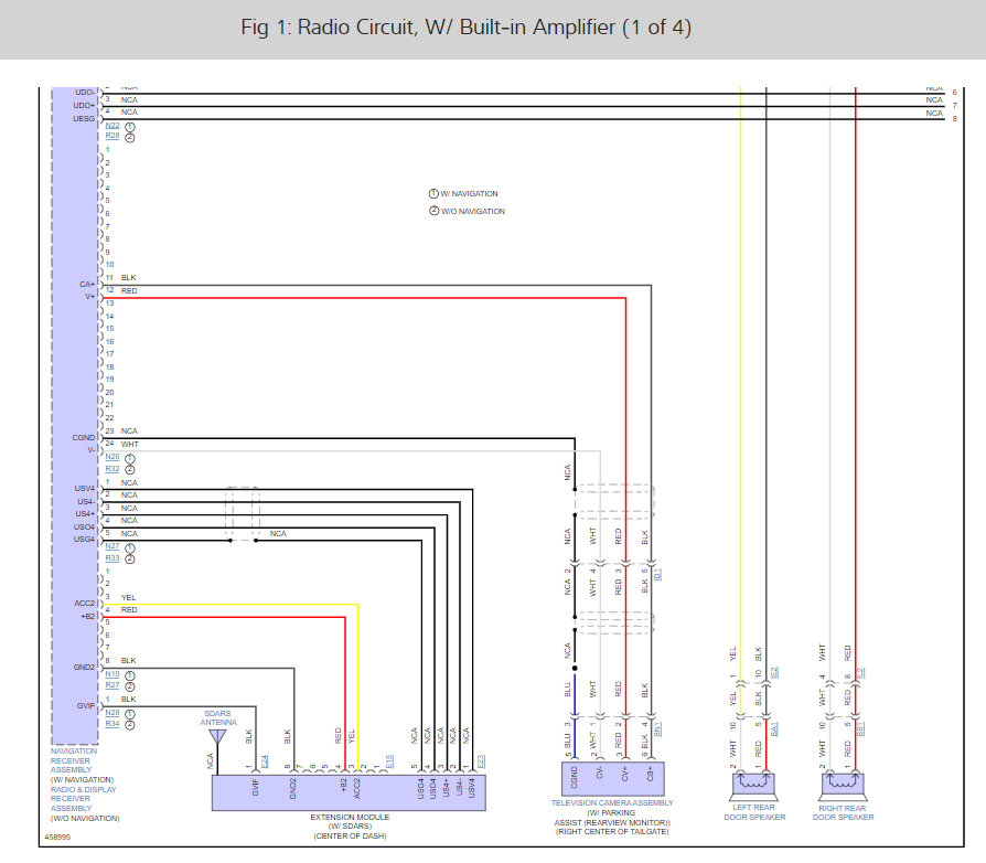

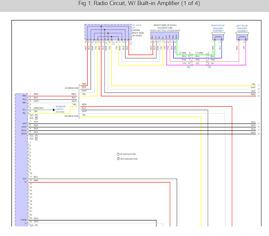

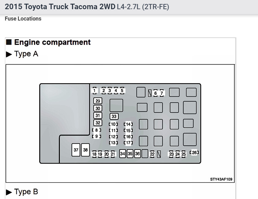

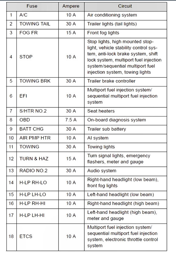

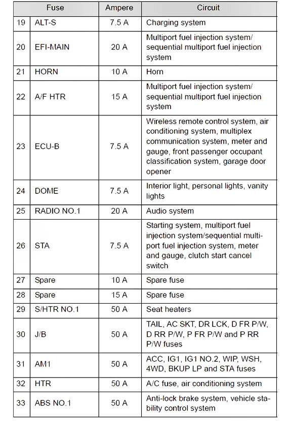

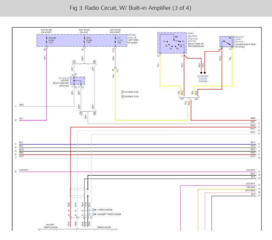

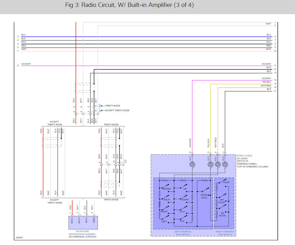

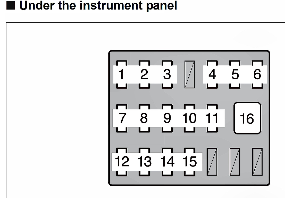

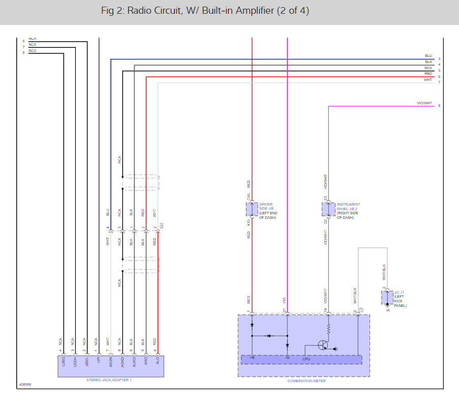

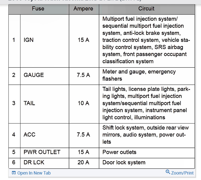

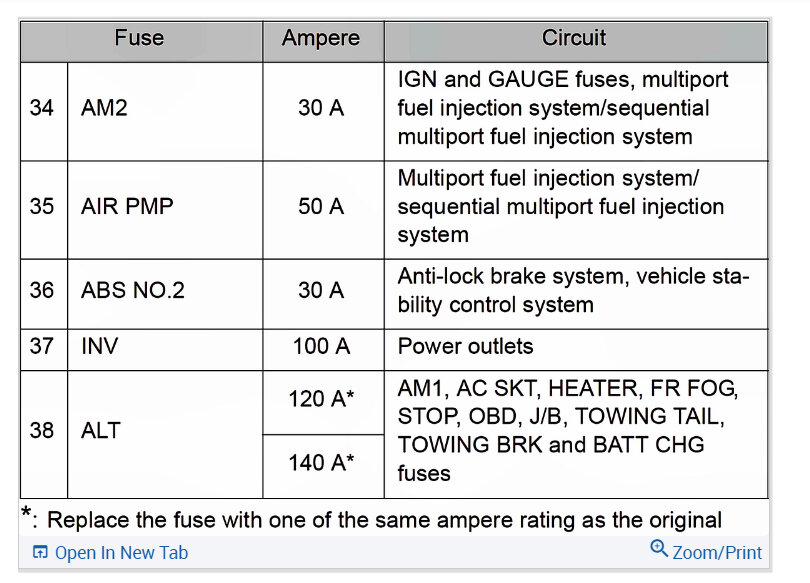

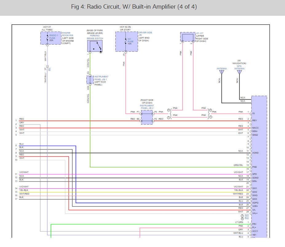

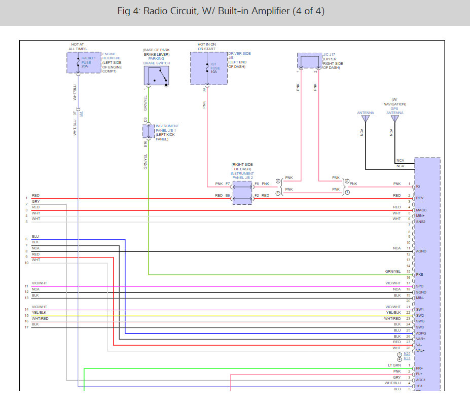

This vehicle has two different radios, one has an internal amp, and one is external, I would start by checking the fuses (radio 1 fuse and radio 2 fuse) under the hood and the ACC fuse int eh fuse panel on the left side of the dash. Here is a guide to help and the fuse locations as well, I also included the radio wiring diagrams so you can see how the system works. If all of the fuses are good, I would try to disconnect the battery overnight to reset the system.
Dec 24, 2022 at 2:24 AM
RLREEDY
I tried the battery way and it didn’t work and it seems that all the fuses work. Do you have any other ideas of what to do?
Jan 5, 2023 at 6:33 AM
  • 55,676 POSTS

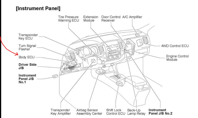

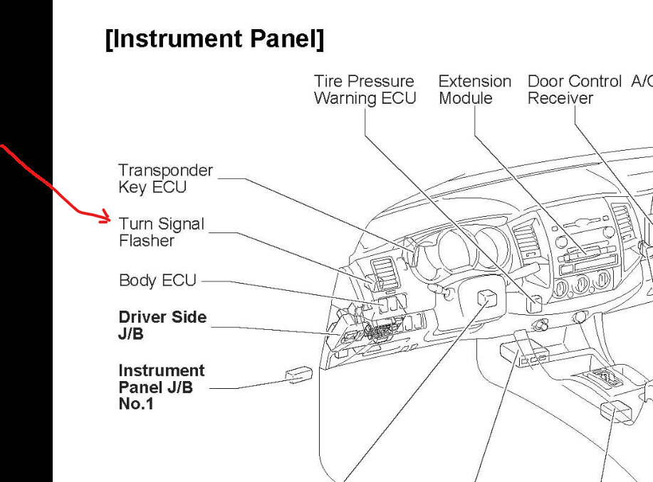

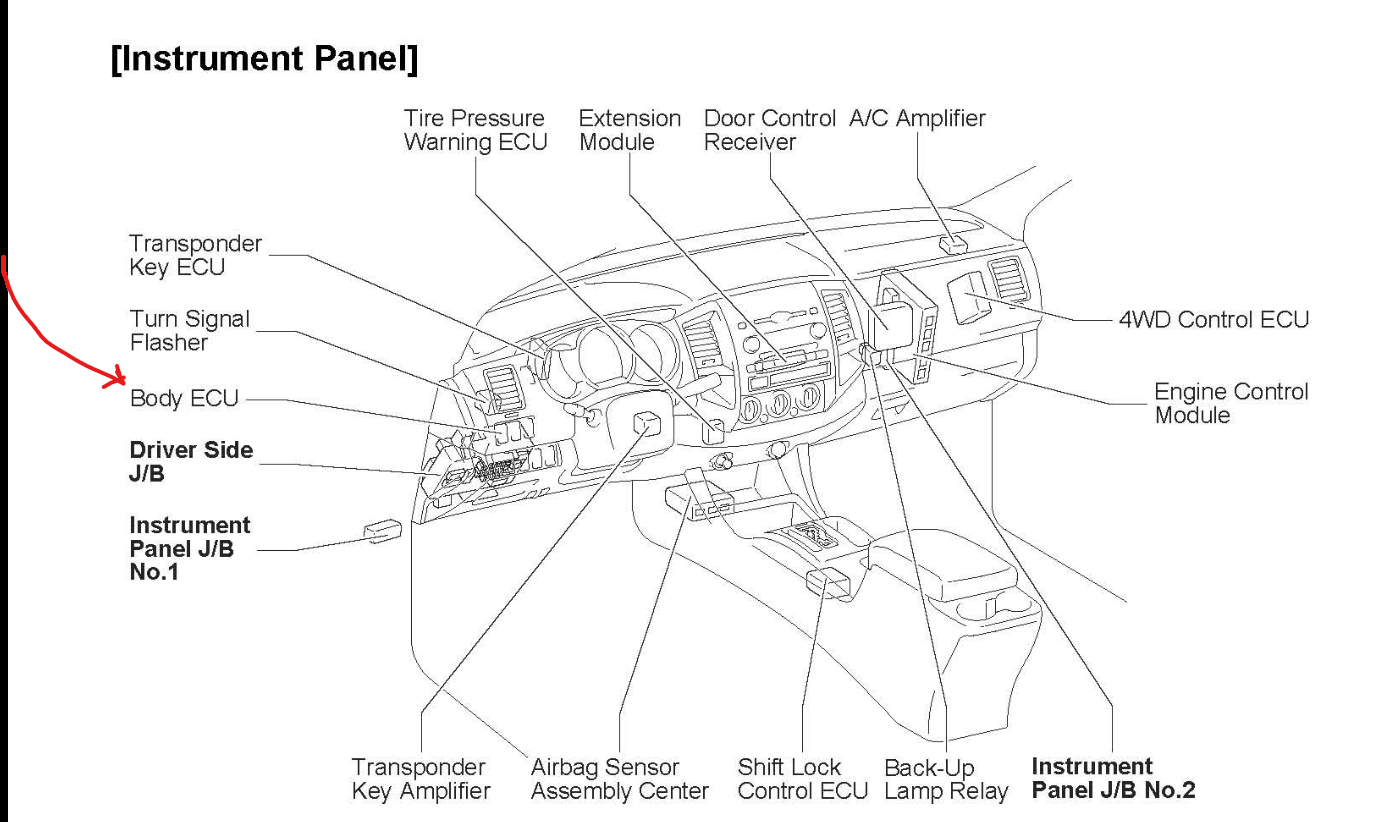

That will leave the BCM or radio LAN input, we will next do a CAN scan to help us see what's wrong. You can get a CAN scanner (Controller Area Network) from Amazon from about $32.00. here is a video to show you how. Also it could be the turn signal flasher I have included the location in the images below.
https://youtu.be/u-4syLc-ifQ
and
Amazon CAN scanner Link.
https://amzn.to/3G7mpFP
You can get a rebuilt preprogrammed BCM by searching google or eBay for a rebuilder. Check out the images (below). Please let us know what happens.
