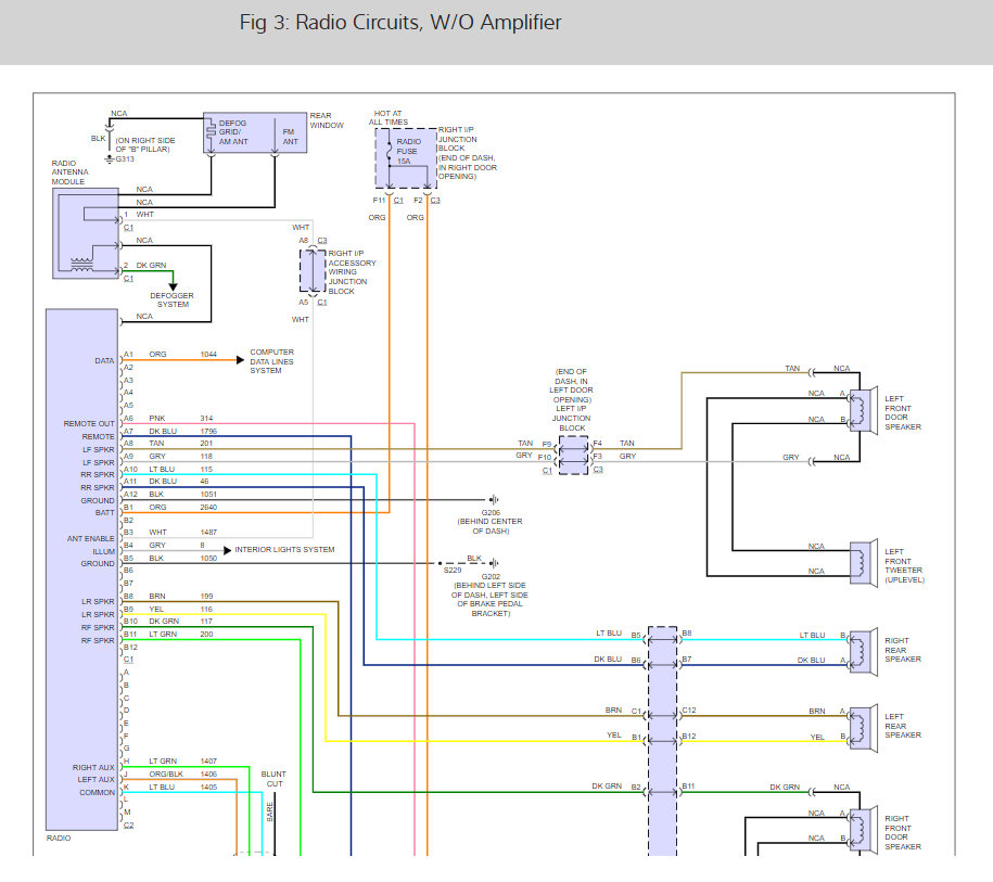

I have the car listed above LS model. I am swapping out the radio one and after I installed the aftermarket radio I decided to take it back and put the original radio back in. for some reason my radio won’t turn on. it lights up like the buttons light up but the radio has no display or anything. how can I fix this ?
May 13, 2019 at 1:53 AM
  • 55,694 POSTS

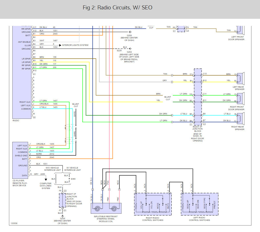

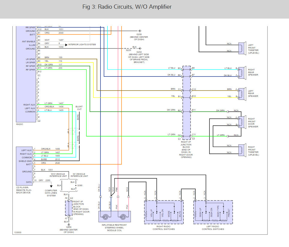

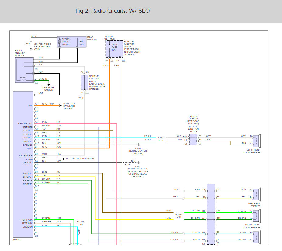

When installing the aftermarket radio did you cut any wires or change the harness? Here is a guide to help you check the wiring and the radio wiring diagrams below so you can see how the system works. Does this unit have an amplifier?
May 14, 2019 at 4:29 AM
01MONTE_PROJECT
Yes, it does have the factory amp.
May 14, 2019 at 2:09 PM
01MONTE_PROJECT
But I did not cut any wires.
  • 55,694 POSTS
It sounds like the head unit went bad if all wiring is good and working. Did the unit get dropped or water damage? Disconnect the wiring and reconnect to see if there is a ad connection also check to make sure one or more of the connector pins are not corroded or pulled back.
