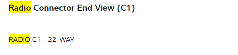

Well every time the pioneer is put in the car shows a red dot under the 60 mph and when that shows the next time I try to turn on the car it doesn’t turn on. Just all lights flash. When the factory radio is put in no red dot pops up and the car runs fine.
Jun 9, 2019 at 1:18 AM
SCGRANTURISMO
  • 4,897 POSTS
Hello again,
How are the connections to the pioneers electrical connector or the pioneers wiring) made?
Thanks,
Alex
2CarPros
Jun 9, 2019 at 6:02 AM
DORADO
  • 6 POSTS
I had someone wire them for me. Came with a kit.
Jun 9, 2019 at 8:08 AM
SCGRANTURISMO
  • 4,897 POSTS
Hello again,

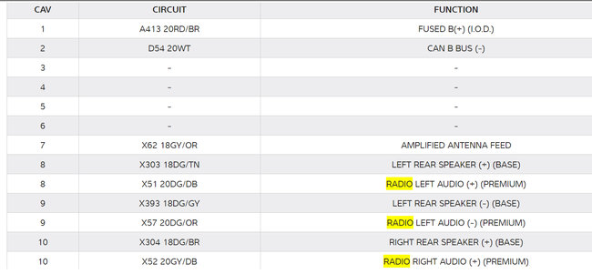

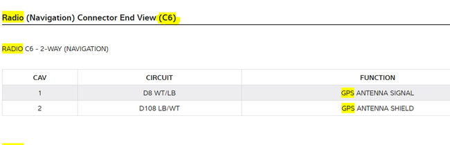

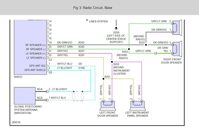

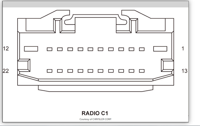

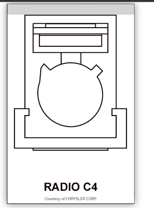

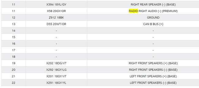

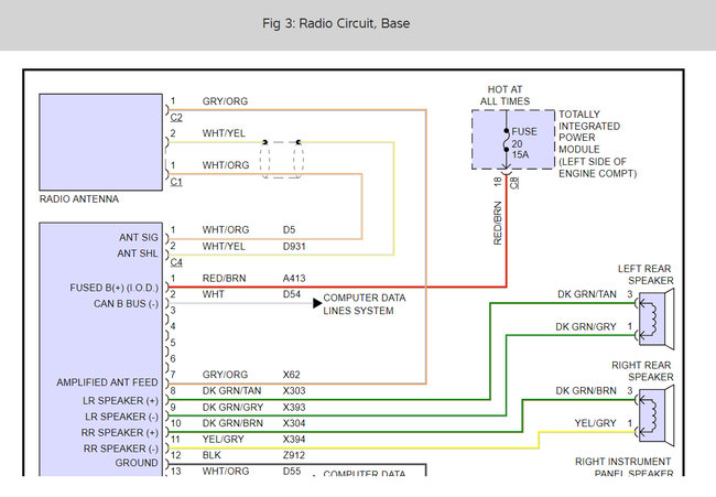

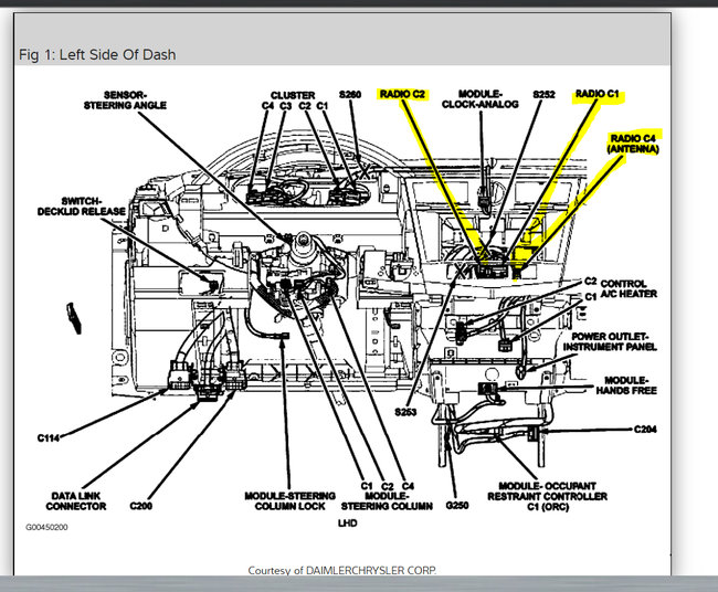

Okay, I have a 1997 Mustang GT. When I bought it it still had the Original Equipment Manufacturer(OEM) cassette tape deck in it. Needless to say I was going to change it out. I have a very nice Kenwood CD player in it now, and even though it is not a state of the art MP3 player, it is still more my speed. Anyway, when I was installing it I went to the nicest car stereo store in my area, authorized Kenwood, Sony, Alpine dealers, etc..I bought a connector that went in between the OEM connector and the Kenwood connector and made it possible to install the Kenwood head unit with no wire splicing involved. I paid $75.00 for the connector ten years ago. After three days of wondering what the heck I was doing wrong because I could not get my stereo to work, it finally dawned on me that this special connector that I paid $75.00 for at the nicest car stereo store in my area was not the right one. The pins did not match up like they were supposed to. So after all of that I wound up splicing into the power wires and running speaker wire myself, and my stereo has worked ever since.
Having said that I have included wiring diagrams for your vehicle's OEM stereo, and connector pinout diagrams in the diagrams down below. You might want to compare them to the connector that came in your kit and make sure that the pins are lining up. Please get back to us with what you are able to find out.

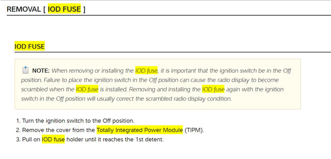

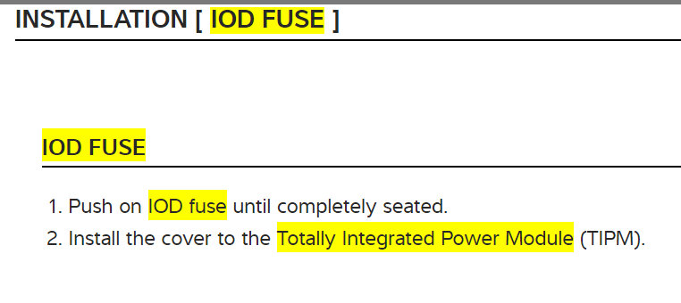

I’m not worried about the Pioneer radio anymore. I’m keeping the factory one there. But the factory one doesn’t turn on. When messing around with the IOD fuse the radio screen flashes like it wants to turn on but then it doesn’t.
Jun 10, 2019 at 7:26 AM
DORADO
  • 6 POSTS
The next thing I’m thinking about doing is replacing the fuse box. Is that a good idea?
Jun 10, 2019 at 10:36 AM
SCGRANTURISMO
  • 4,897 POSTS

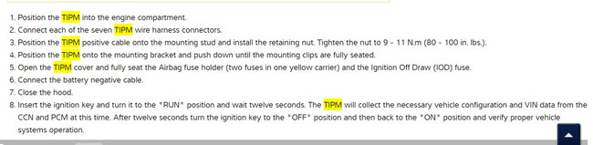

Hello again,

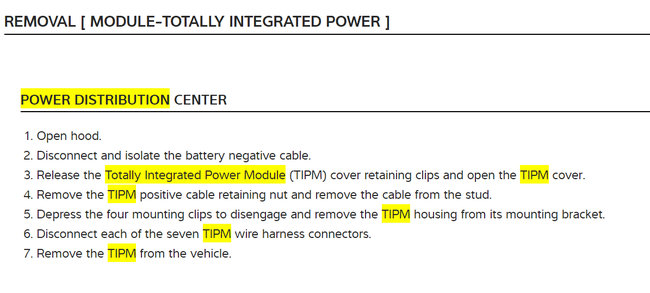

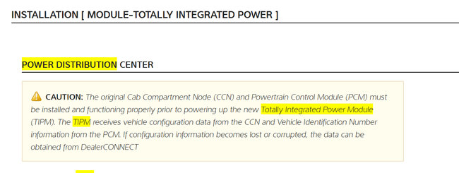

This does sound like you have a loose wire coming from the fuse or that the pins are not making good contact with the female connectors on the fuse location. This could also possibly be the IOD fuse. I have included instructions for the removal and installation of the IOD Fuse and the Totally Integrated Power Module (TIPM) in the directions down below. I would not recommend the removal and installation of the TIPM because the Power-train Control Module (PCM) and the Cab Compartment Node (CCN) must be installed and communicating with each other before you can hook up the battery and provide power to the TIPM.
Please go through the guides that are in the diagrams down below and get back to us with what you find out.
Thanks,
Alex
2CarPros
Jun 13, 2019 at 1:19 PM
DORADO
  • 6 POSTS
I changed both iod fuses and that still didn’t work.
Jun 14, 2019 at 3:15 AM
SCGRANTURISMO
  • 4,897 POSTS
Hello again,
Check the hole where the IOD Fuse plugs into. Make sure the female connector is getting good contact with the fuse.
Thanks,
Alex
2CarPros
