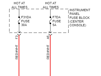

There are a total of 4 fuses to check.
All are located in the instrument panel fuse block.
Your problem sounds like the audio amplifier is no longer powering up.
This is controlled by fuse F31DA(30A).

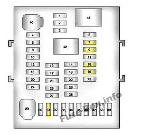

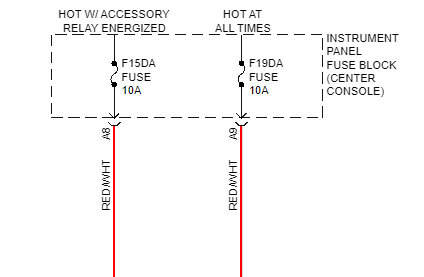

See image 2 below I marked the fuses which supply the infotainment system, marked in yellow. Note that not all fuses might be present, depending on the vehicle's equipment level.
A good source of fuse information:
https://fuse-box.info/chevrolet/chevrolet-equinox-2010-2017-fuses-and-relay
With display I assume you are talking about the info/navigation display?
Fuse F15DA (10A) supplies power to this module

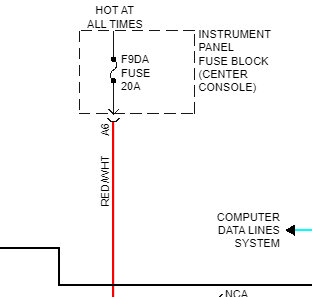

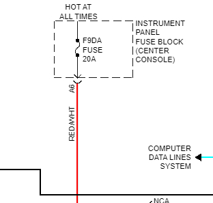

Also while going over the wiring diagrams, I found another fuse, fuse F9DA (20A).
I would think that this is the fuse which you had checked in the beginning, see image below.
