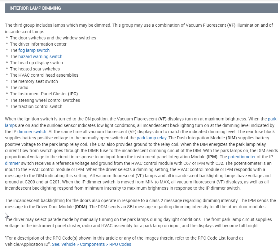

Display on my radio works in sunlight but cant be seen in the dark

Do the rest of the dimming features work as described in this attachment?
If the rest of the back lights dim properly then that means the issue is just in the radio lighting and most likely needs to be replaced.
The experts that answer these questions are located all over the United States, so there may be some in Ohio but unfortunately our services are limited to answering questions here on the website.
Let me know what you find and we can go from there. Thanks
