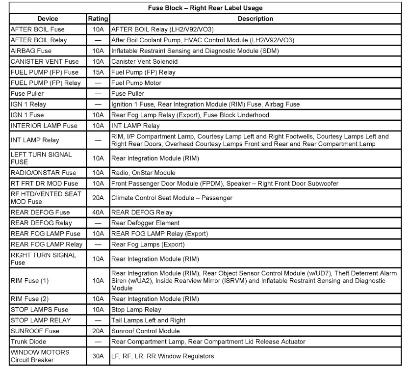

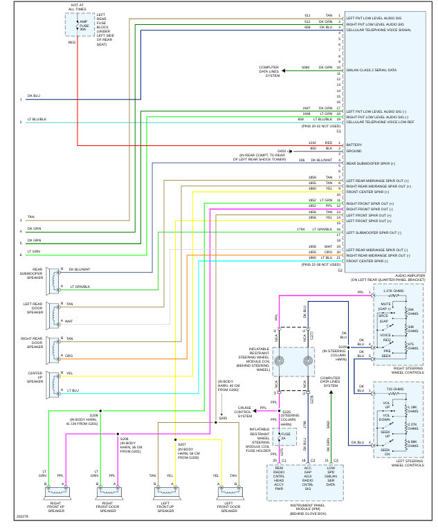

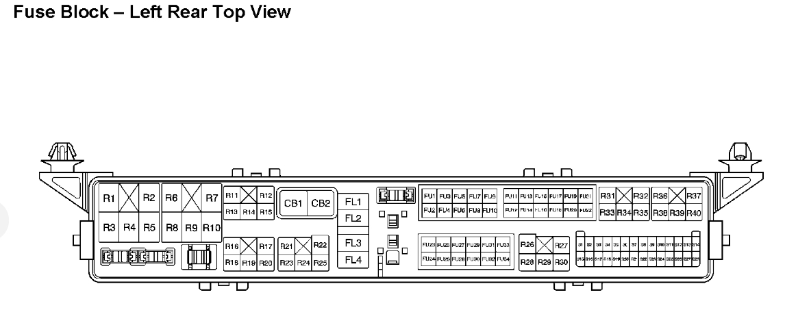

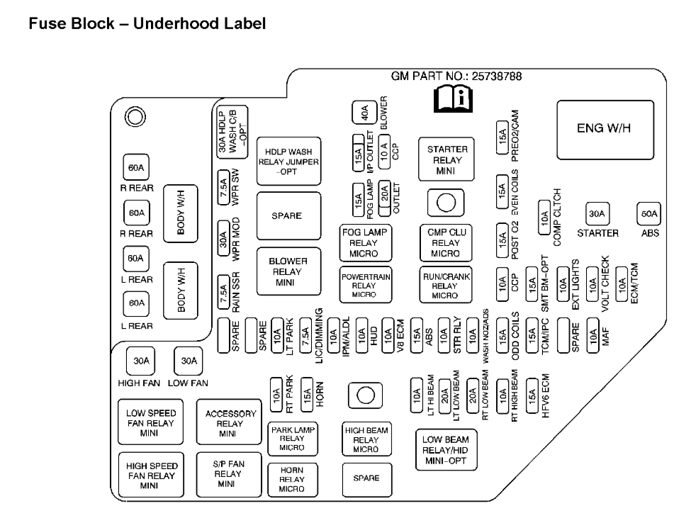

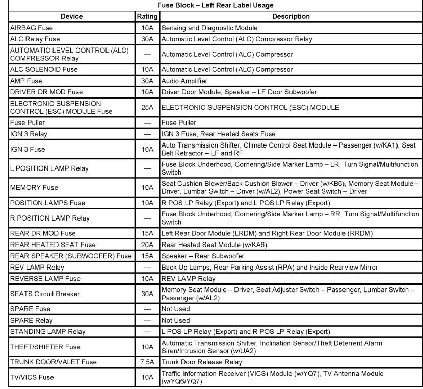

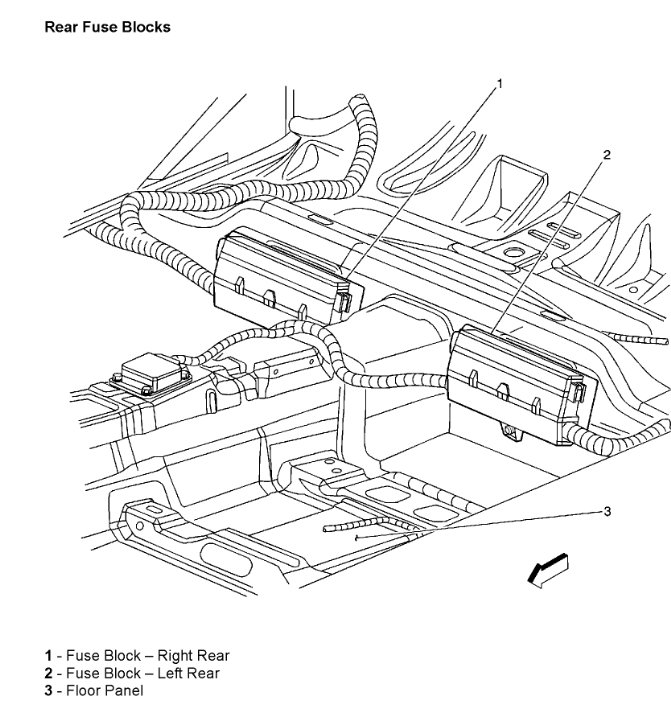

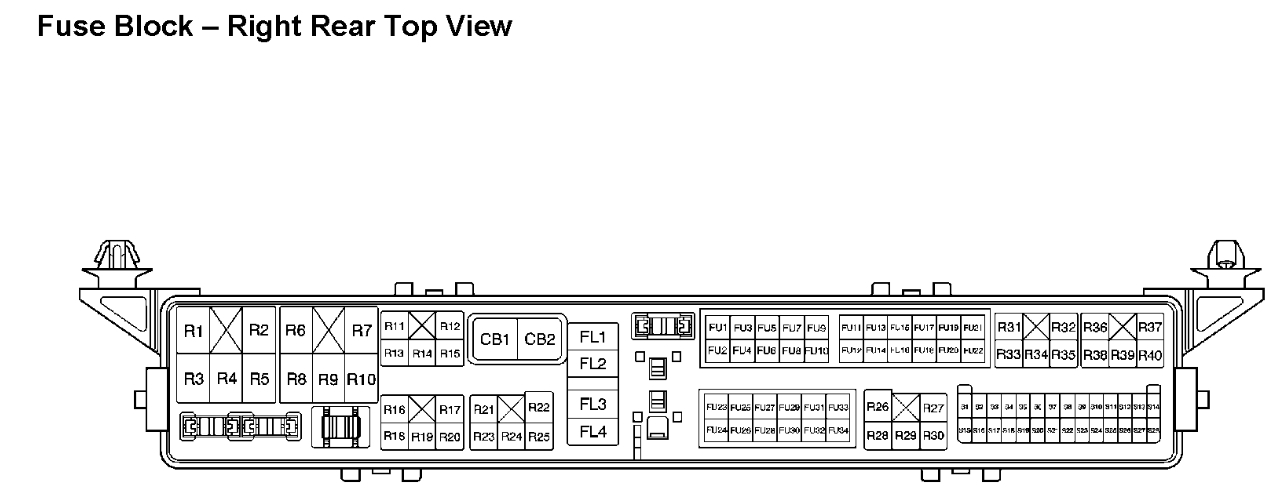

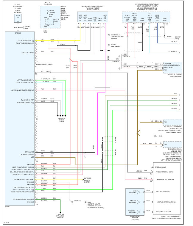

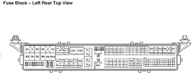

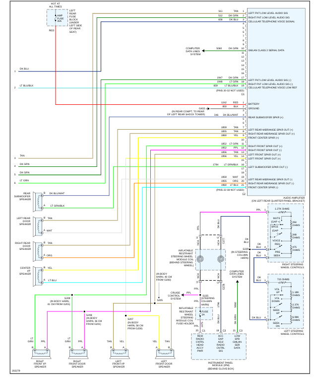

It’s like there’s no power. I checked the radio/OnStar fuse it appears to be fine I even pulled the head unit looking for fuses on it. strangest thing I could hear the fan inside the head unit running.
Jan 1, 2020 at 6:01 AM
TOUGHDIVER
  • 226 POSTS
Hi, Billy Joe.
Your radio has it own fuses I'm attaching radio wiring diagram and fuse block locations below for the radio,
Check it out and see if there the same fuses you checked, If the fuses are okay check power and ground at the radio connectors. Please let us know if this info. is helpful and what corrected the problem.
