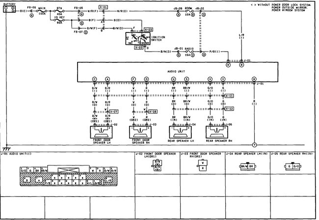

Wanting to replace stereo with after market unit without buying a new wiring harness. Looking for a diagram of the existing wiring so I can match all wires correctly. Thank you.

Here's the diagram for the radio. This is the only version they show. There's nothing that uses a remote amp from the factory, so you don't have to worry about that.
If you find this hard to see, I can cut into two pieces and enlarge them for you, or you can and paste it into an MS Word typing program where it can be expanded larger.
