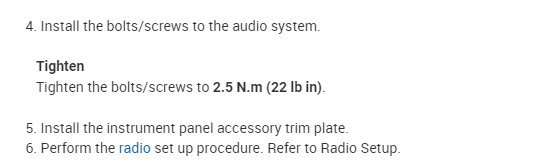

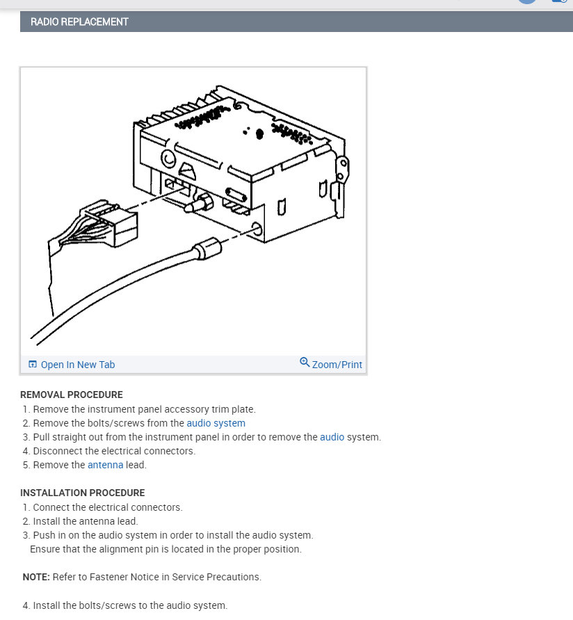

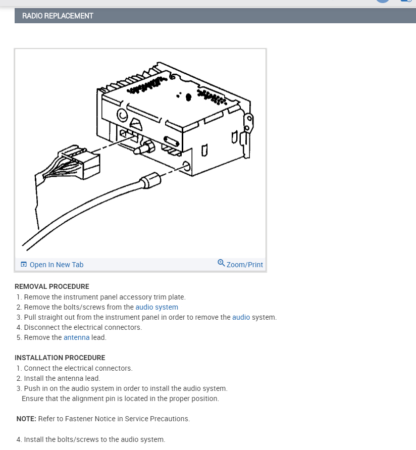

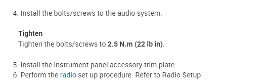

I need to know how to replace the radio of my car can you help me please?
Mar 25, 2020 at 9:34 AM
I assume you are looking for the process on how to replace the radio. I attached it here for your review. Let me know if you needed more info or different info.
