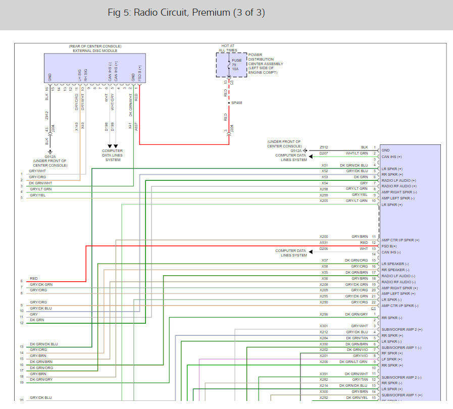

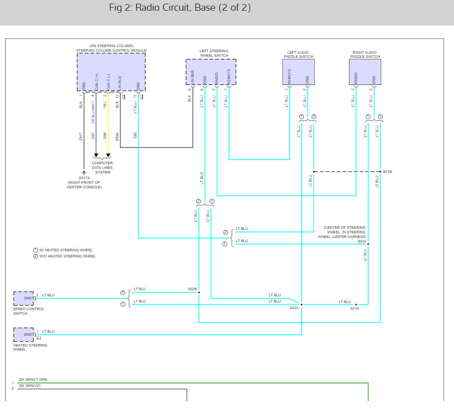

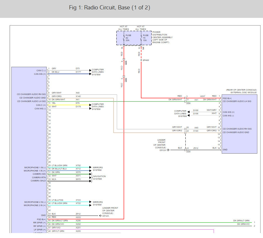

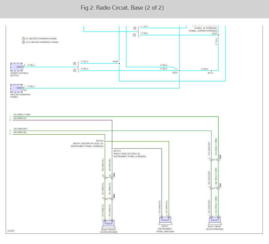

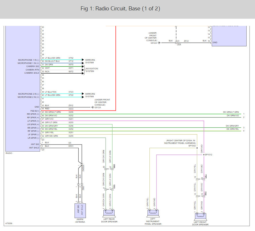

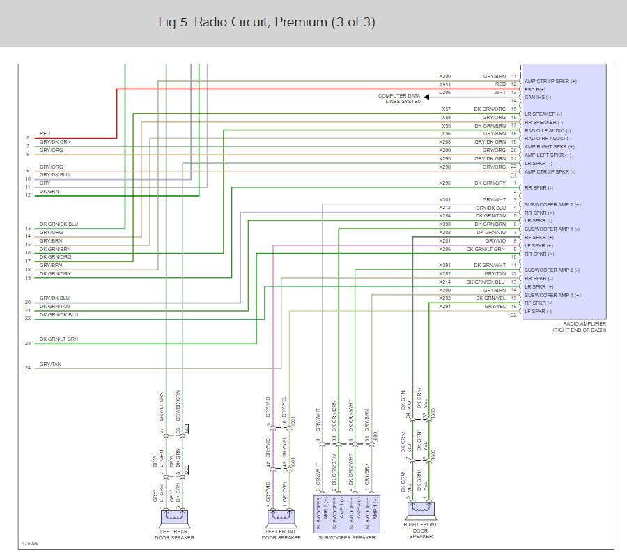

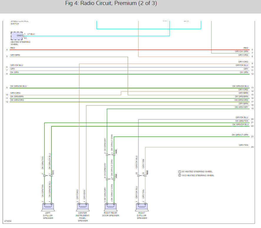

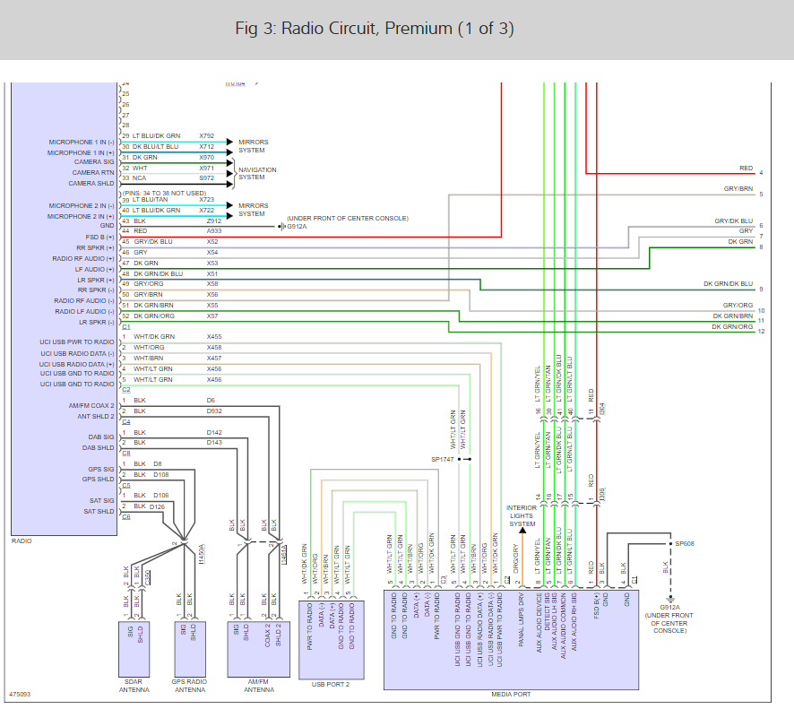

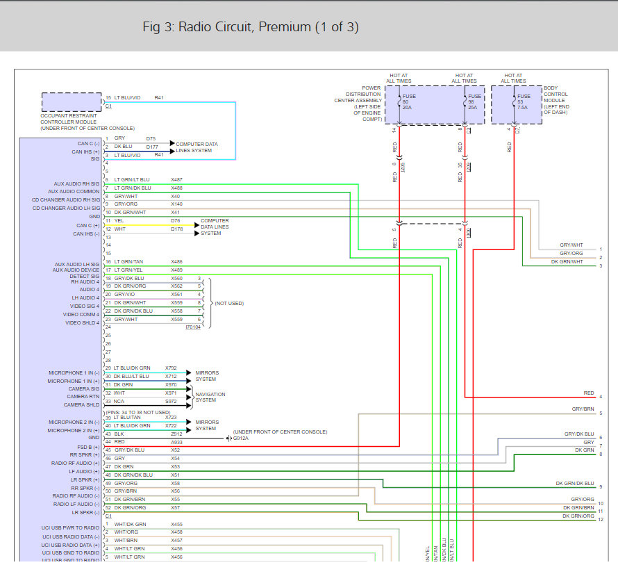

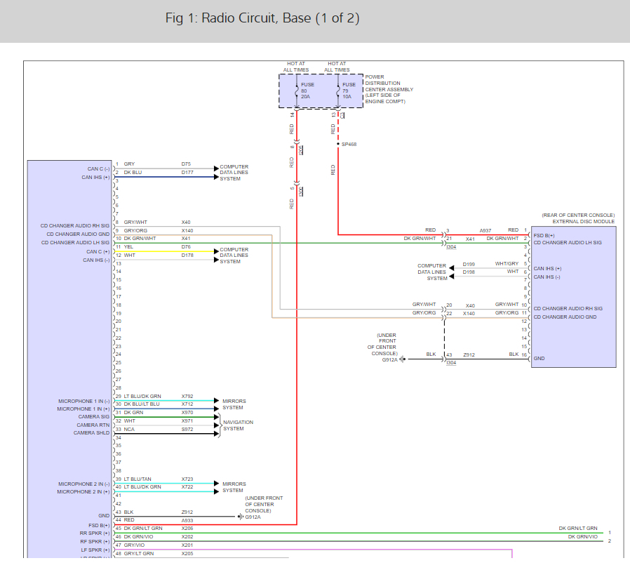

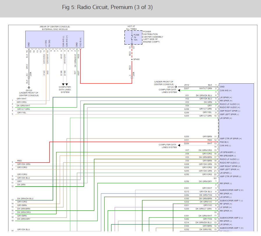

I have terrible AM band reception. My FM and XM are perfect.
Aug 10, 2018 at 2:38 AM
  • 55,746 POSTS
It sounds like you have a problem with the AM portion of the radio which with vary depending on which radio you have. Here are the radio wiring diagrams for both unit is case. Here is a guide to help you test the wiring to confirm the failure, check the black antenna wires:
