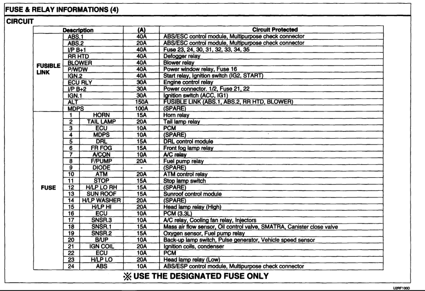

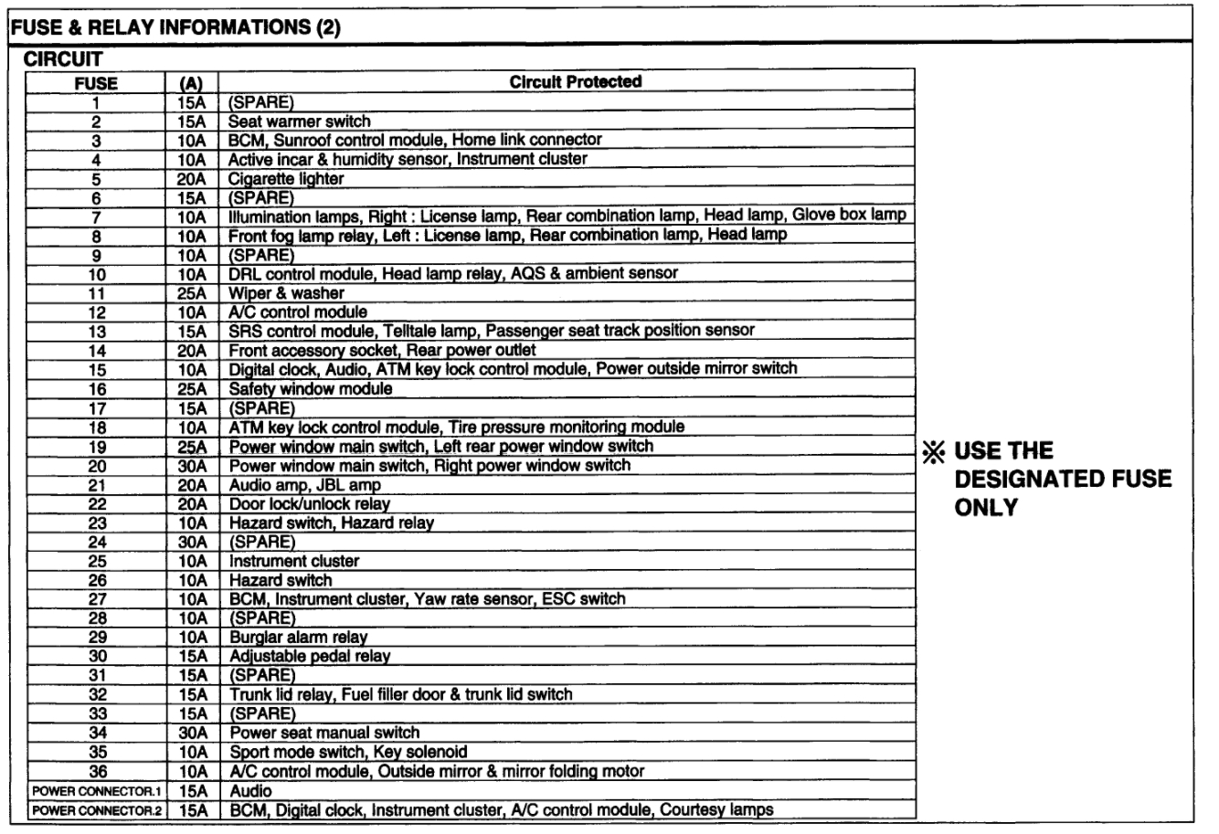

I recently but a new alternator in my car, but now my radio comes on but no sound at all. What do I do?
Mar 19, 2023 at 10:02 AM
  • 55,433 POSTS

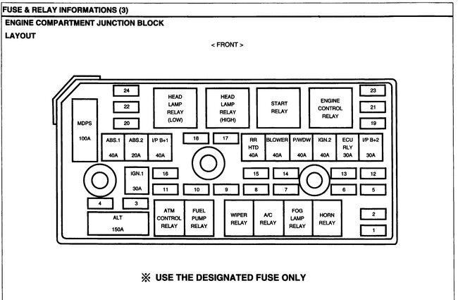

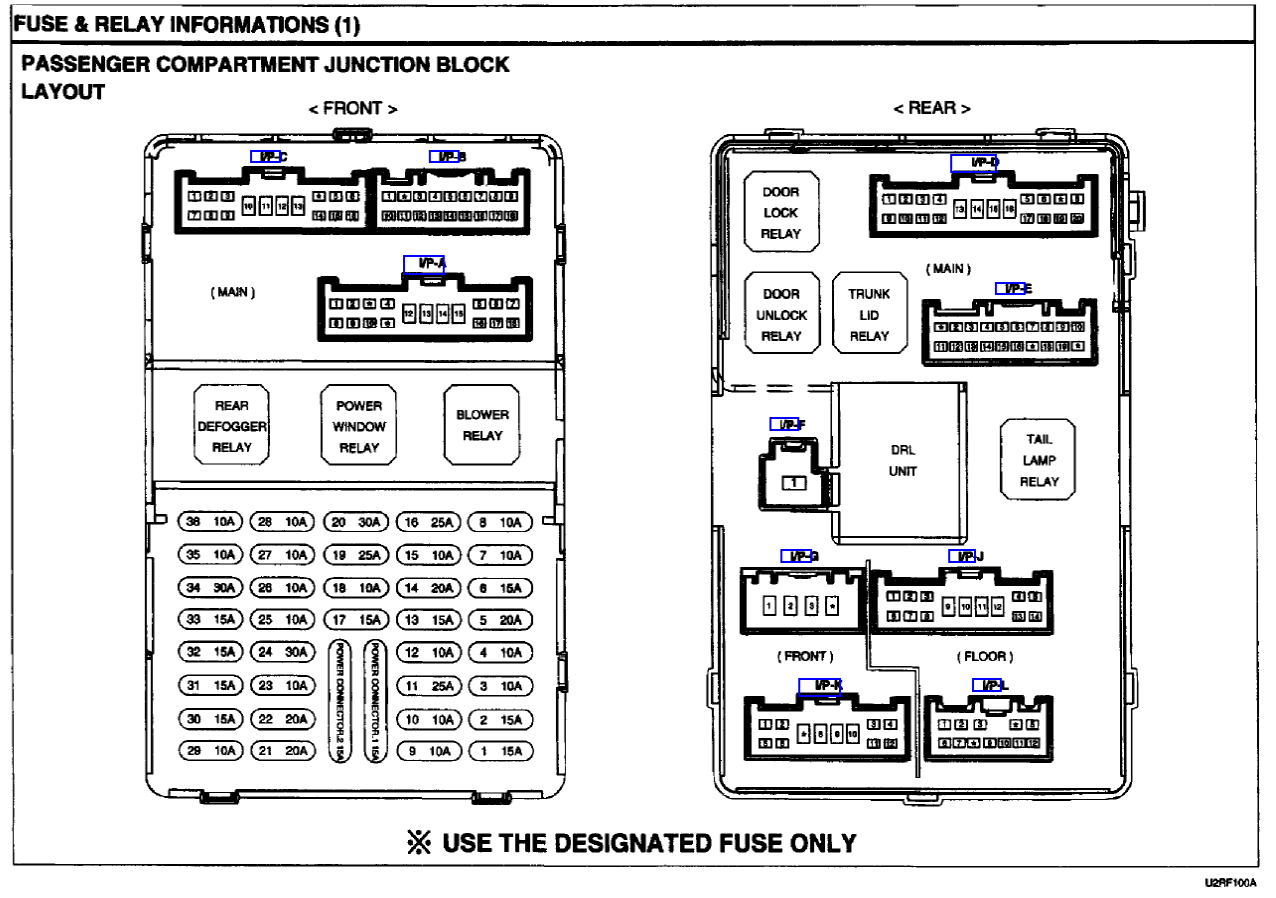

It sounds like you had a voltage surge when reconnecting the battery, I would start by checking the fuses. here is a guide to help please check the fuses with the key on and I have included the fuse locations in the images below.
