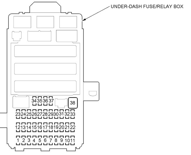

BOB BELL

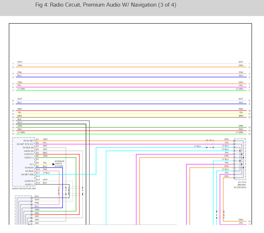

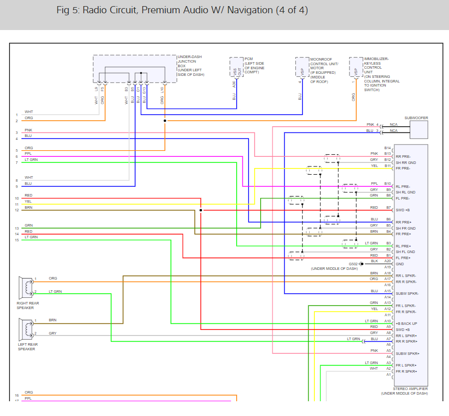

A/C quit. radio required the code but battery had not been disconnected. I have had A/C repaired. The controls on radio are now reversed, off/on volume now on the right whereas they were were non left I cannot set time or use the preset FM stations or any stations at all. I am able to set to 88.9 and use my Sirius but nothing else worthwhile. This is a real puzzle I have removed battery connection and used the code but that didn't help. I have played with all controls bass and treble etc., are now on left use to be on right.
Aug 3, 2019 at 2:38 AM
  • 55,423 POSTS

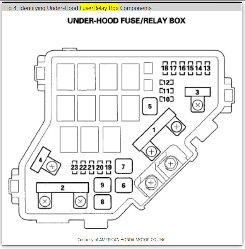

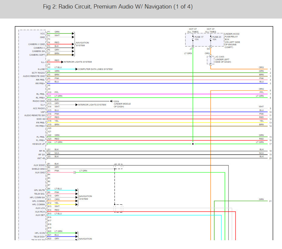

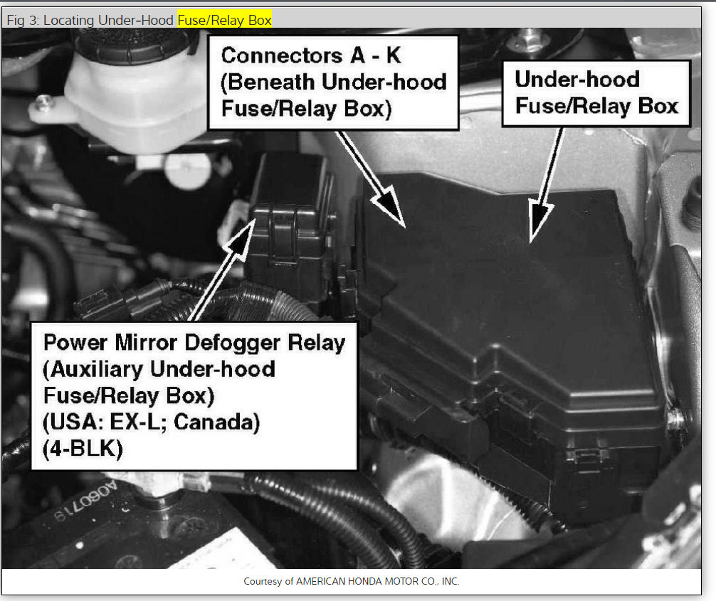

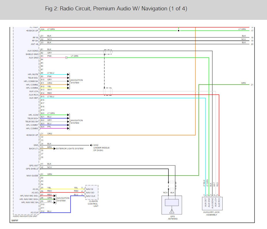

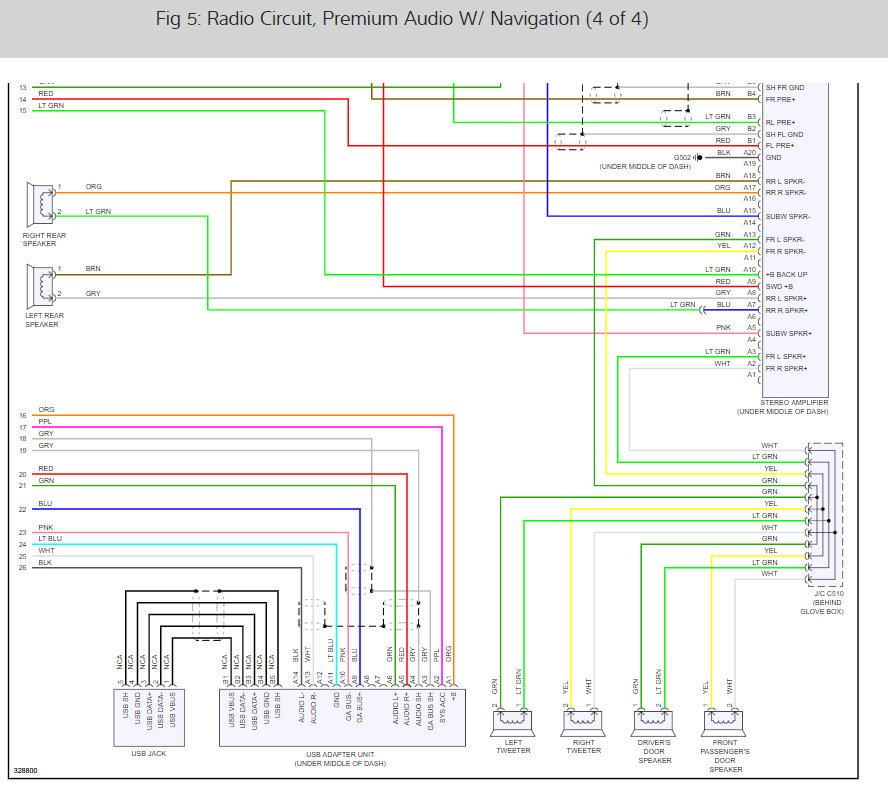

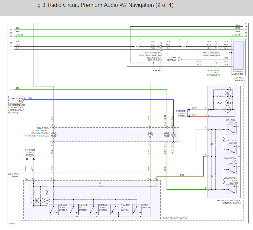

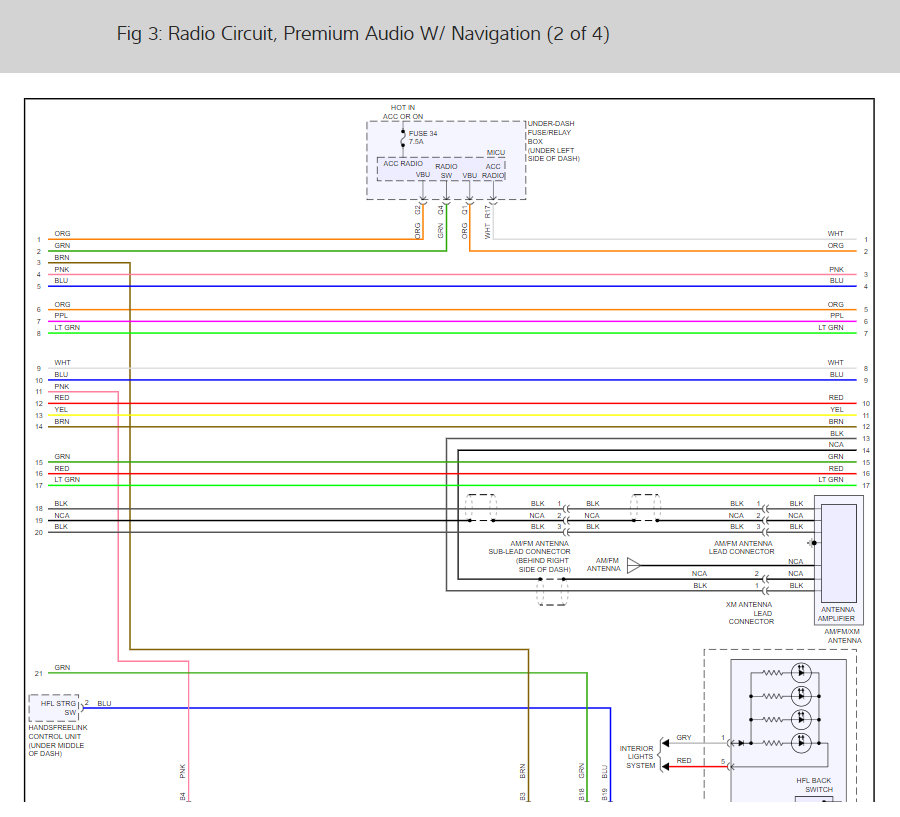

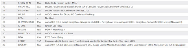

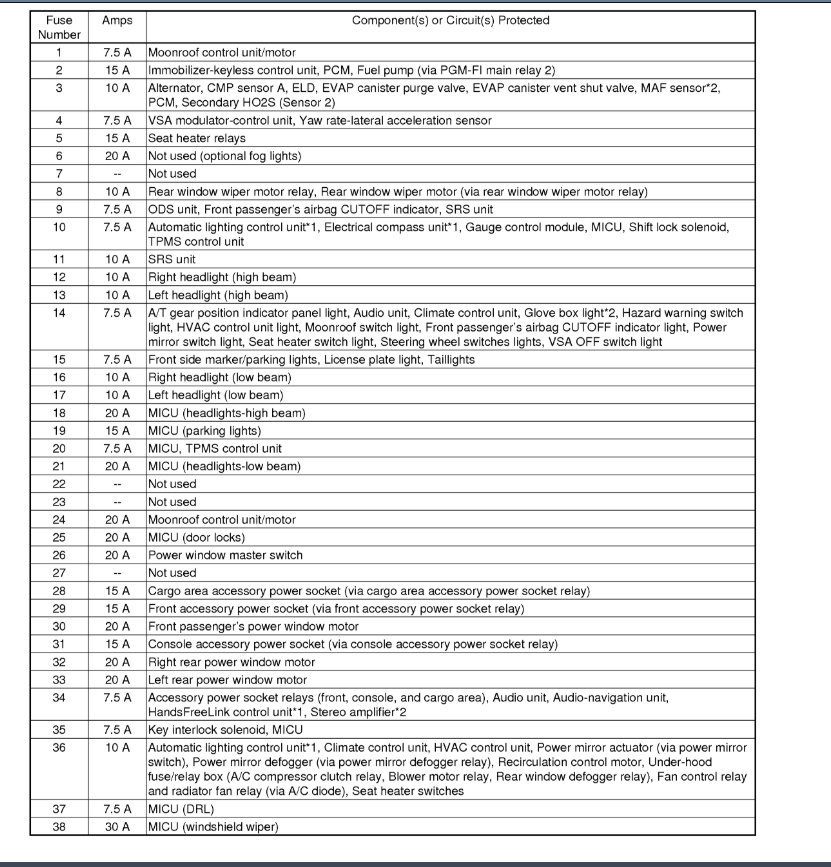

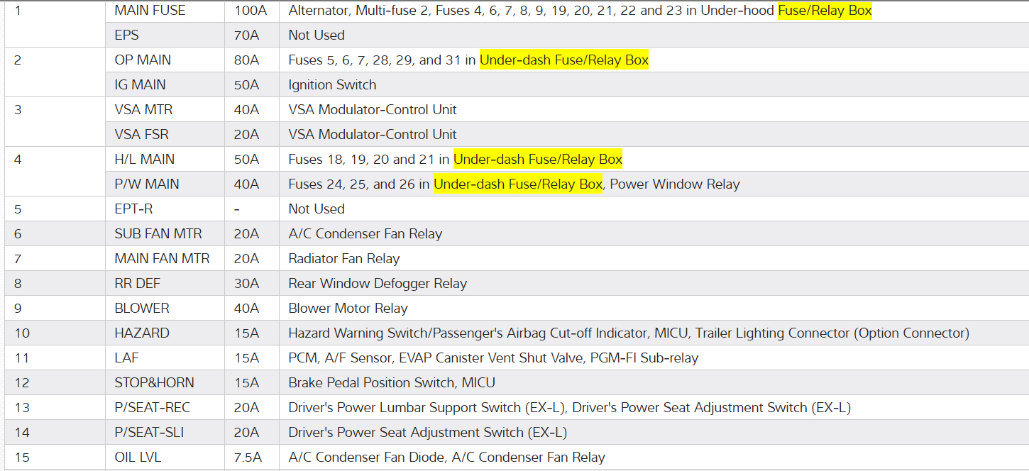

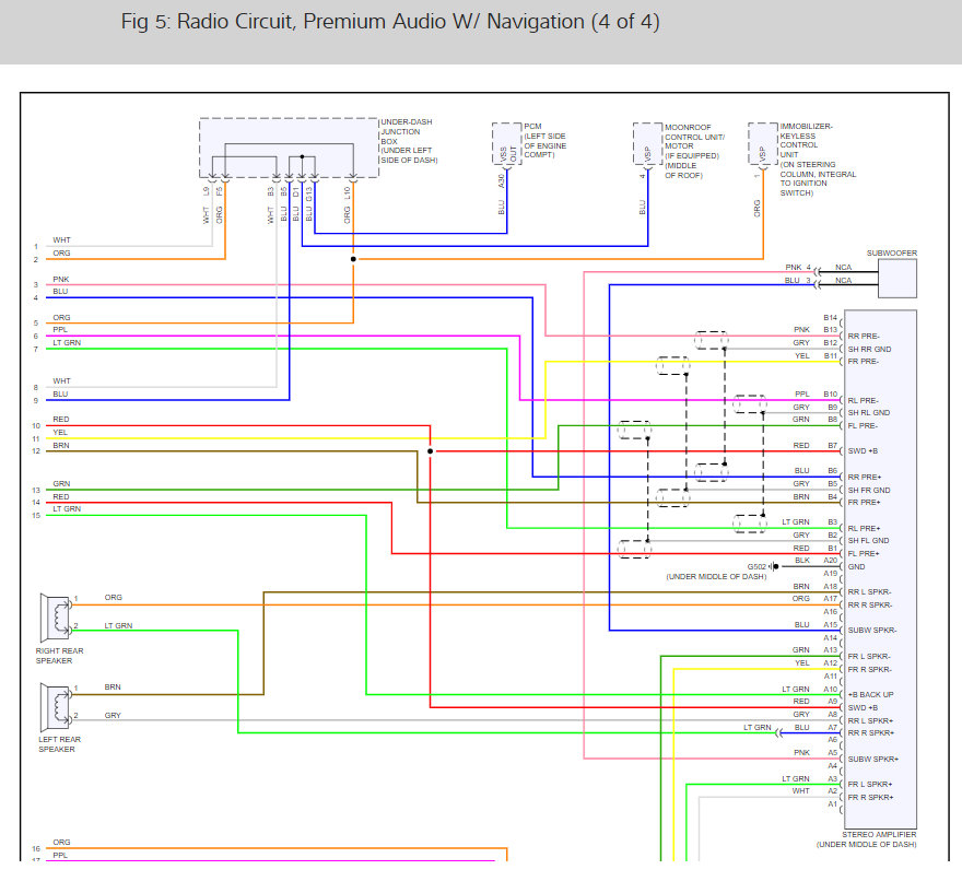

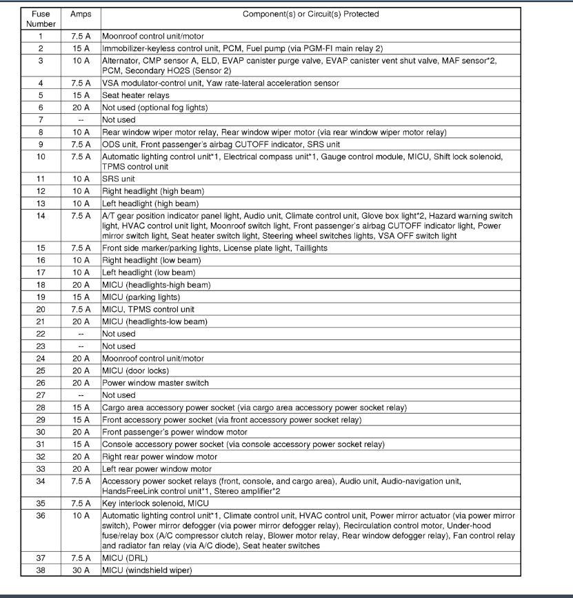

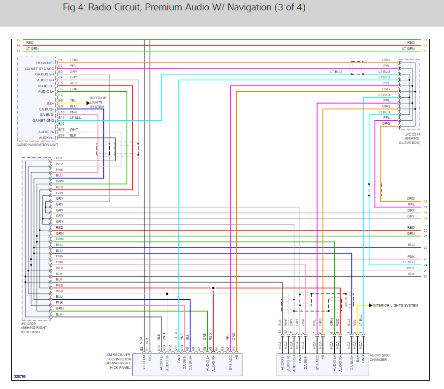

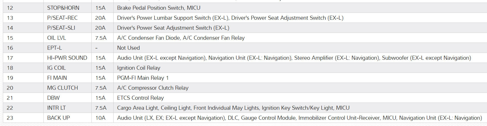

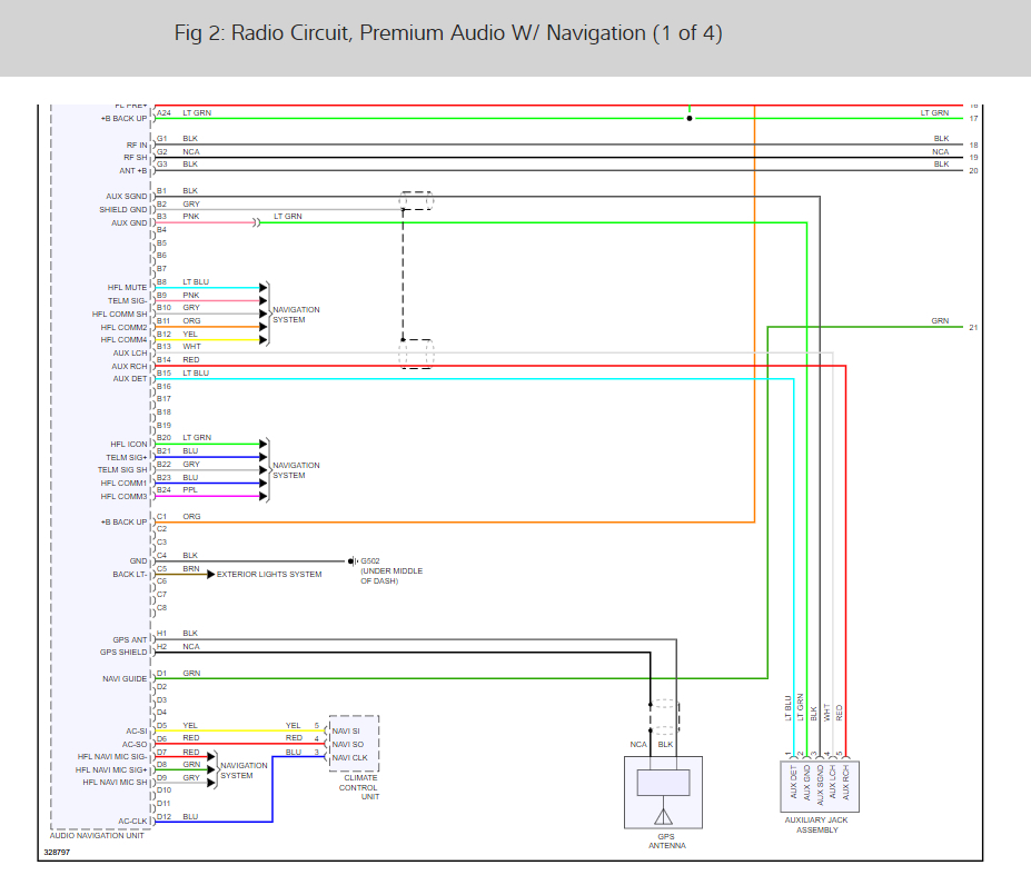

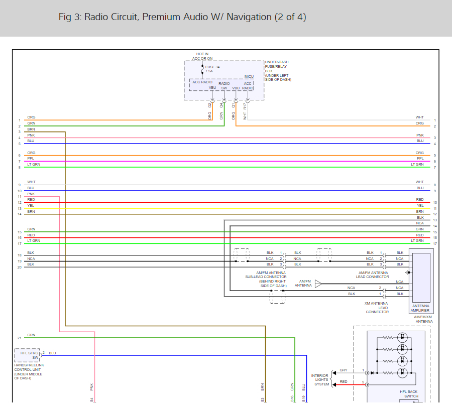

It sounds like the memory module inside the radio has gone bad not holding it program. We should check the fuse though to be sure. Here is a guide to help check the fuses with the fuse locations and radio wiring diagrams so you can see which fuses to check and how the radio system works:
Check out the diagrams (below). Please let us know what you find.
