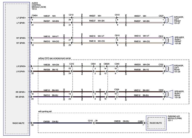

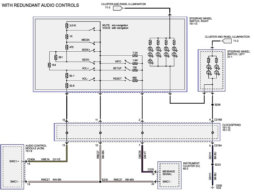

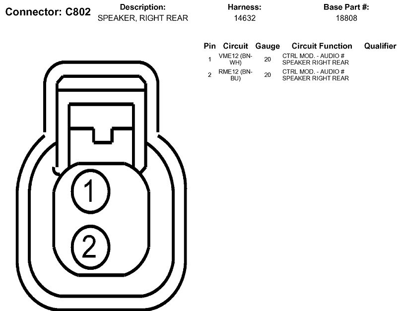

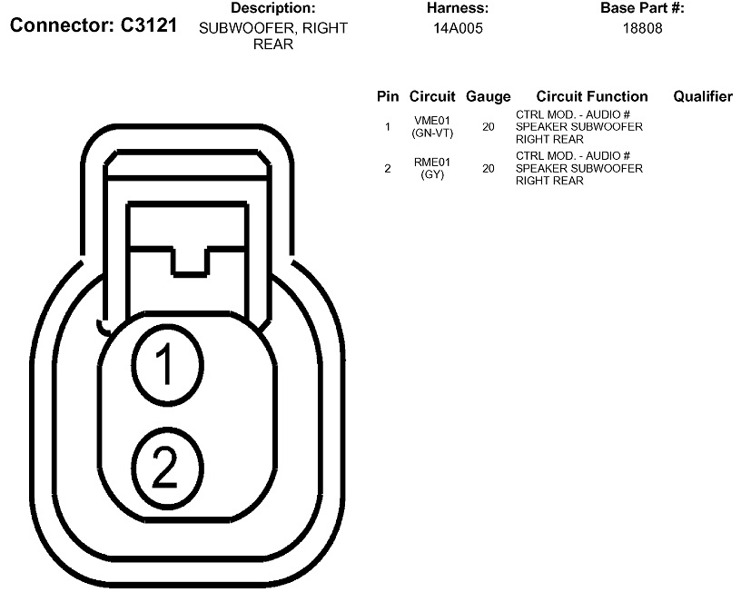

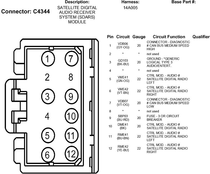

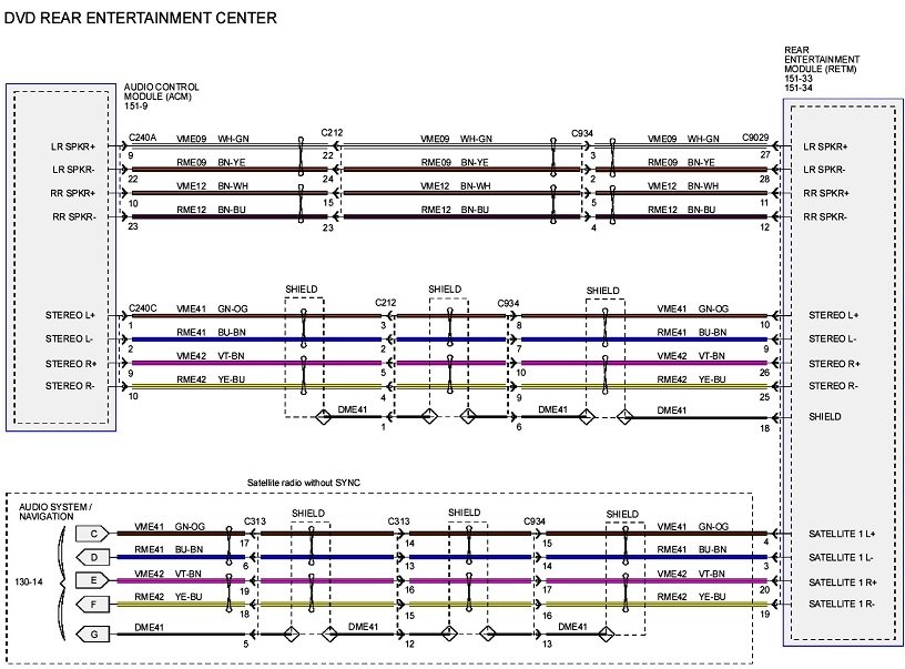

Can I get an accurate wiring diagram for the stereo?
2008 FORD TAURUS
230,000 MILES • 6 CYL • 2WD • AUTOMATIC
SAINTLYOAK

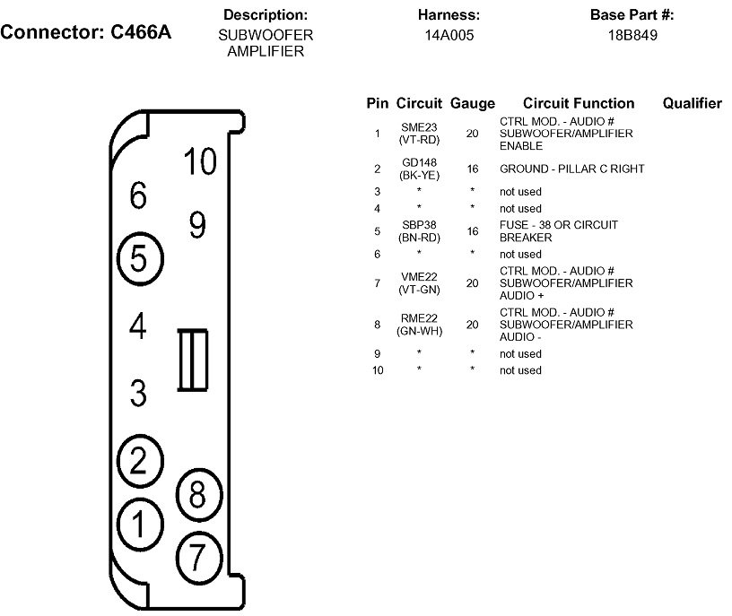

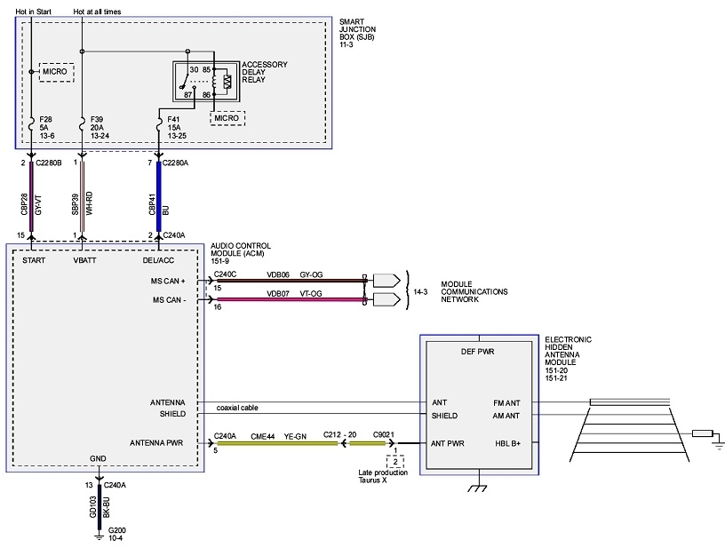

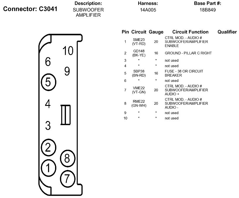

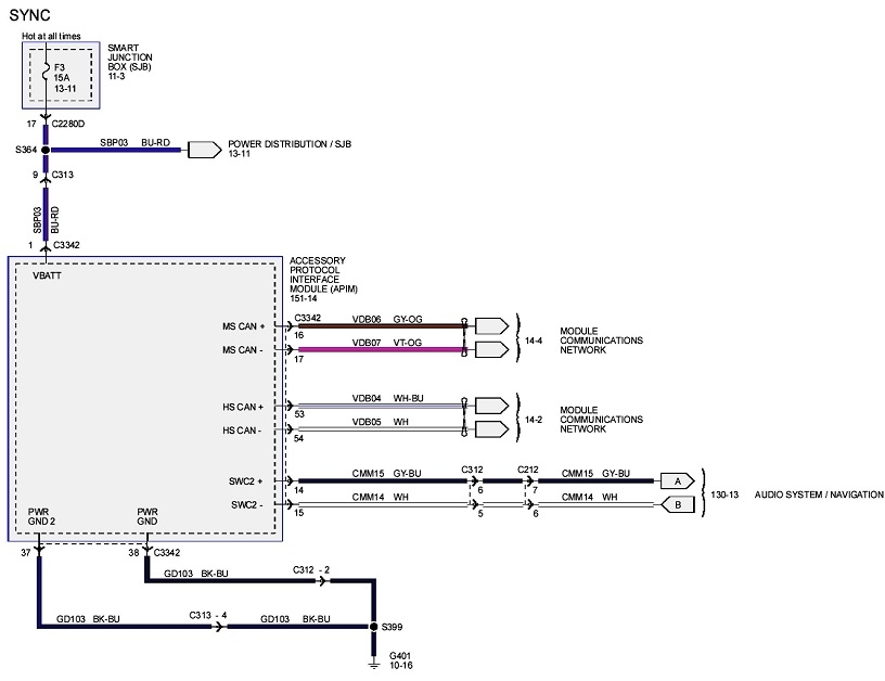

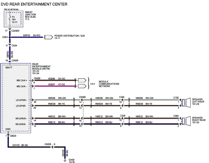

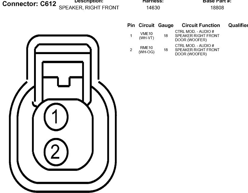

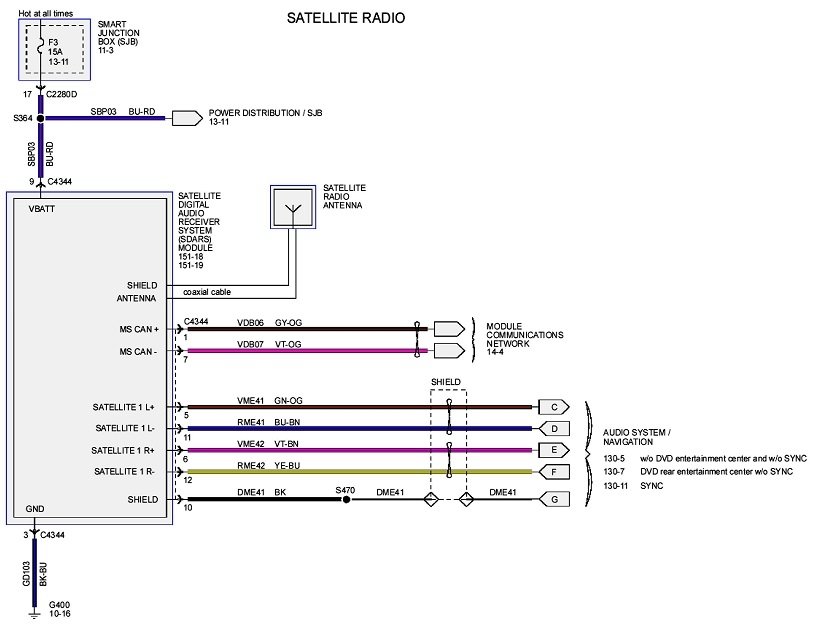

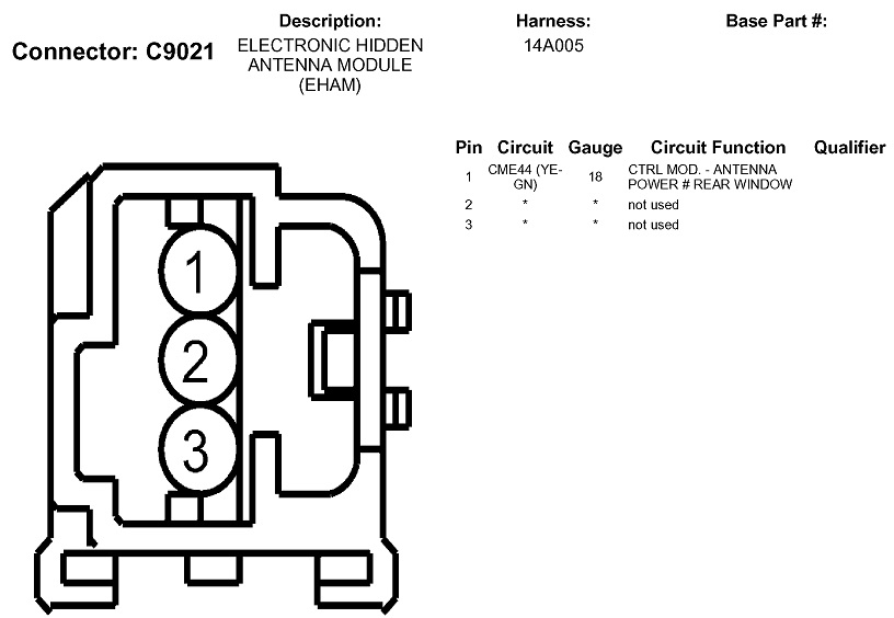

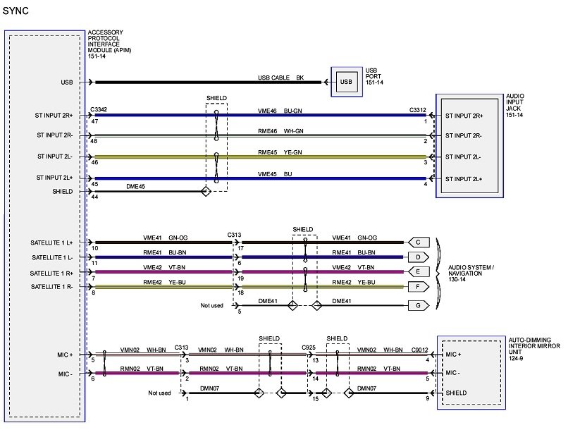

I’m trying to hard wire an aftermarket radio but can’t find an accurate wiring diagram.
Sep 3, 2022 at 5:51 PM
CARADIODOC
  • 34,381 POSTS

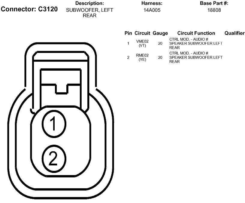

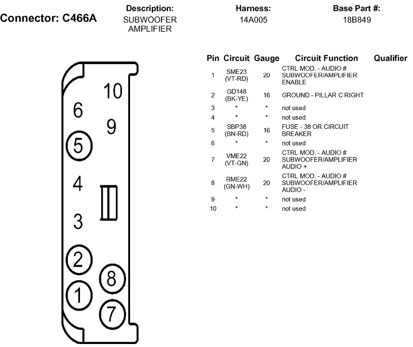

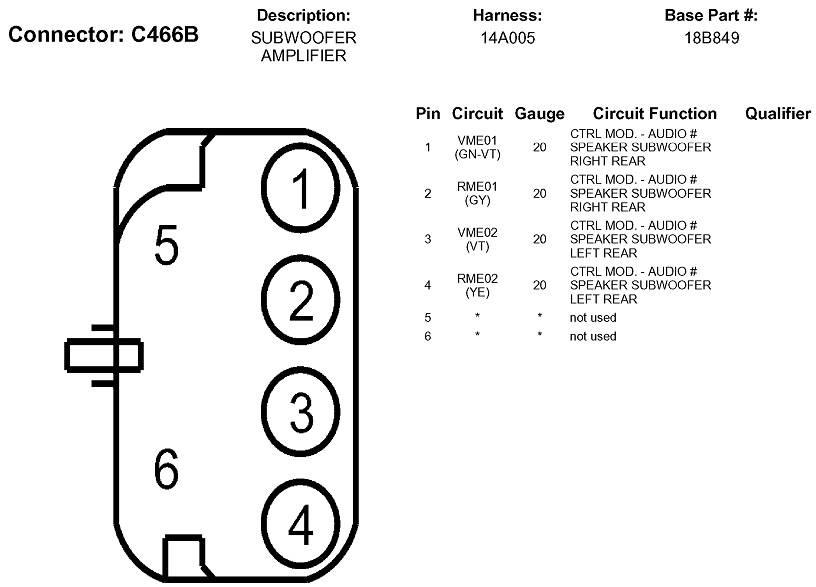

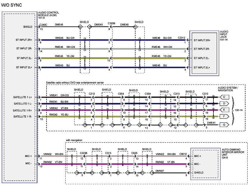

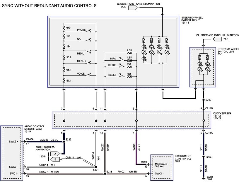

I included the connector views with wire colors. If you find any diagram hard to read, you can copy and paste them into a typing program such as MS Word, then resize them, or I can cut them into smaller pieces and expand them for you.
