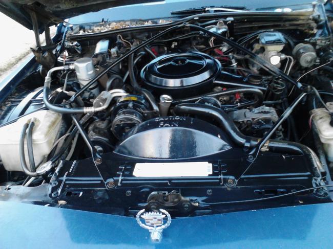

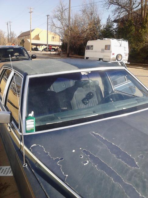

I saw this car and fell in love. I have a 1989 cadillac brougham. Its a little beat up but just needs some t.l.c. I've fixed multiple things on it so far. Now that I'm broke I'm trying to fix cheaper things. When I bought it I noticed the radio and tape player didn't work which I didn't mind. One day while workin on it with the door open the tape player came on. I closed the door and it s*** off. I fixed the problem but now just the tape player works there's no radio but I do get static also it doesn't light up. I was wondering how to go about fixing this. Is it the antenna? Any input anyone has would be great. Even if its something else you might know about a 1989 cadillac brougham like suggestions or advice I would greatly appreciate.... sorry about the long wait for me to get to the point I just love this car. I put a couple of photos up of some of the work I've done on it. I could not believe the difference off the roof after fixin it up that pic shows half fixed and half the way it looked when I bought it. I used a tutle wax product.
