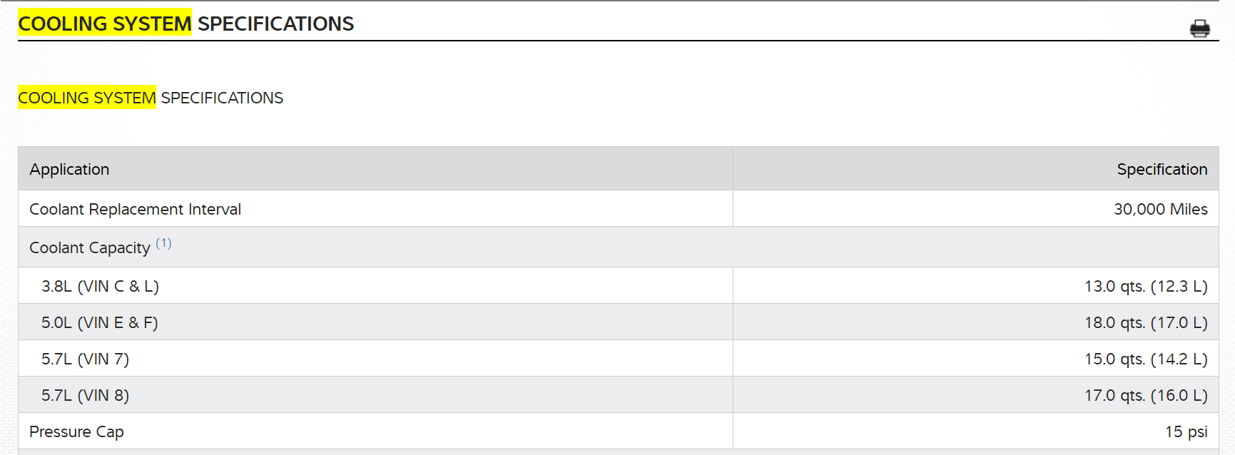

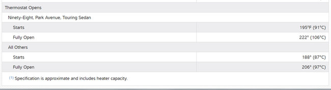

I just replaces my radiator and filled the fluids how I was told making sure the air is out, but my cars temperature goes to 220-230 then drops to 199.
Mar 9, 2019 at 3:37 AM
SCGRANTURISMO
  • 4,897 POSTS
That is normal. When you include anti freeze in your cooling system it ups the boiling point of just water past 212 degrees. I have included the cooling system specs for your car in the diagrams down below.
