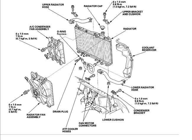

Can I replace a radiator in my car (listed above) that is leaking with the radiator in my 2002 manual Honda civic? are they the same?
Sep 29, 2017 at 1:19 PM
Experienced Mechanic
55,766 POSTS
I believe so.
Here is a guide to help you get the job done by showing you what you are in for:
https://www.2carpros.com/articles/how-to-replace-a-car-radiator

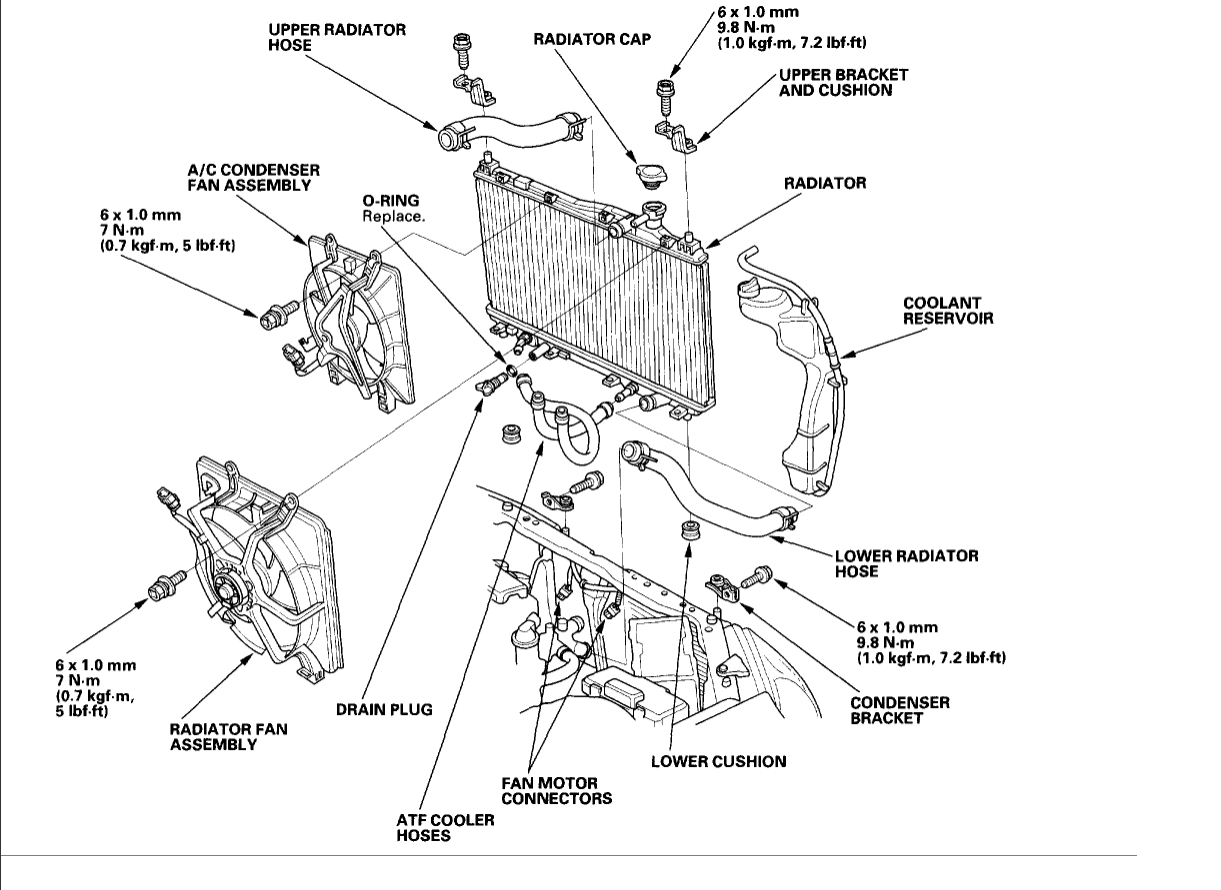

Here are some diagrams of what it will be like on your car (below).
