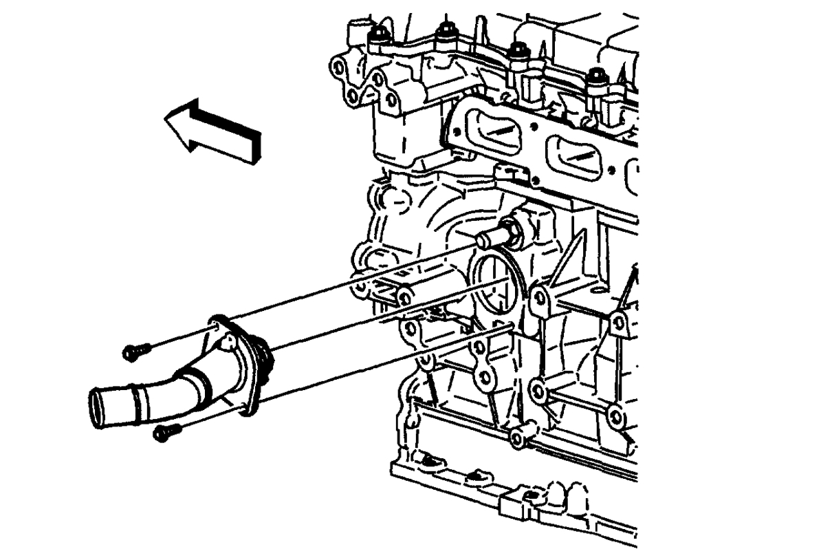

I replaced the old cap with a new one but still overheating. I noticed that it has a small leak on top. What's the best seal solution for this problem?
Feb 3, 2021 at 1:13 AM
Good afternoon,
Where is the leak coming from? I would pressure test the system first to determine the location.
https://www.2carpros.com/articles/engine-overheating-or-running-hot
https://www.2carpros.com/articles/radiator-pressure-test

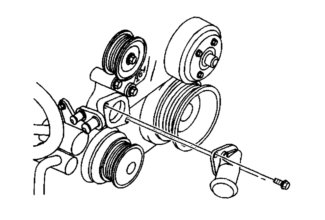

It could be the thermostat causing the overheating. I would start there.
Thermostat Replacement (5.3L Engine)
Removal Procedure
Important: The thermostat is not serviceable separately. The water pump inlet and thermostat must be replaced as an assembly.
1. Remove the radiator outlet hose.
2. Remove the water pump inlet bolts.
3. Remove the water pump inlet and thermostat from the water pump.
