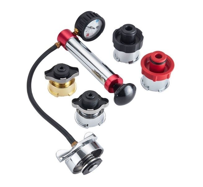

The absolute thing I would do first is a coolant pressure test. This will show if you are losing coolant externally or internally. I am adding an article for you to help aid in doing this test. I will also add a picture of the tester.
Here is the article:
https://www.2carpros.com/articles/radiator-pressure-test
When conducting this test, pump it up to what is on your radiator cap. Yours should be 16 psi. If you don't not see any external leaks, leave the test tester on for about a half an hour and come back and see if the needle has moved. If so, this could indicate an internal leak.
