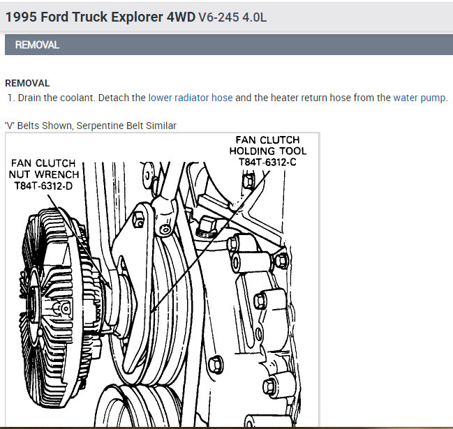

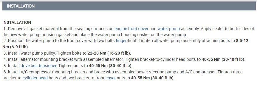

What kind of gasket sealer do I use

Here is the information you requested. I would recommend using Permatex brand Ultra Blue or Ultra Black as a gasket sealer. I've attached their pictures below. Here also is a tutorial showing how to replace a water pump:
https://www.2carpros.com/articles/water-pump-replacement

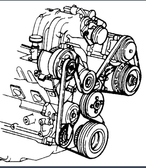

You will need to remove the serpentine belt to gain access for removal of the water pump. Here is a tutorial as well showing how to remove and replace the belt:

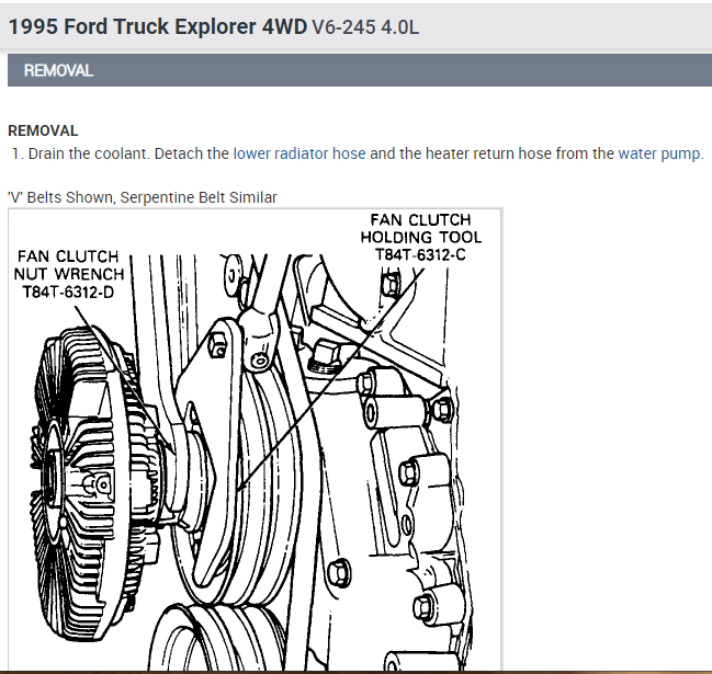

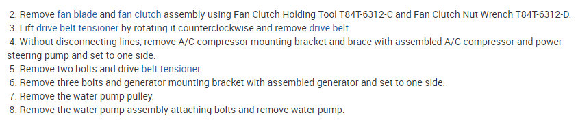

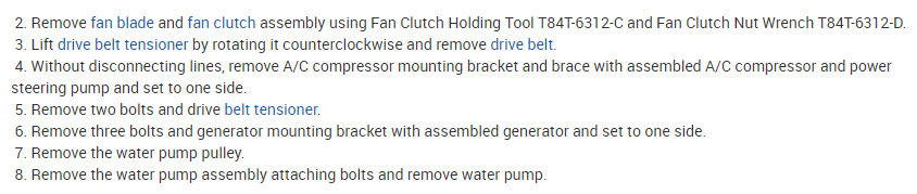

I've attached picture steps below showing how to replace the water pump on your vehicle. Hope this helps and thanks for using 2CarPros.
