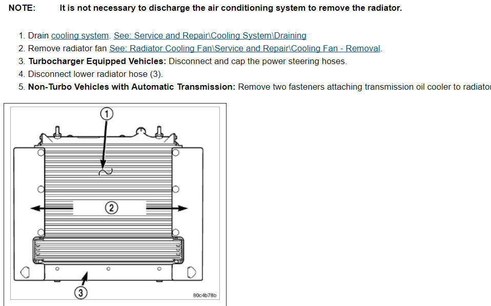

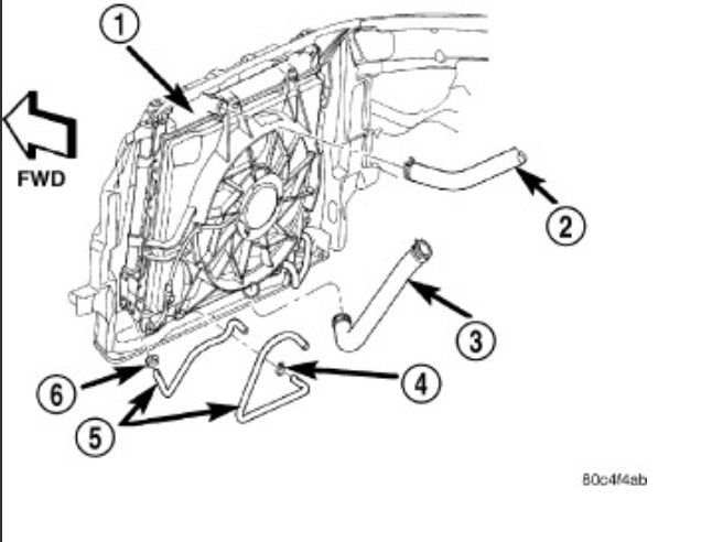

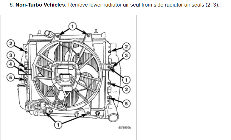

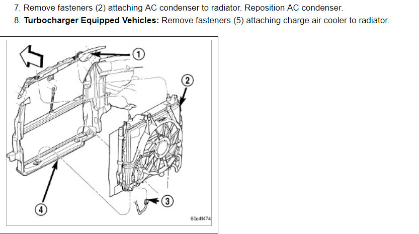

Leaking radiator. Do you have to remove the transmission and A/C lines to replace radiator.
Jan 19, 2018 at 4:18 AM
  • 55,748 POSTS
You do not need to discharge the air conditioner to remove the radiator. Here is a guide to help you see what you are in for when doing the job:
https://www.2carpros.com/articles/how-to-replace-a-car-radiator
Here are diagrams of what it will be like on your car (below).
Jan 20, 2018 at 5:23 AM
KEVINBINDEL
Thanks for the information. got it done in about two hours.
