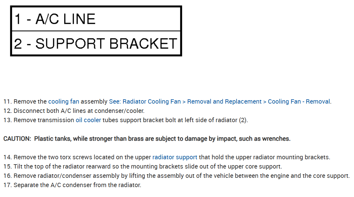

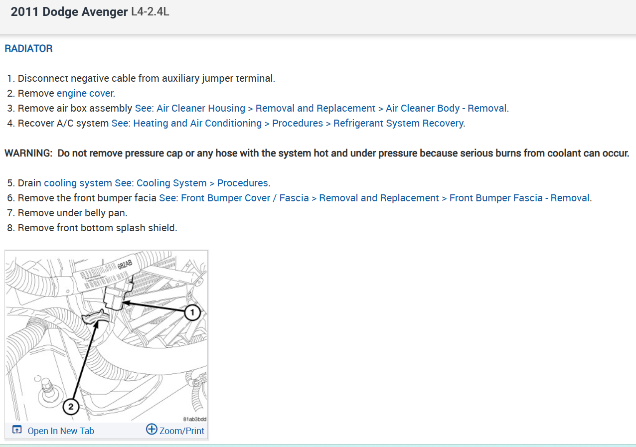

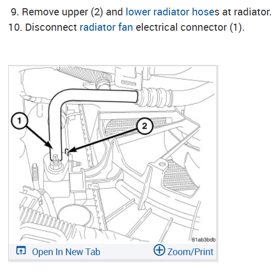

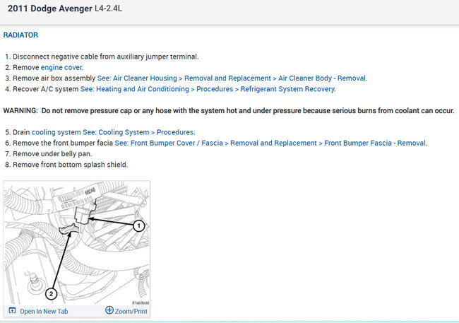

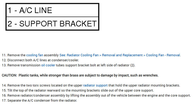

I am needing to replace radiator on my daughter's avenger and it looks complicated am needing any advice or diagrams
Aug 29, 2026 at 5:13 PM
Experienced Mechanic
55,865 POSTS
Yep, this is a tough one, it looks like you will need to vacuum down and recharge the AC system, here is a video to help.
https://www.youtube.com/watch?v=4EqdrBVb0sY
The instructions for the radiator removal are below.
