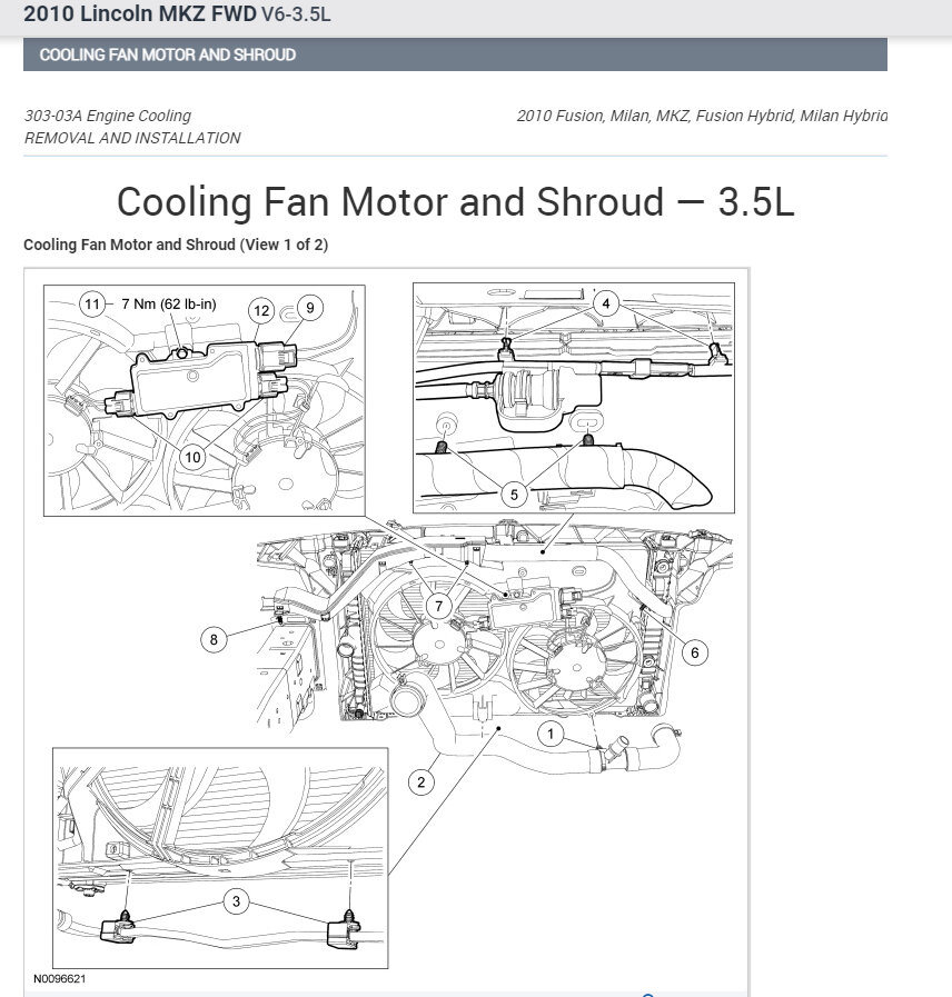

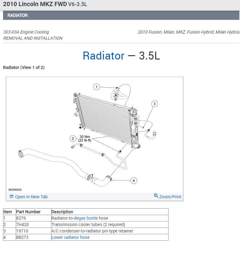

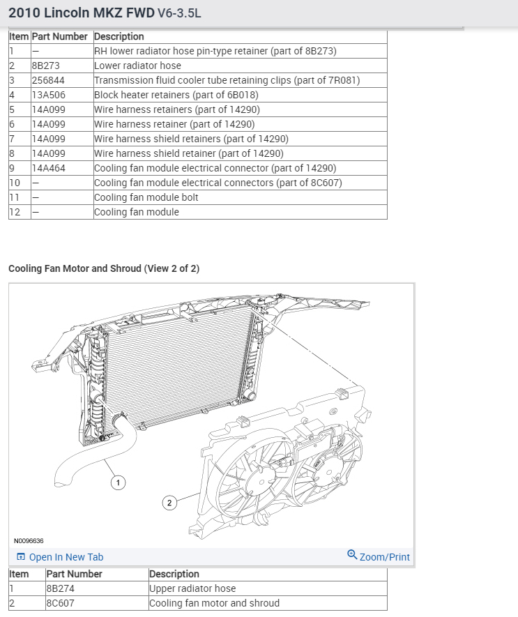

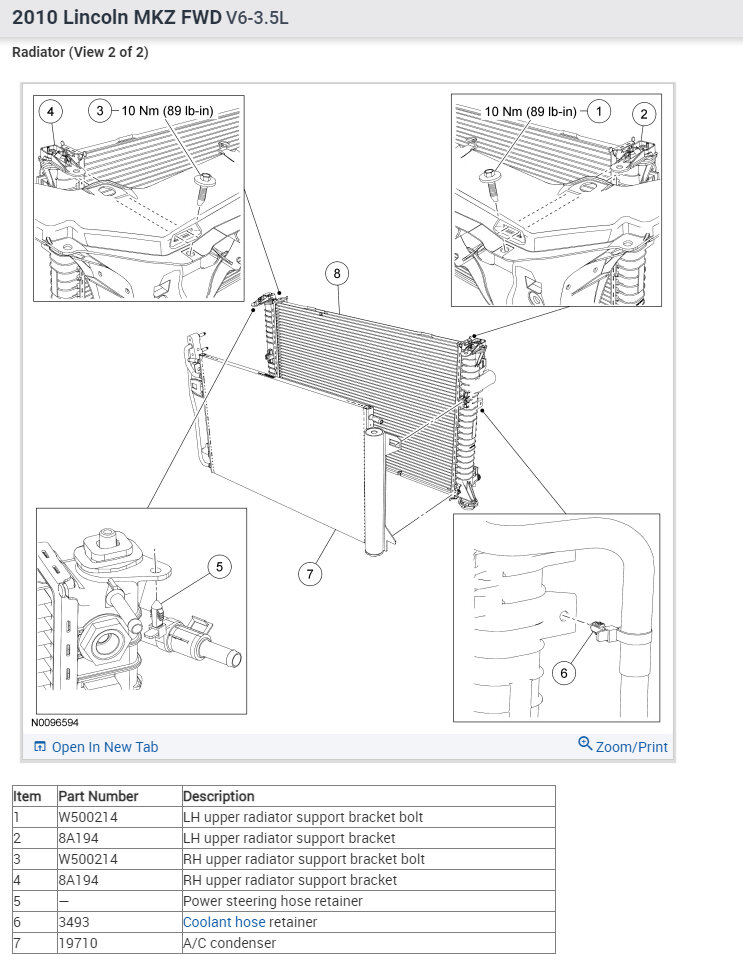

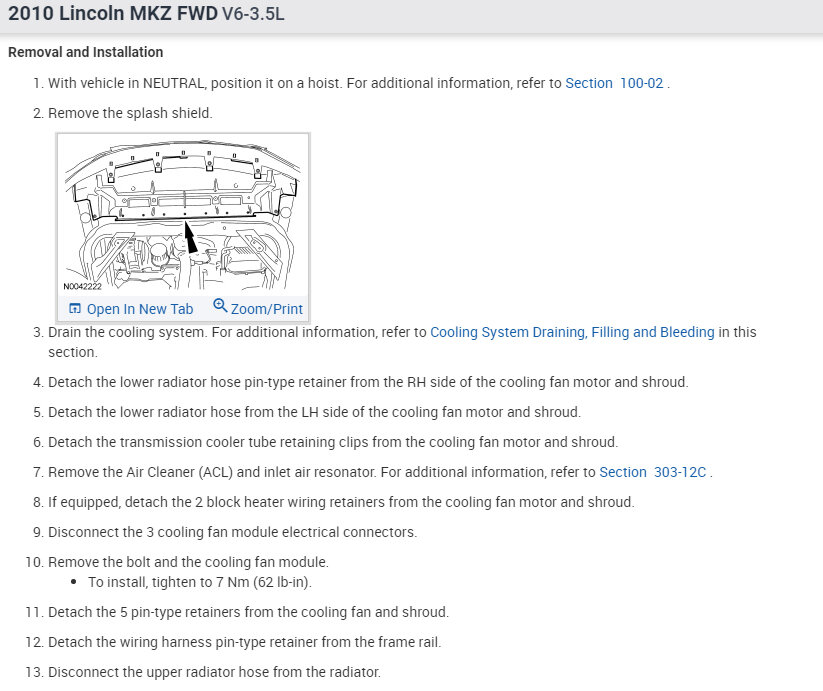

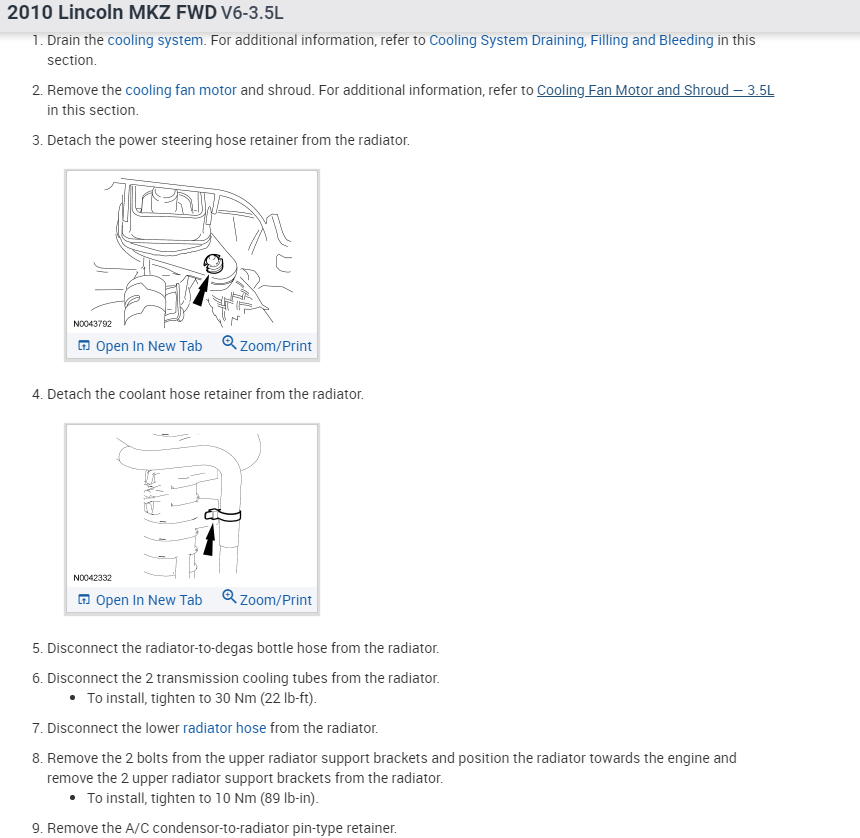

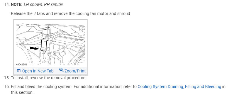

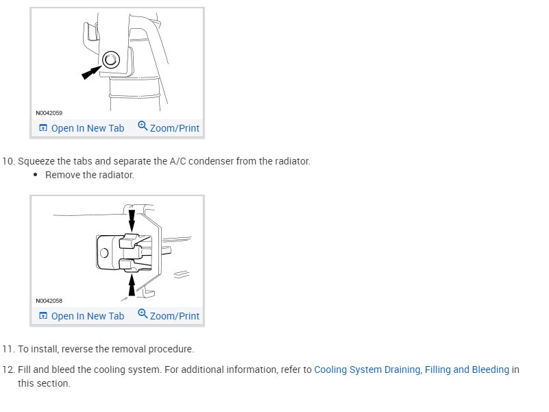

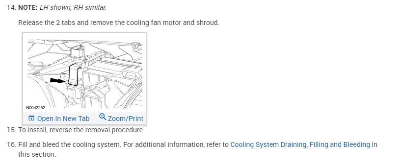

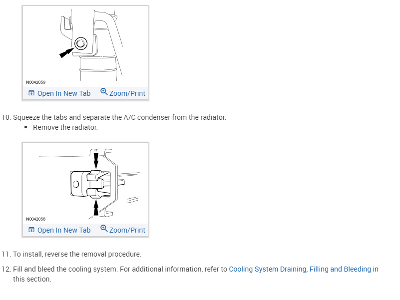

Radiator replacement, how is the cooling fan removed?
2010 LINCOLN MKZ
140,000 MILES • 3.5L • V6 • 2WD • AUTOMATIC
FRED_CENTRELLA
I'm attempting to replace the radiator in the car listed above.
Nov 21, 2022 at 12:13 PM
SQM
  • 6,383 POSTS
See attached for the radiator and the cooling fan replacement procedure.
Let me know of any questions.
https://www.2carpros.com/articles/how-to-replace-a-car-radiator
https://www.2carpros.com/articles/replace-electric-fan-motor
