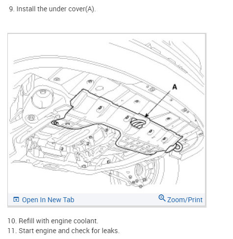

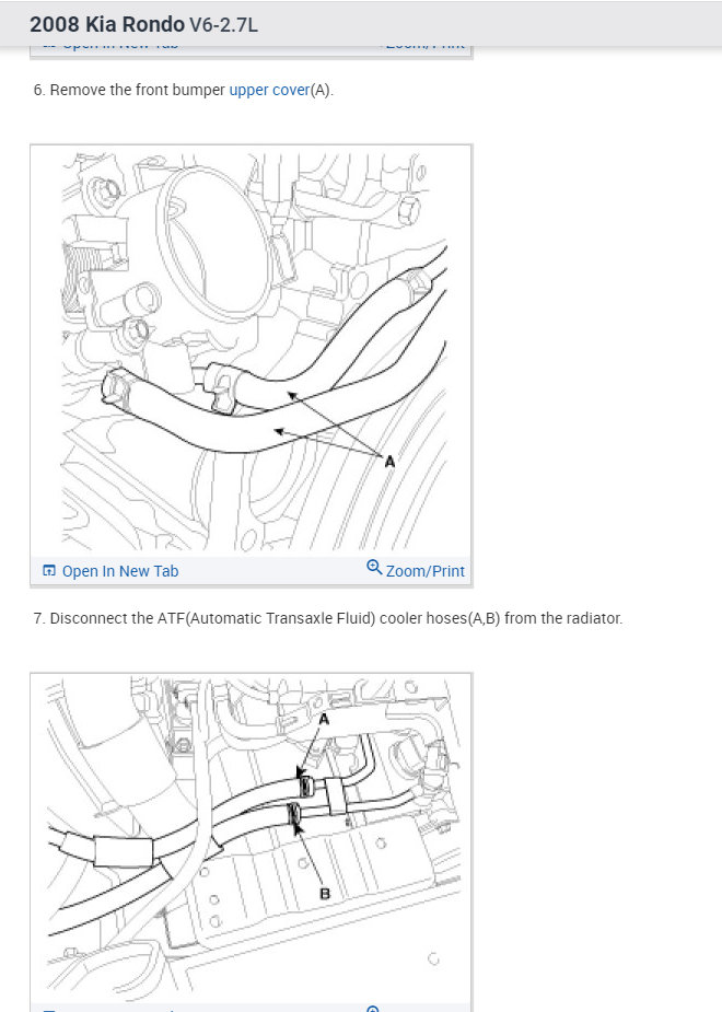

I have a leaky radiator and I am replacing it. What vehicles will the radiator interchange with? like what other cars can I get the radiator off and use on the car listed above. thank you
Aug 5, 2022 at 6:37 PM
SQM
  • 6,383 POSTS

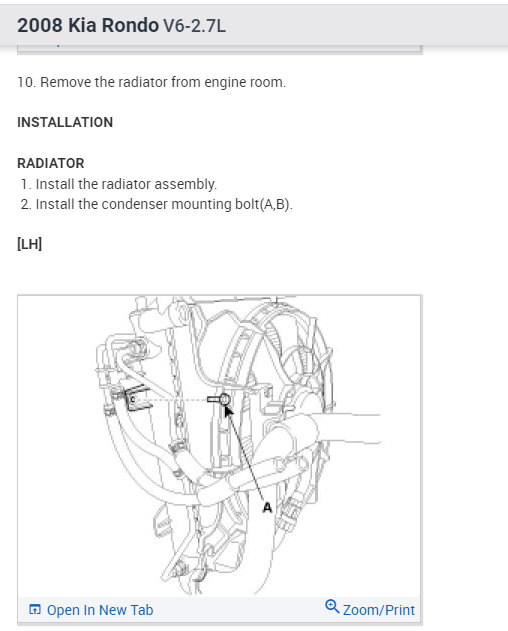

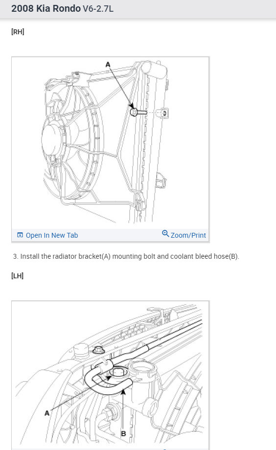

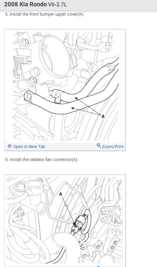

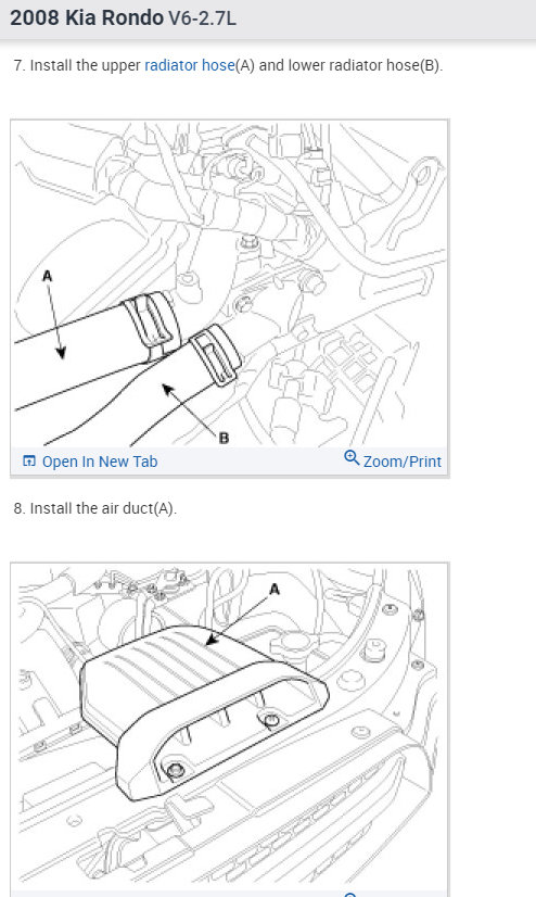

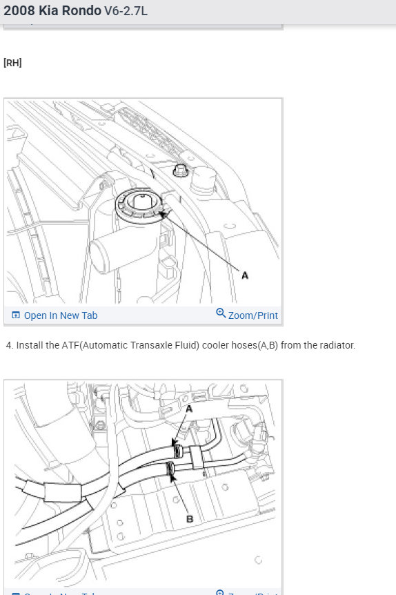

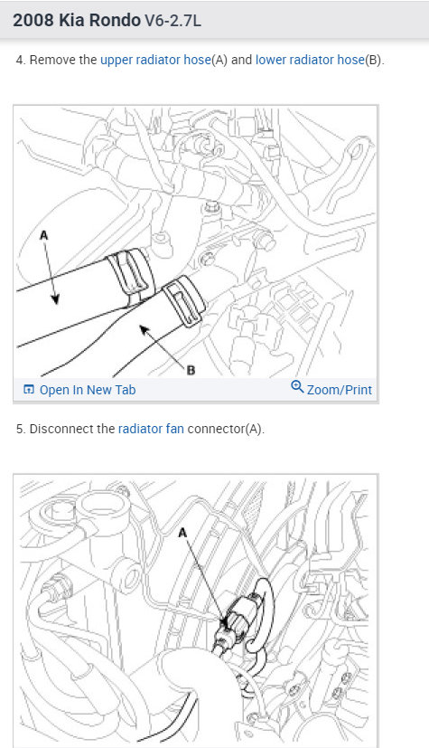

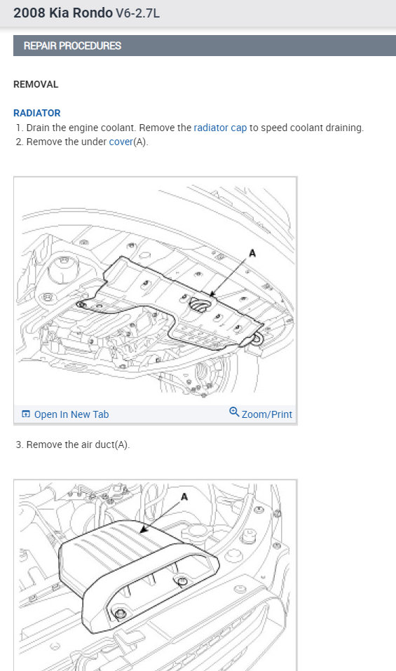

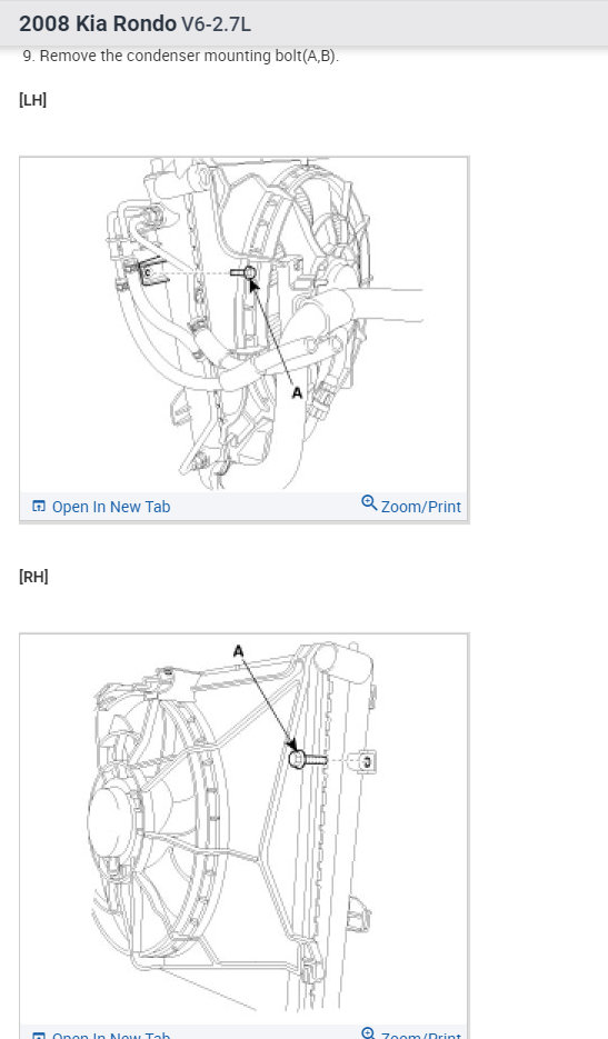

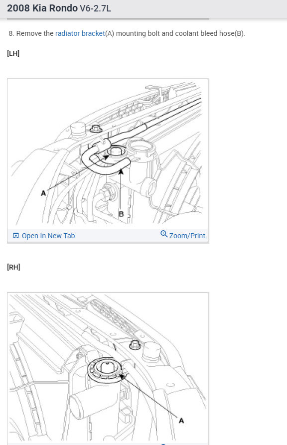

These vehicles use the same radiator from 2007 - 2012 model years. So, a radiator out of these year Rondos will fit yours.
The OEM part number is 253101D120.
https://www.2carpros.com/articles/how-to-replace-a-car-radiator
I have attached the replacement procedure below for your reference.
Let me know of any questions.
