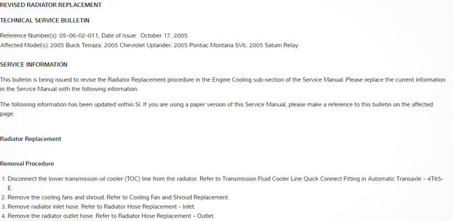

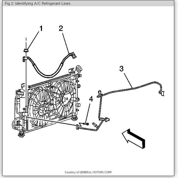

Help! Okay, first time ever working on my own to fix a vehicle issue! so I got the old radiator out but when I took out the bolts I also removed the cooling fans/shroud. Now i can't seem to get them to go back in. What are the steps i need to take to install my new radiator and the fans properly? Pictures would be super helpful in addition to printed step by step.

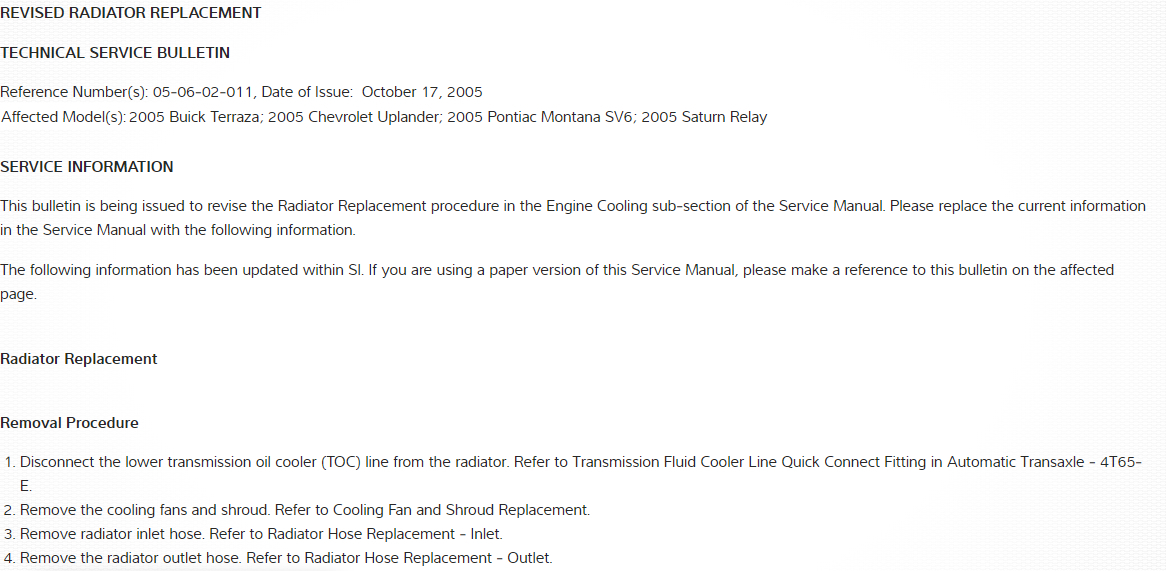

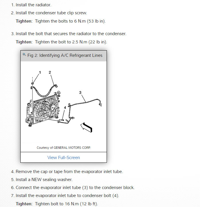

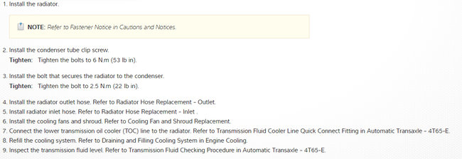

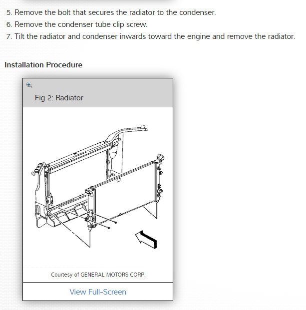

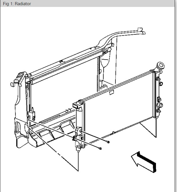

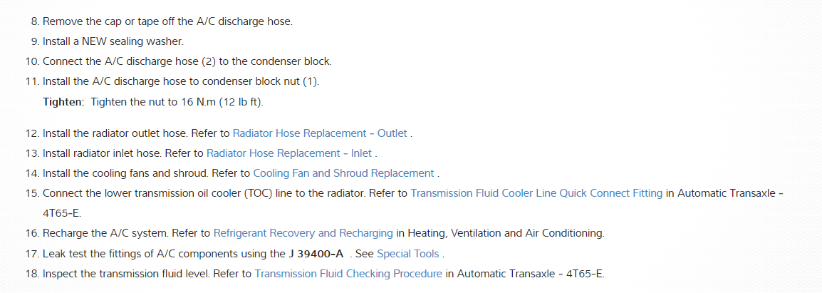

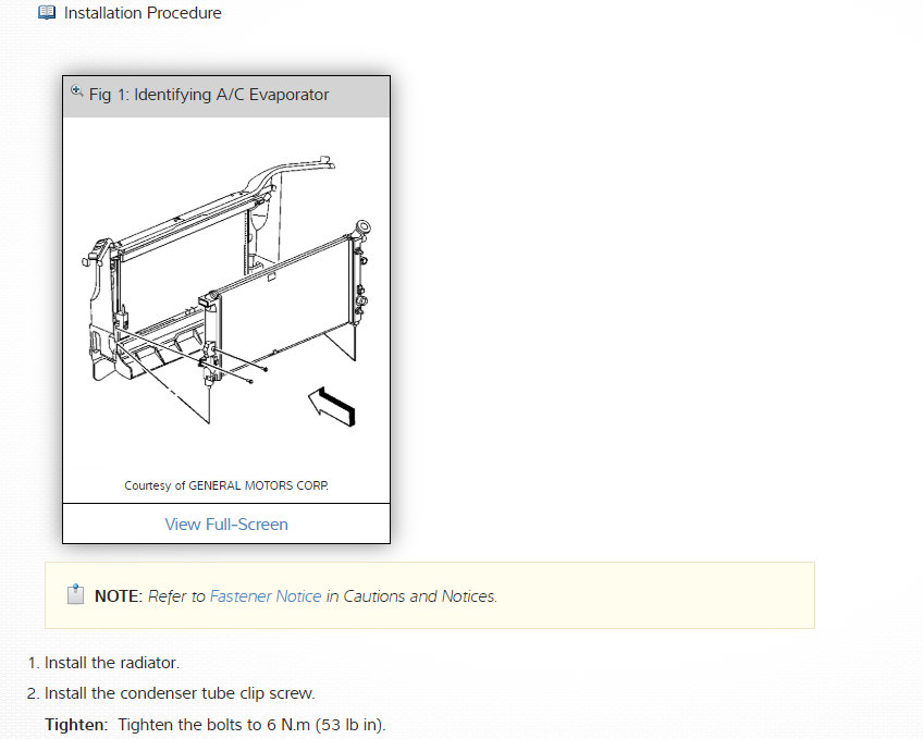

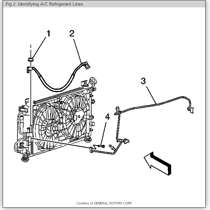

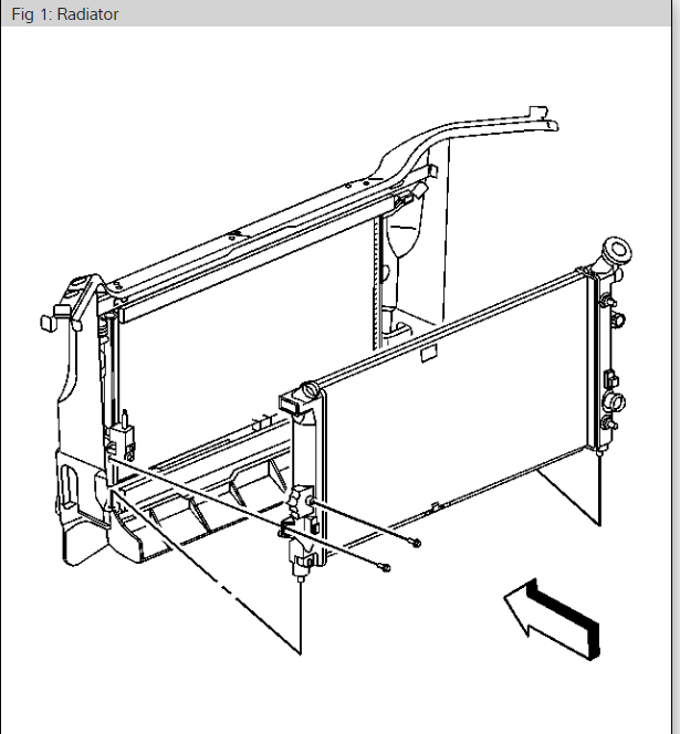

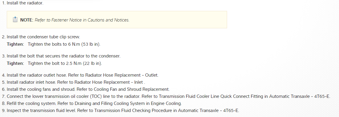

Here are some diagrams and instructions on radiator and fan installation.I hope this will help you out if you need anything else don't hesitate to contact us.
Please let me know how it goes.

This guide can help walk you through the steps of the repair as well:
https://www.2carpros.com/articles/how-to-replace-a-car-radiator
