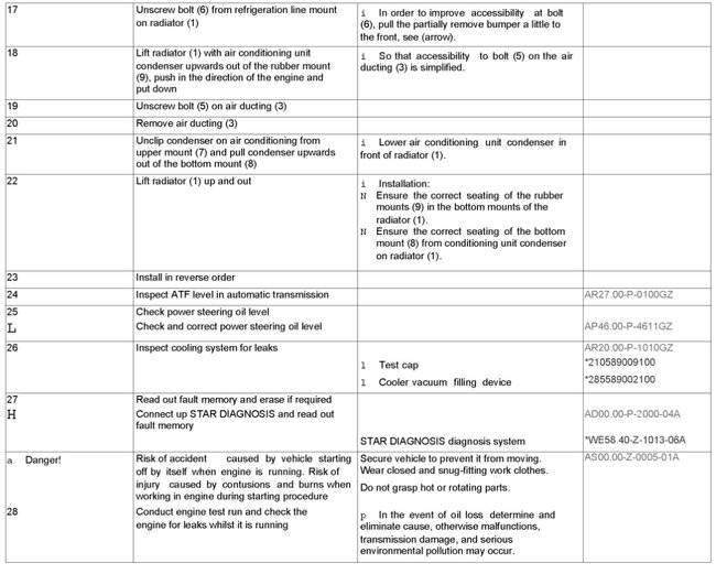

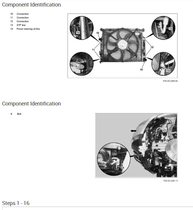

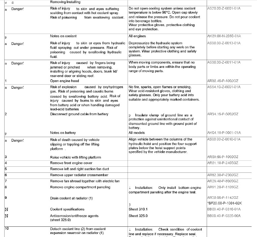

recently attempted to change the radiator, I've got far as trying to pull the radiator out of the bottom connected to the frame. i don't know what is still connected, not allowing for it not to come out. Even if i pull the bumper off there is a plastic type of shroud connected to the condenser not allowing me access to the condenser lines. even if the bumper is removed there is a secondary bumper on the inside. please provide a video. the video from 2carpros only is for 1999 to 2005 Mercedes ml 500.
Nov 19, 2024 at 1:33 PM
  • CAR REPAIR CONTRIBUTOR
  • 54,354 POSTS

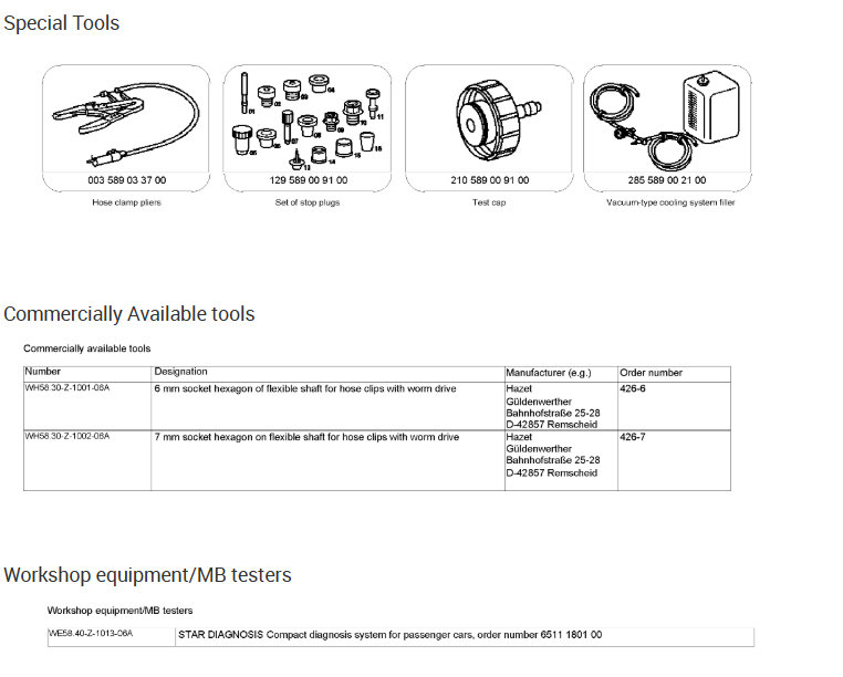

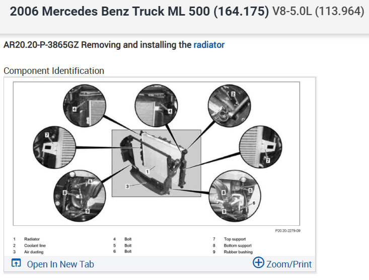

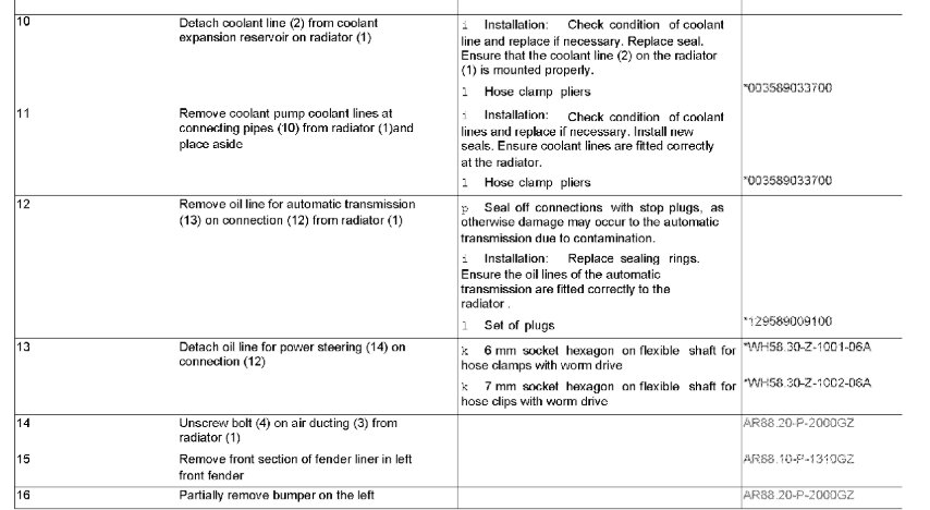

Yes, these can be tough. Fortunately, we did this job in the shop not too long ago and recorded it. This is the video for you to watch:
https://www.youtube.com/watch?v=NRlr9sg3rr8
The job is similar for the 2006 but there are subtle differences. Here are the instructions for the 2006 model. Check out the images (below). Please let us know what happens.

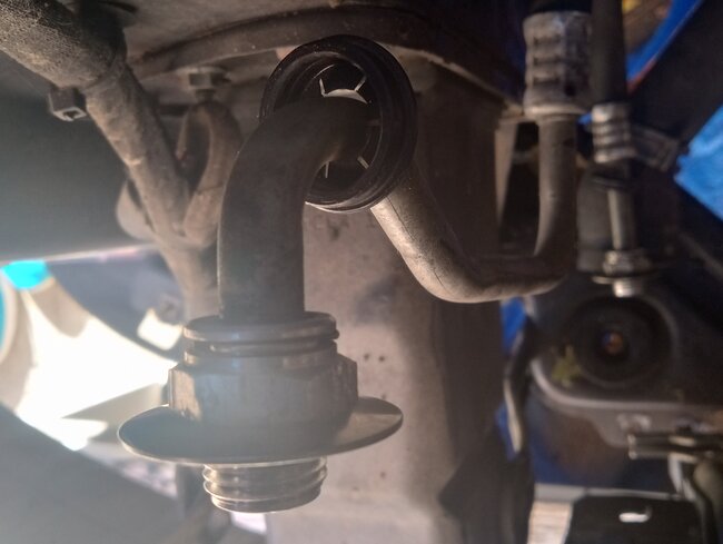

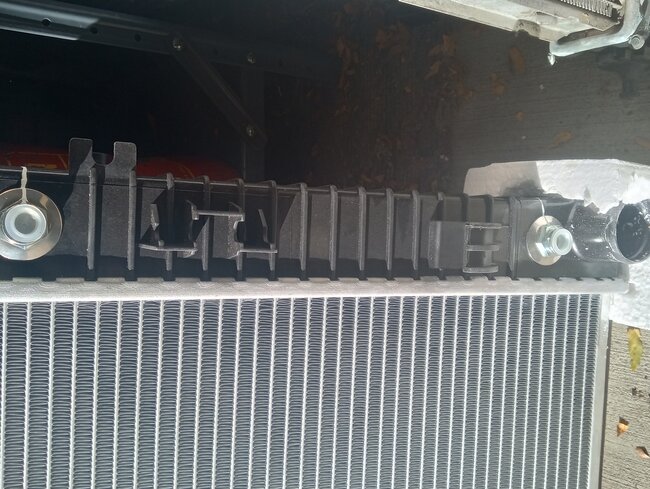

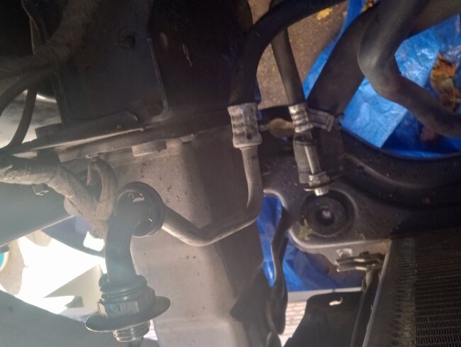

how do i remove the rivnuts from the old radiator the new i have doesn't have them How do i reattach the ATF Lines? I unscrewed him from the old radiator. the new radiator already has. the nuts attached to it, but the old lines I can't remove the nuts off of there to insert it into the new radiator.
Dec 2, 2024 at 11:30 AM
  • 54,354 POSTS
Can you upload an image of what you are looking at so I can see what you are talking about?
Dec 3, 2024 at 9:20 AM
JAMES BRYANT
  • 9 POSTS
I can't disconnect the line from the nut to be able to put it into a new radiator.
Dec 4, 2024 at 12:14 PM
  • 54,354 POSTS
Thanks for the images they help. You need to remove the retainer clips on the old fittings then they will come off of the line. and then they just push into the new radiator fittings, and you are all set.
