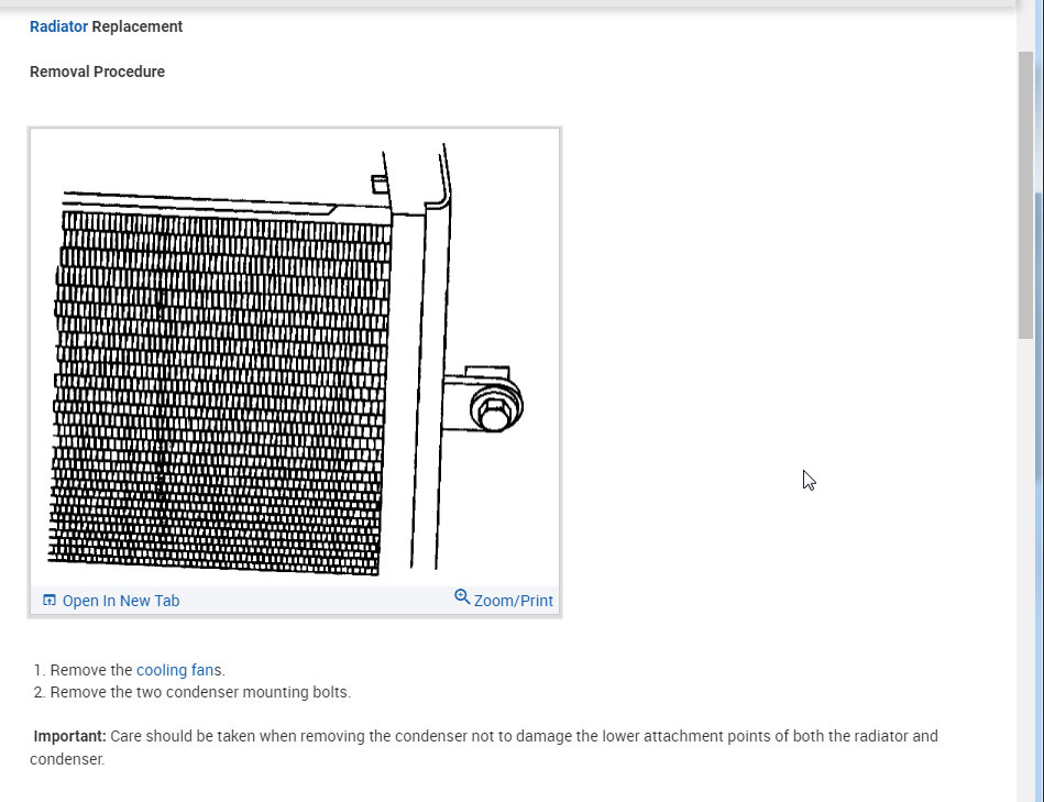

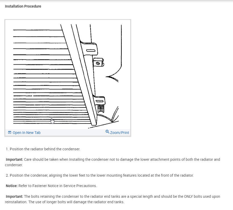

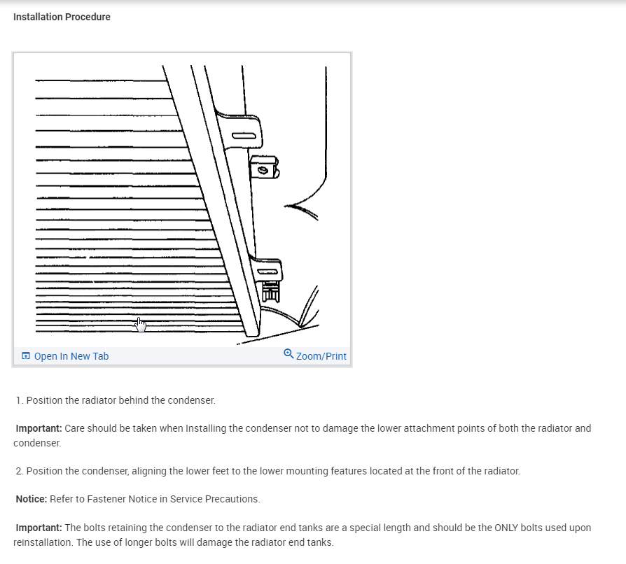

How do I remove a damaged radiator off the car listed above SLS model?
Nov 24, 2019 at 3:00 AM

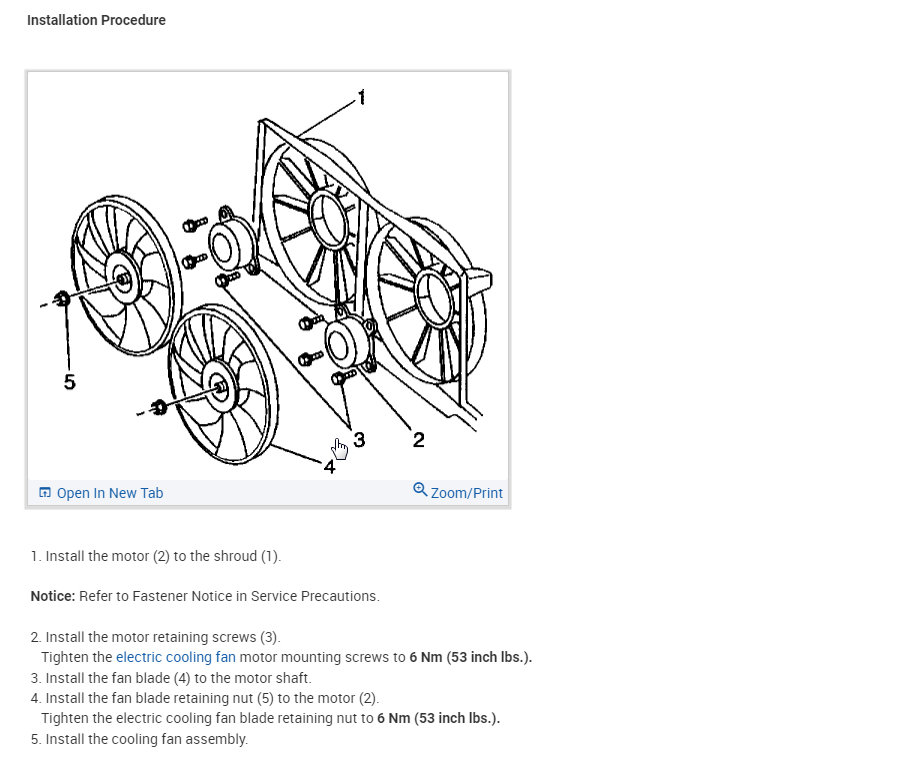

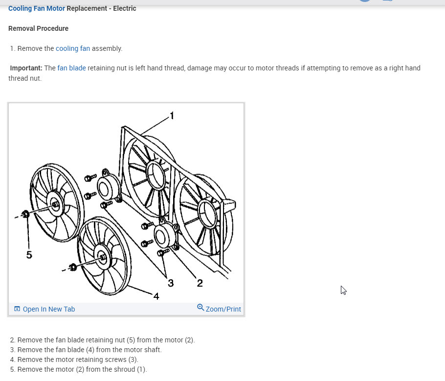

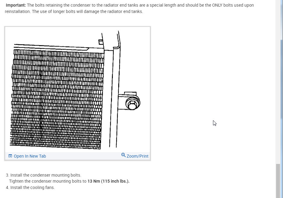

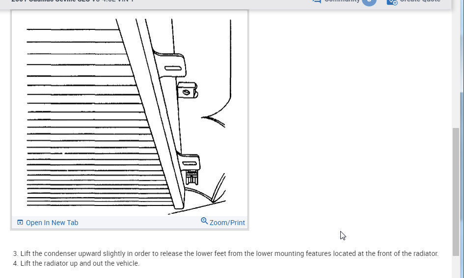

Here is the procedure from the book. Let me know if you need more info. Thanks
Nov 24, 2019 at 9:53 AM
DOUGPARKS567
  • 60 POSTS

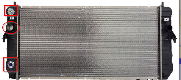

Thanks for reply! but I need to know how I remove radiator also.
Nov 25, 2019 at 5:59 AM
That was the process for the radiator. It says condenser but this is a complete assembly. The condenser is on the radiator. You should see the AC lines attached to the side along with the cooling lines. I circled the coolant inlet and put a square around where your AC lines should be.
