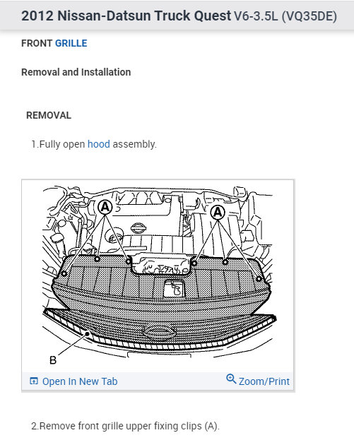

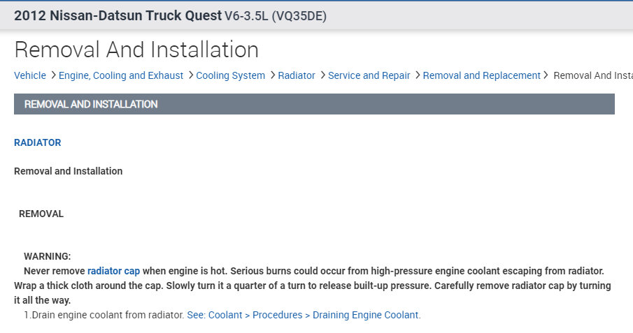

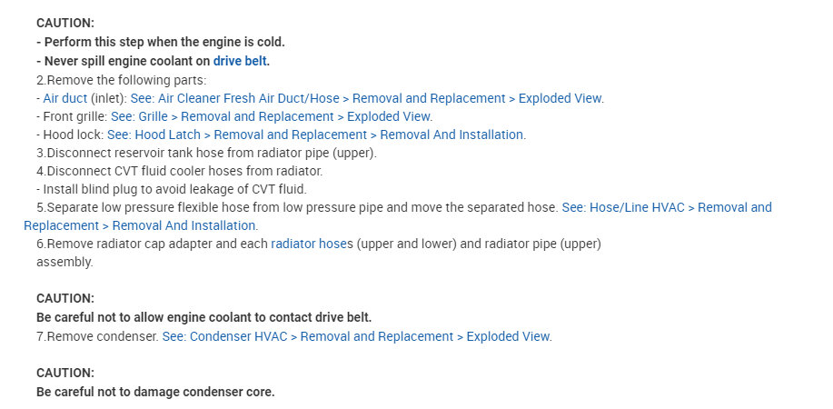

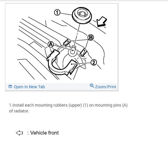

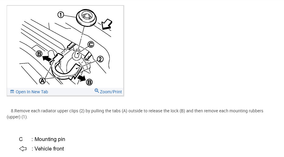

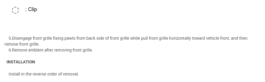

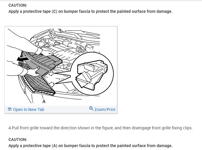

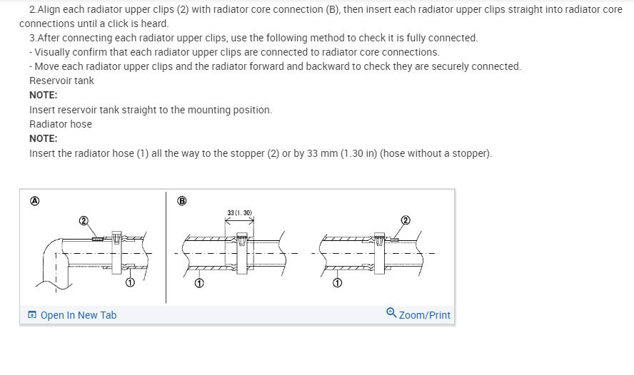

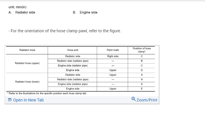

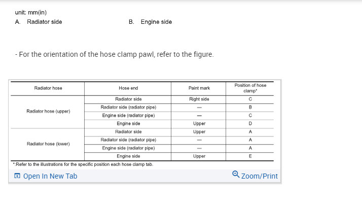

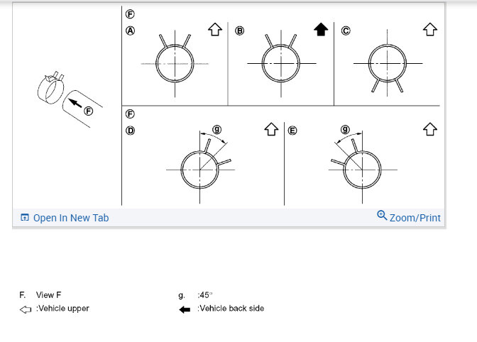

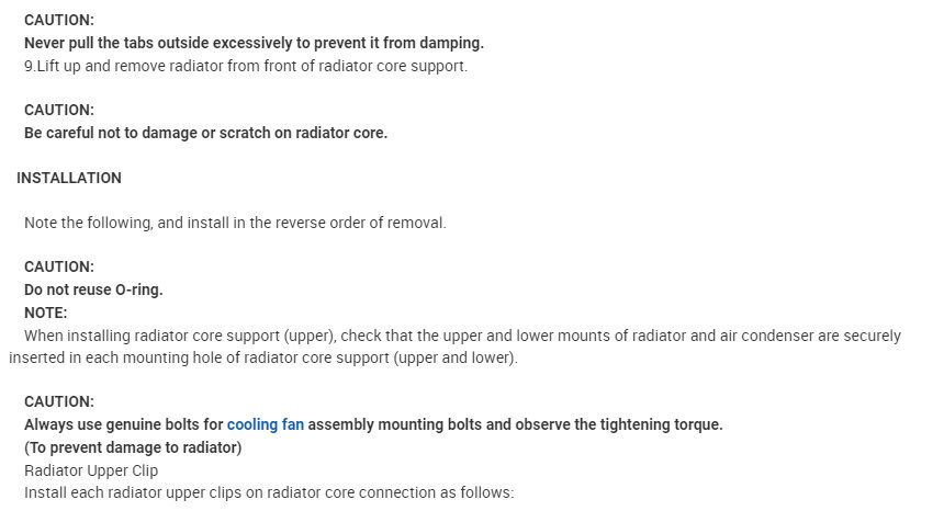

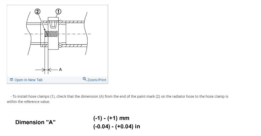

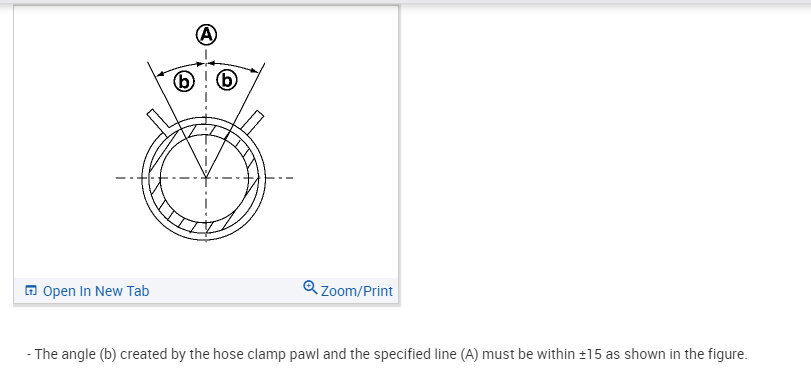

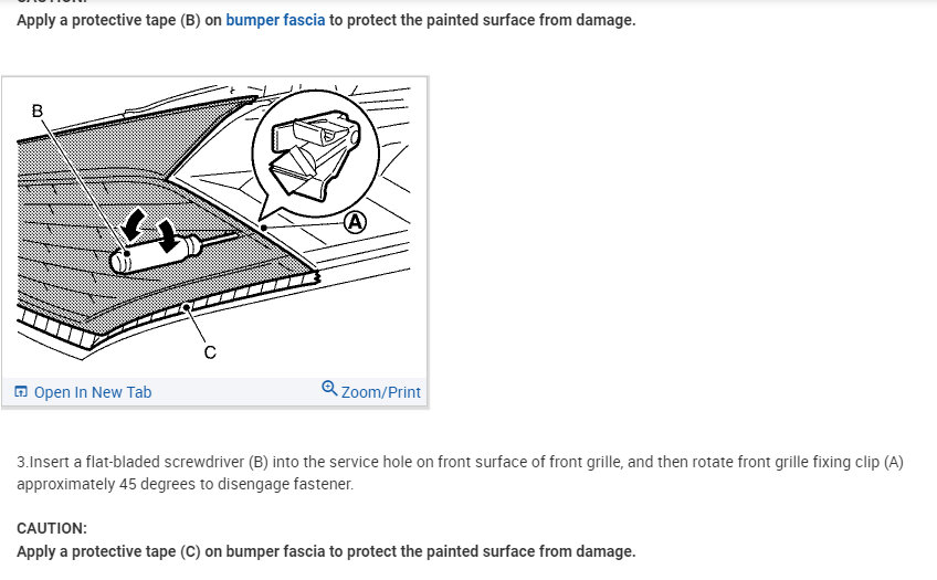

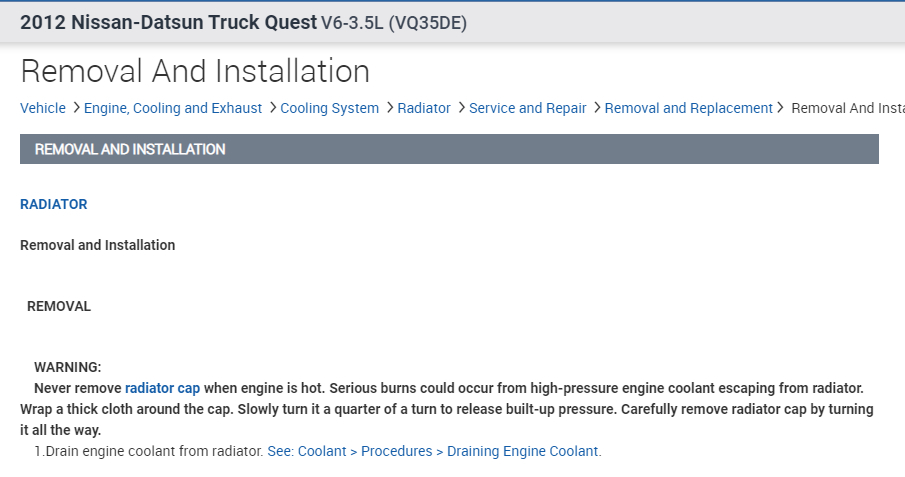

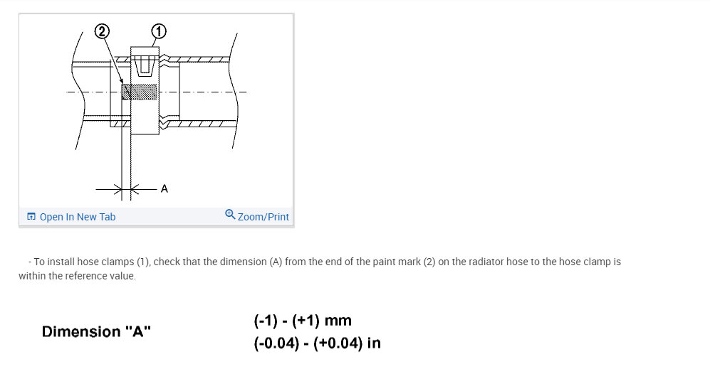

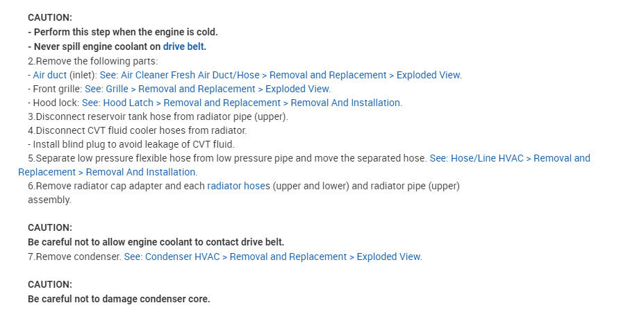

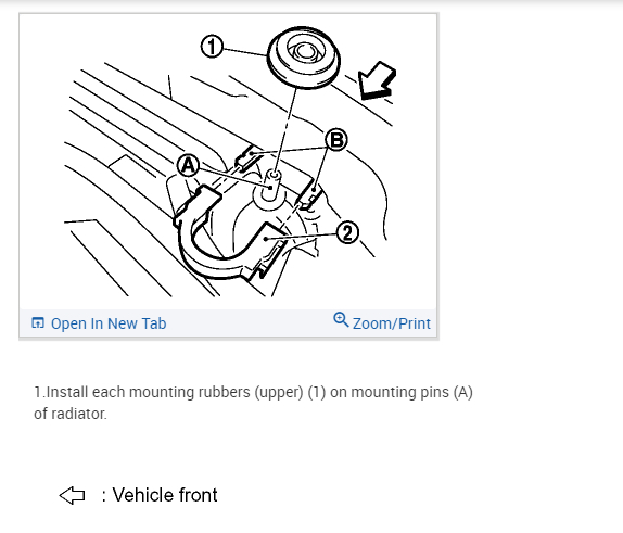

Just need to know how to remove radiator, I don’t know if the bumper needs to be removed.
Nov 30, 2022 at 8:33 AM
Experienced Mechanic
110,248 POSTS
The bumper doesn't need to be removed, but the front grille will along with other components.
I attached the directions below for the removal and installation of the radiator. Take a look through them and let me know if you have questions.
Take care and let me know if I can help.

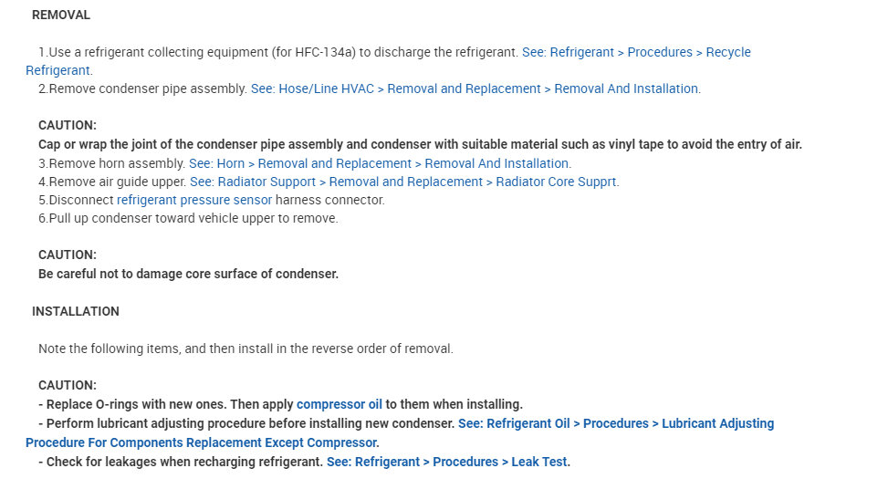

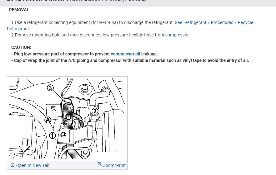

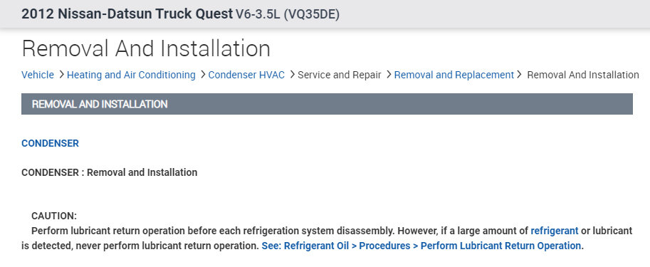

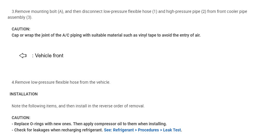

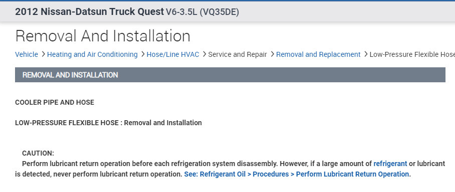

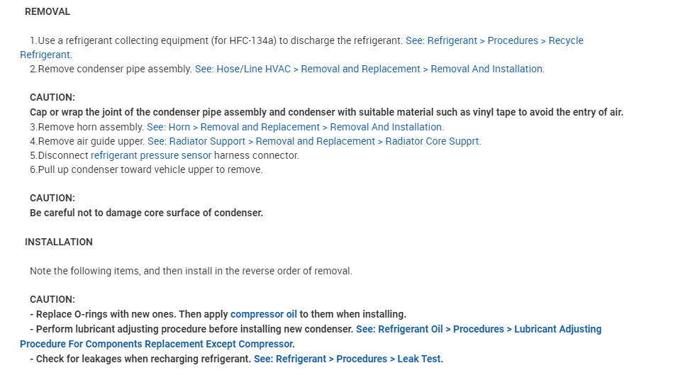

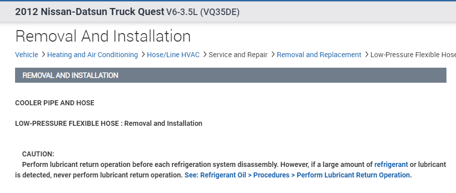

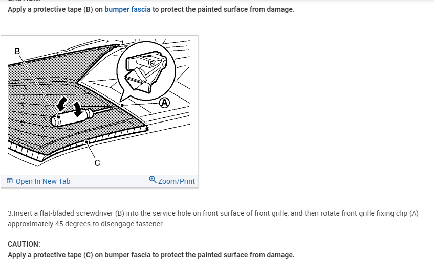

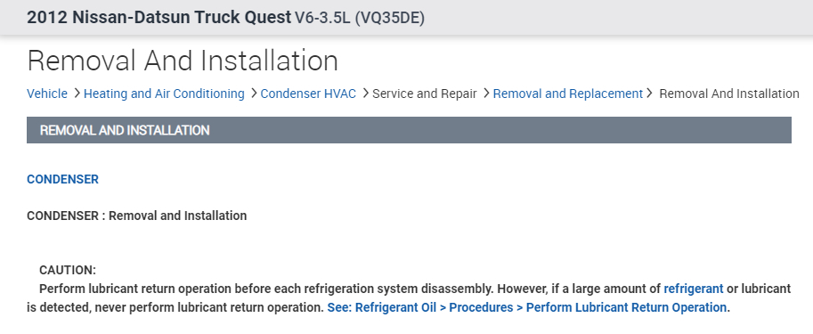

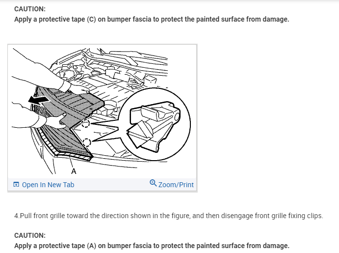

Hi this is Tommy Pepsi, I don’t see the front grille how to remove and the low-pressure flexible hose and the A/C condenser removal.
Nov 30, 2022 at 8:02 PM
110,248 POSTS
Hi Tommy,
I attached directions for the individual components below. Please keep in mind, you will need to evacuate the refrigerant from the A/C system.
Let me know if this helps.
