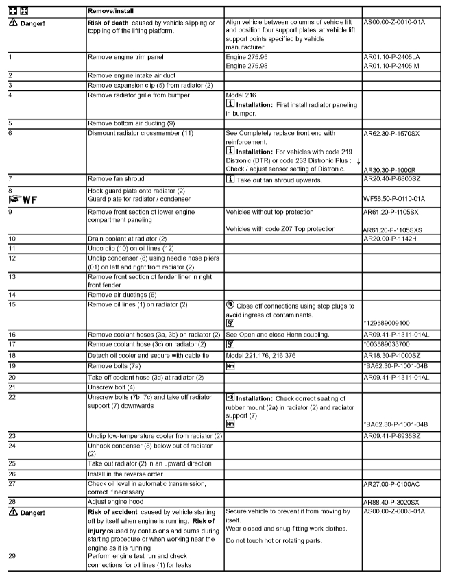

Hi, any tips on removing radiator?
Dec 15, 2021 at 5:44 PM
SQM
Experienced Mechanic
6,383 POSTS

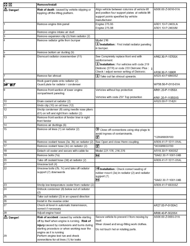

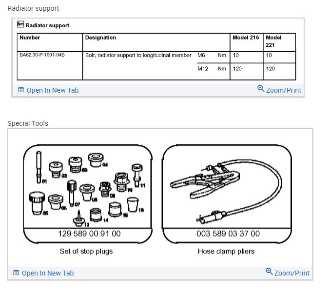

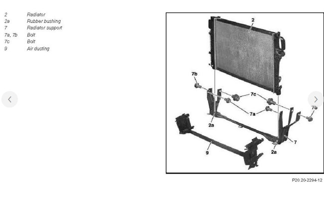

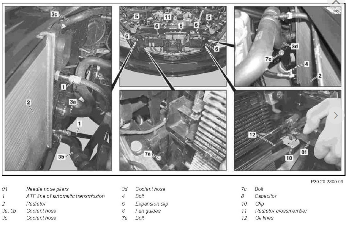

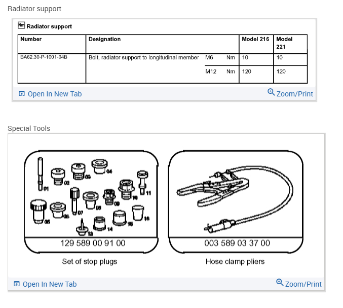

I have attached the radiator replacement procedure below for the S600.
Here are a couple of helpful guides and a video that cover the best practices:
https://www.2carpros.com/articles/how-to-replace-a-car-radiator
https://youtu.be/NRlr9sg3rr8
Images (Click to enlarge)
