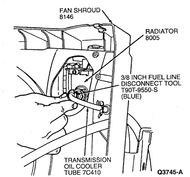

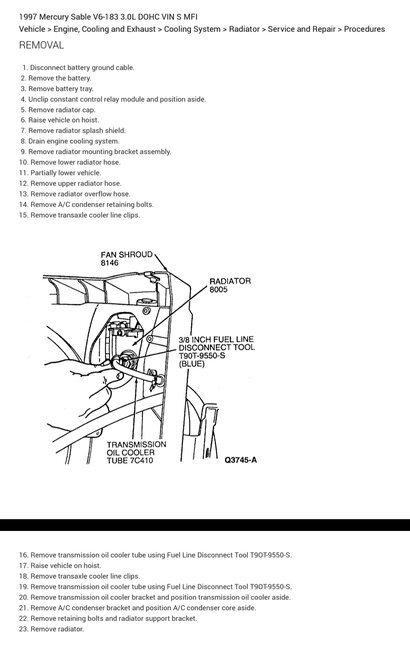

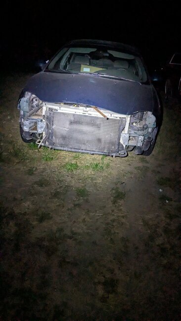

I got into an accident last week and I've been depending on somebody to help me fix my car and it's been taking them all week which I don't have another week to do this. I have this weekend. Could you please instruct me on how exactly I need to remove this radiator. I have help on getting the radiator in but I said I would get the radiator out one of the transmission line bolt is stuck. And I don't know what hoses to take off and not to take off. No matter what videos I look up it's everything but my car.

It should be a 3.0 engine not a 1.9. I have attached the process to remove the radiator for you. If you need further assistance let us know.

Yes you're right 3.0. Thank you so incredibly much! I can't even tell you how grateful I am!
