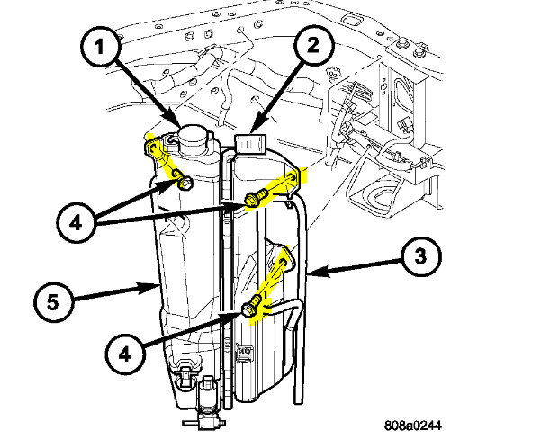

How do I remove the radiator overflow tank?
Sep 13, 2023 at 3:38 AM
  • 110,244 POSTS
The reservoir tank is held by three bolts. To separate the tank from the body of the vehicle, remove them and then the hoses that are attached.
If you look below, I attached a picture showing the location of the bolts.
Let me know if this helps.
See pic below.
