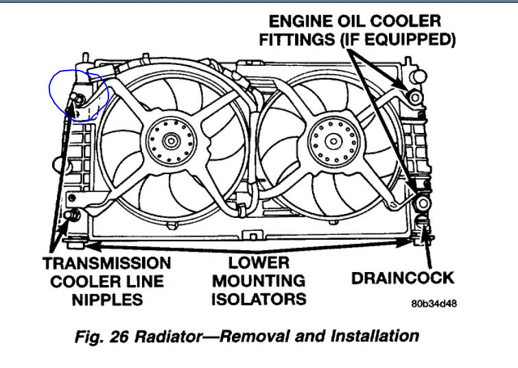

Just curious what that upper passenger side aluminum line is going into the radiator
1999 CHRYSLER 300M
165,000 MILES • 3.5L • V6 • 2WD • AUTOMATIC
SACFOX186
  • 38 POSTS
Upon removing the fans it was in the way and i disconnected it so the fan could come out, but didn't connect it until a day later. Since it's connected ,can i drive my car without trouble. since it's supposed to be a closed system?
Oct 13, 2020 at 2:28 AM
Good afternoon,
That line is for the transmission cooler. I attached a picture for you of the location of the line. You do need to remove that to get the fans out.
https://www.2carpros.com/articles/replace-electric-fan-motor
As far as your question, no, it does not harm leaving it disconnected for a day. You are good to hook it back up and go.
