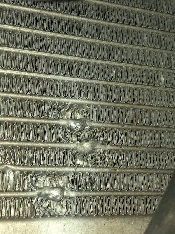

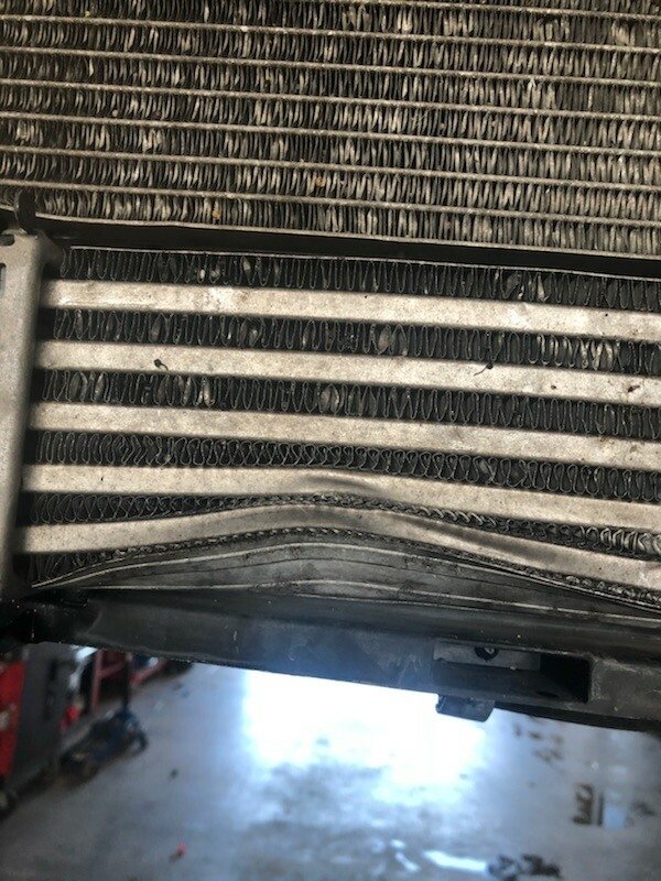

Hi Steve, thank you for replying to my question. I towed the car to another mechanic. He said the inter-cooler was smashed on the inside that faces the engine (no damage to the outside of the car) and there were three leaks in my radiator, not just one. They ended up welding them. Two check engine lights would not turn off. Inter-cooler one and an engine overheating codes come back. I do not know what happened but by the pictures, it looks like the car came down from the lift and landed on something from looking at the pictures. I do not know why I sprung three leaks in the radiator on my four mile drive though. Any ideas?

Could you load the pictures showing the damage on this site? They should not have been near either the radiator or inter-cooler.

I know one of the codes was 2885. He said the other was 2f1a but I do not think that one is accurate. He said that the code was saying the engine was overheating, he checked the temperature and it was at 185, which he said was not too hot. Here are the images of the inter-cooler and radiator welds.

That definitely is not normal. Not sure how that would happen, unless it was lowered onto something and it damaged it.
