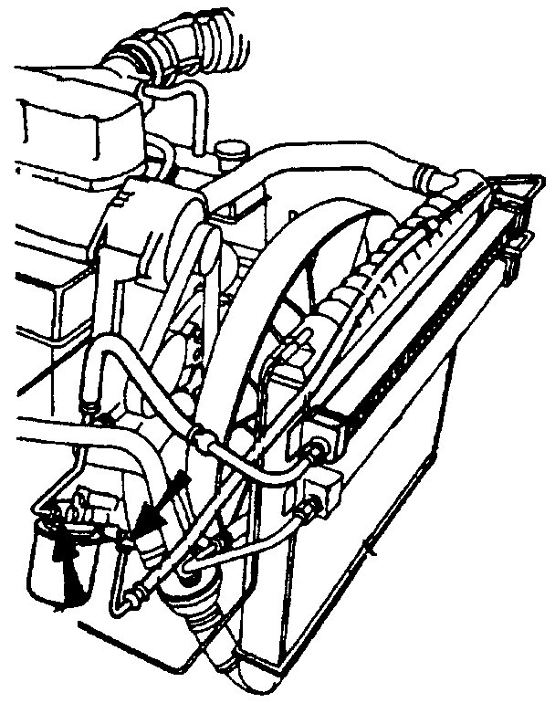

I need to know the name of the hose that looks like it is running from the radiator to the oil filter? It is leaking badly! Thank you

Is it leaking coolant or oil? There is an engine oil cooler, but it does not use coolant. Can you upload a picture of the hose and its location on the vehicle? I cannot tell you for sure if it is a lower radiator hose, heater hose, oil cooler line or what it could be.
If it is leaking oil, it is the oil cooler line. If it is leaking coolant, I have to see it.
I attached a picture of the oil cooler lines. There are two. They are the smaller ones in the picture and there are arrows pointing to where they mount on the oil cooler. Take a look and let me know if that is what is leaking.
