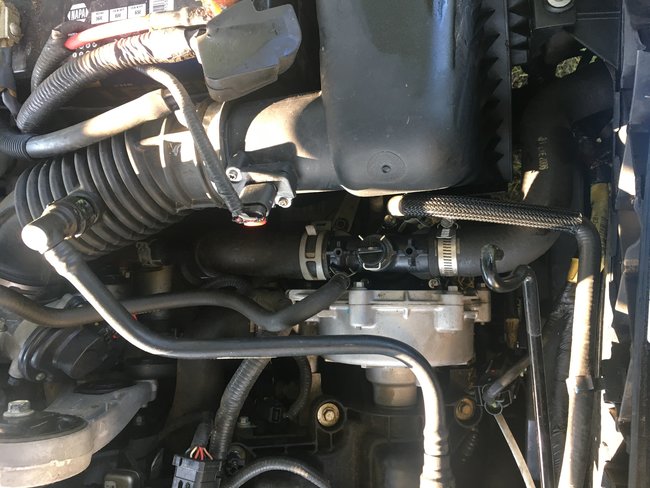

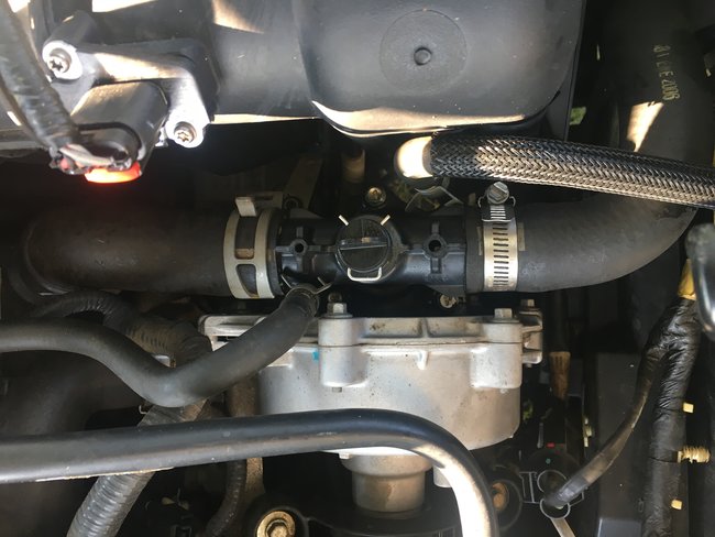

So I hit a deer last night, and drove home afterward. But this morning when I started my car it starting smoking a white smoke and the engine was overheating. I think it is a radiator related issue, but I am not exactly sure which part needs to be repaired/replaced. I think it has something to do with the two broken spouts but I am not an expert so I could not be one hundred percent sure.
Monday, July 17th, 2017 AT 4:41 PM

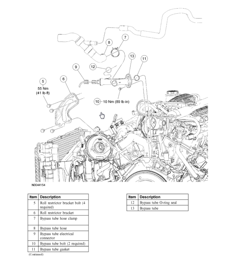

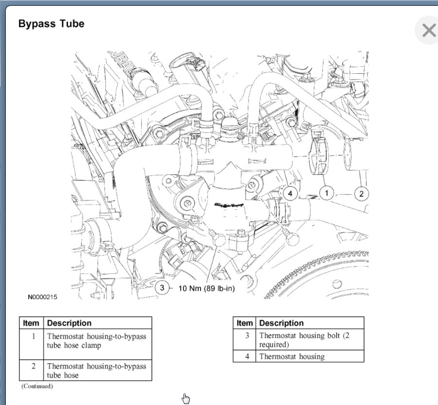

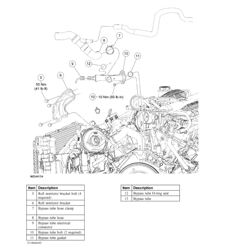

Yes. That is the thermostat bypass tube. Clearly those lines need to be attached to the housing.

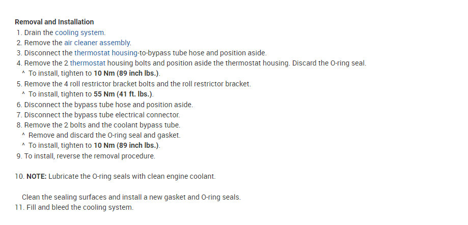

So you will need to replace that plastic part. I attached the process below that we need to follow in order to replace this.
